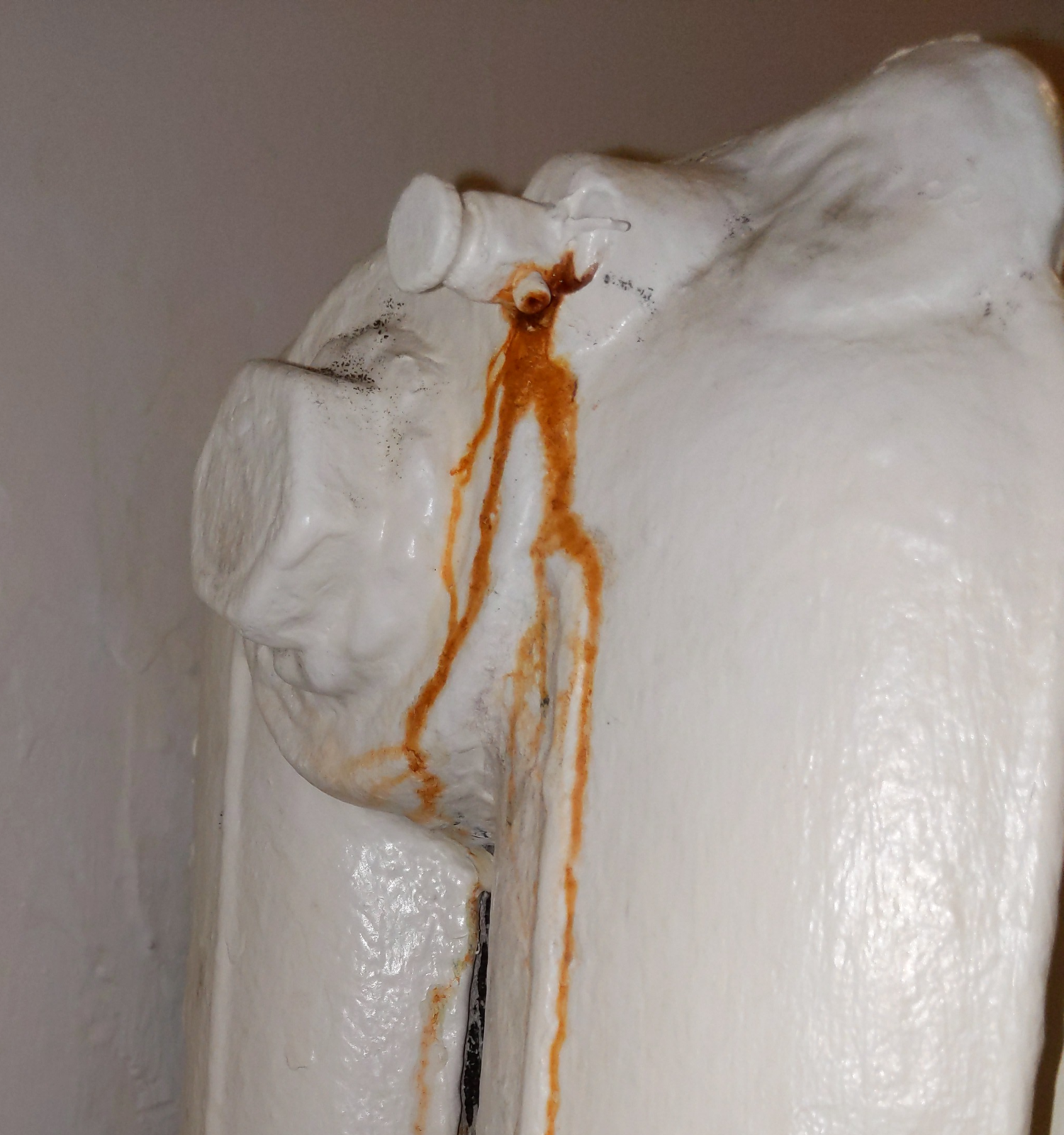

    A picture is worth a thousand words:
    Here is my thousand words:
    • I have lived in a multi unit rental building for a number of years
    • I was painting one of the rooms slowly over the course of the past couple months.
    • I painted the radiator a month or so ago (for anyone worried about the plain latex paint and ****ty job.. I was going over several existing coats done by past tenants; I didn't ruin anything that was nice)
    • Then I covered it up while I did other stuff in the room
    • Today was *finally* the day to finish up and as I untaped the plastic sheet from the wood floor I saw this water damage under the radiator. The water couldn't evaporate due to the plastic sheet.
    • Then I took the sheet off the rad and the source is pretty obvious!
    • I've used a straw to kind of direct the water into a bucket but it's really coming out fast. There's about 400mL in a little over an hour.
    • It was not like this before as I would have noticed it at some point especially while cleaning, priming, painting.
    Questions:
    • Somehow my painting it has caused this??
      • How could painting have caused this leak?
      • This thing is in a corner and there is a wall a few inches away so I don't think I could have bumped it with a tool or anything.
      • Could I have broken it while washing? If I did that, would it be reasonable to say it was already busted?
      • I find all the rusty water coming out to be pretty suspect. But is it normal?
    • I am afraid my landlord will blame me for this as he hates spending money and gets real mad anytime anything is required. So I would like to know going in what's has transpired
      • By the way I am not looking for legal or communication advice or to be told I should move.
    • What is *supposed* to be here? I looked at the other rads in the unit and they all have different components. Is there meant to be a cap on this pipe or is something snapped off or what? I can't find any pictures online that look like the right configuration.
    • What's a likely (short/long term) solution to this?
    • If I could manage to turn that little knob can I close it? I definitely don't want the whole thing to break off by accident. Like if it's all rusty. I do not understand the anatomy of radiators.

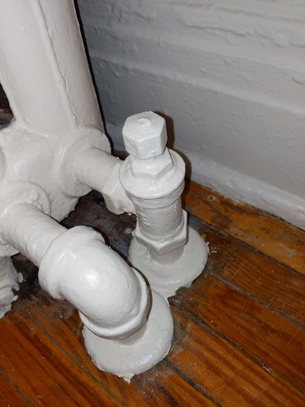

    • The knob that's supposed to be at the bottom to let you turn off the water coming in is gone. Looks like it was sawn off flush with the large hex nut.
    I searched the web (which led me here) and the forum, and looked through the FAQs but I haven't found anyone who has this issue.

    How about a photo of the bottom valves? - just to confirm you can’t turn it off. I would say it’s broken and will likely need a new radiator. As for painting it - I wouldn’t know if that has caused it to leak.

    wow that is so wasteful! I hope nowadays things are designed so they can be fixed.
    what do you think?
    thanks!

    It looks like an air vent so it could most probably be removed and retaped, is it a communal system ? as you cant turn the rad off it means either freezing it or a drain down, its nothing you have done.

    FFS its only an air vent.
    Bung in vent and f/e and new 1/8 or 1/4 vent.
    It looks very similar to the cheap and nasty auto vents.

    You have an old thumb wheel bleed vent there. It should never have been painted over by any of the tenants. Is the water coming out of the little spout, if so it may just need to thumb wheel tightened but with all the paint on it, it may not turn.
    It will need all that paint chipped off around the thread, ideally using a heat gun or nitromorse (or other paint stripper) and a wire brush and then see if it will turn. If not then it's a new bleed valve but that has it's own issues trying to get the old one out of the cast.
    Again though, this is your landlords problem and if the radiator looked like that before then you adding a layer of paint shouldn't have caused the problem.

    Madrab!!! It worked! oh my gosh thaaaank you. I did not actually even need to address the 90 layers of paint, though maybe I will do so now that I see how it works.
    Calling my landlord and having him pay a guy to come out to fix a problem with such an easy solution might even have been more trouble than if I had broken something.
    I guess maybe I turned it while cleaning. Or it was a bit open already but painted closed, but the paint softened when repainted.
    Anyway thanks so much to everyone who helped me solve this problem caused, it seems, substantially by my fear of plumbing.
