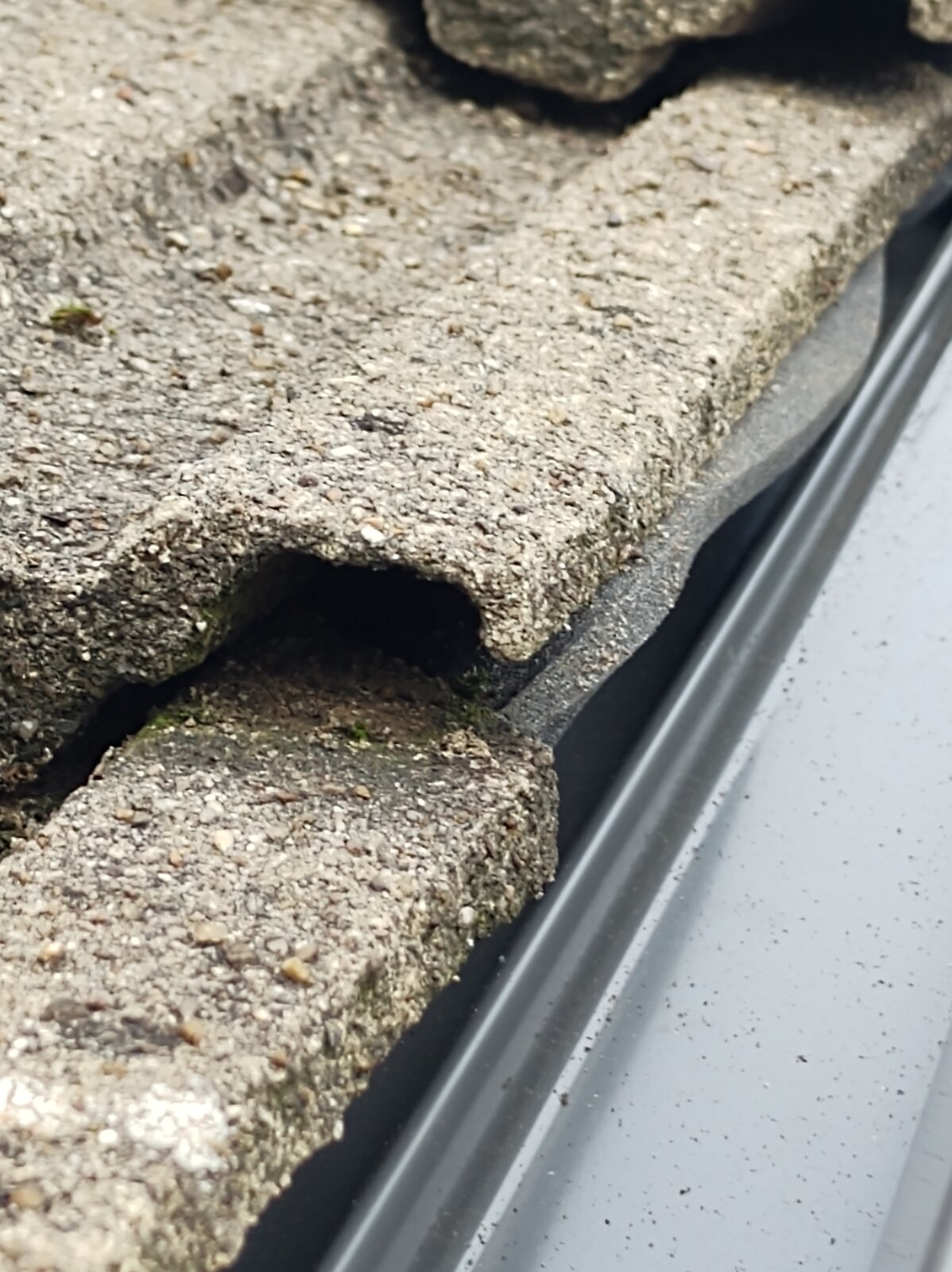

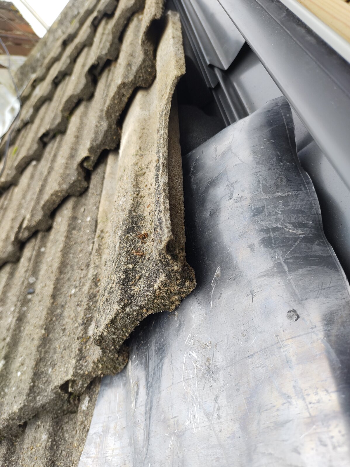

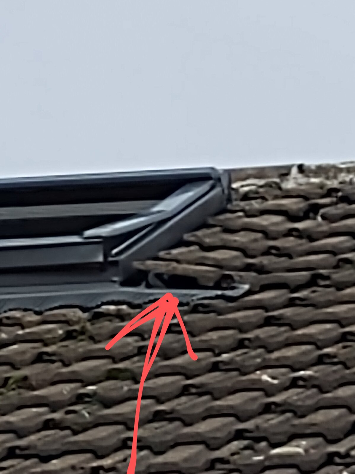

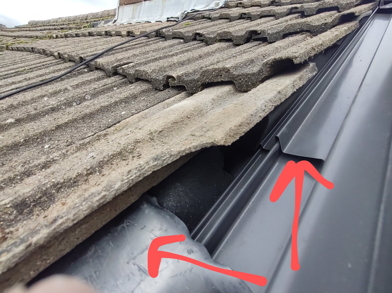

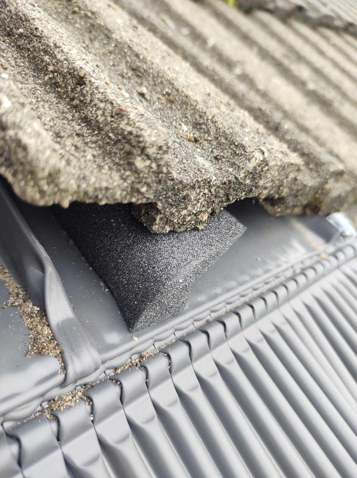

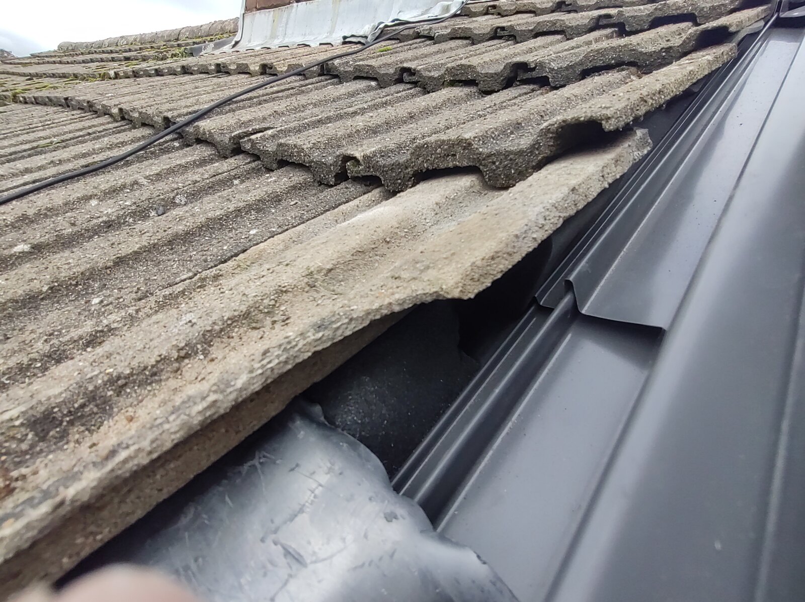

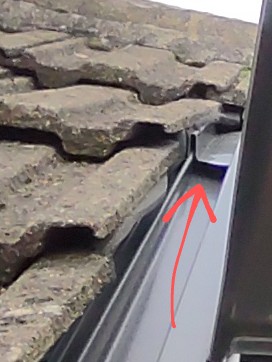

Would any professional or seasoned DIY person say this is a good finished installation....the tiles are loose and the first good gust of wind I'm sure will see them disappear off the roof, foam not trimmed to accommodate the tile profile and a piece of lead waiting to fly off too. Should the flashing parts match up and sit together correctly....
Advice needed.
Advice needed.

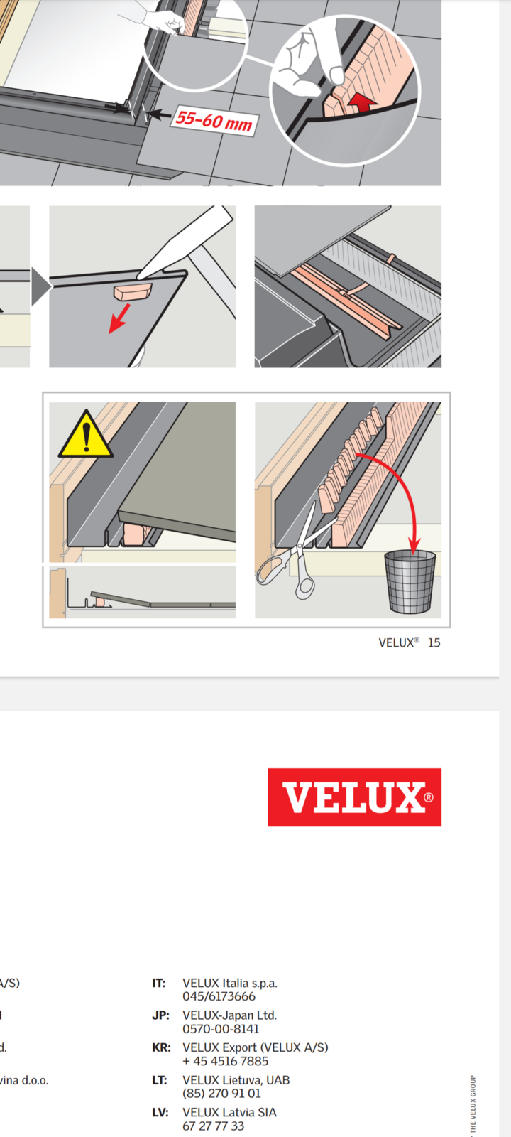

Reputable company with many good reviews, but some poor ones too. The tiles do not confirm in any way to the velux Web site instructions...

That is a pathetic attempt to fit a Velux, had they ever fitted one before, were they straight from (primary) school? I would be wondering what sort of damage they had done, butchering the roof timbers.
It's reassuring from you people, definitely not going crazy. I'm putting the faults right myself as my two parents are in their 80's and do not want the company back in their house. They were also told they need a new roof. As you can imagine the roof is in good condition with no work needed.

It's crap and lazy. Loads to point out. They haven't even bothered to remove the tile support nibs that foul the flashing. Morons.
