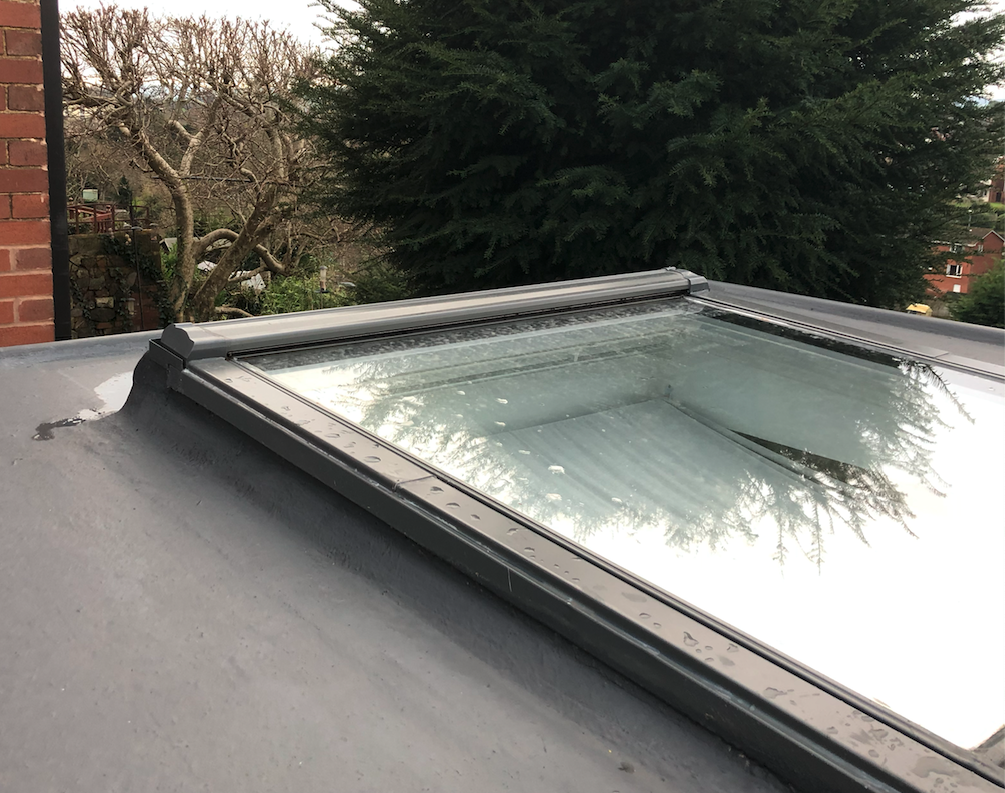

So, we've been having leaks for nearly 18 months on our garden office, which has velux-equivalent windows on a flat roof, when they're meant to be on an angle of 18 degrees (I think?).
While we wait for the builders to come up with a meaningful and final solution, I want to flash-tape the windows to stop rainwater coming in. We only have it dripping intermittently in two places: at the lower end of the windows, basically where the guttering spills. I think the 'flap' is drawing water back underneath and maybe this is where the issue lies.
So, bearing in mind the windows' design, I don't want to stop the water draining down the channels, but I do need to stop it getting into the office!
HAs anyone else had this issue? Any advice? Any parts to NOT flash over?
Many thanks in advance,
George
Any pics? , velux style window is not suitable for a flat roof and should not be anywhere near the gutters.

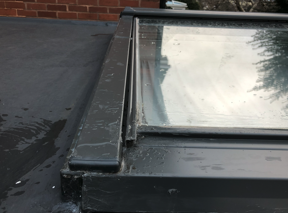

Hi Foxhole. Agreed. This we already know, but we are where we are with it. I want to flash-tape the windows to stop the leak(s), however minor, at the lower end - but I don't want to exacerbate the issue by blocking any channels that drain rainwater to the lower end. You can see my hasty sealant work, which seems to have helped, but the nature of the issue makes it almost impossible to tell how, exactly!
Ultimately, I want to buy time while the installers propose and carry out the proper solution. Where to flash tape, and where not to!
Many thanks in advance for any guidance...
George

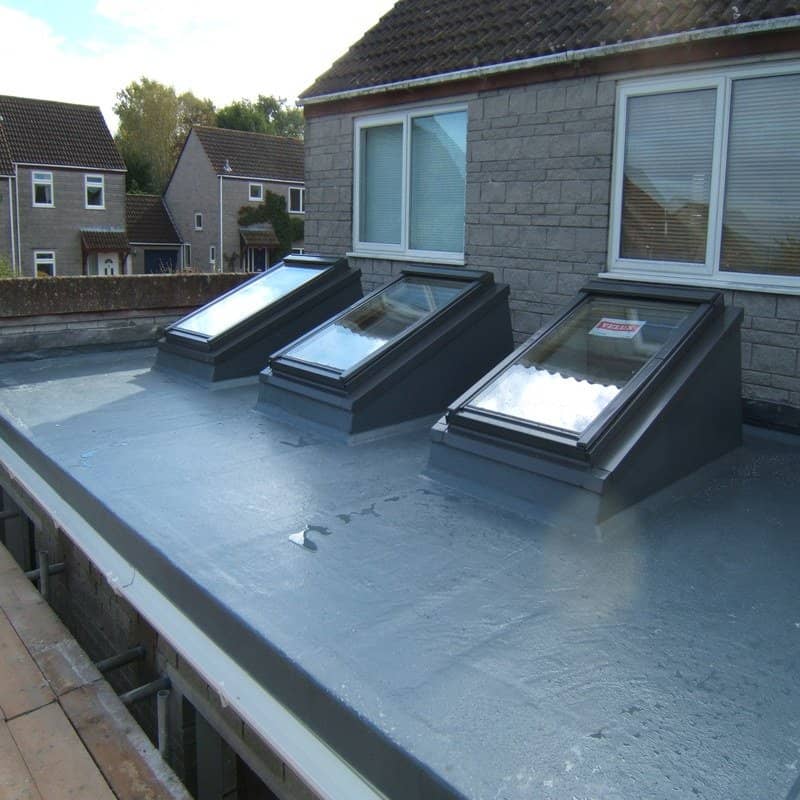

Not sure who is going to pay or who is responsible for the rectification but if it is yourself, you can buy (or make) flat roof kerbs for Velux type windows. It could be a tad Marmite on the look though!

Bodgebuild - We have a hight limit to consider, but we'd probably get away with it. We'll see what the installers think the solution is - they accept responsibility. In the meantime I've flash-taped the lower side of both windows where it seems to be creeping in - but of course it may be running down the channels and tracking in due to the negligible gradient.

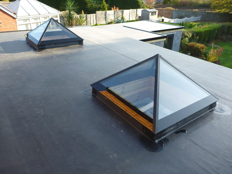

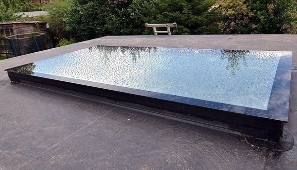

So as Freddie suggests that being the case then you wouldn't mind if they didn't even open so why not try a fixed flat glass roof light like these...
Or a pyramid roof lantern...
Both could I suspect reuse the existing upstand so less upheaval
This is one of our roof lights on a fairly flat piched roof. The upstand is designed for completely flat roofs.
