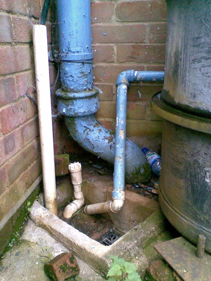

First post, but have been reading it for years to pick up tips! I have a very simple question, but I have no knowledge in this area. Your advice is appreciated.
There is a manhole at the back of the property. Within a 1.5m of it, you have two rain water pipes, a toilet and bath waste going directly in to the manhole.
Do you need any sort of vent pipe on this set up, or will the open drain, and rain pipes suffice?
It's just that I want to replace the 4" asbestos cement rain pipe with a smaller pipe. I'm guessing the large pipe is just from an older rain water system, but wanted to make sure that it wasn't that size for venting reasons.

The blue pipe is your vent pipe and should extend past your soffit. The running outlet from the gutter should not be run to drain unless you live in an area with a combined foul & rainwater sewerage system. Ask your neighbours not the water board as they will make you correct it, if required.

Just to clarify, the toilet runs directly into the man hole via a pipe in the concrete floor.
I have the 1972 plans for the extension and it actually shows the sewage going to a septic tank and the rain water going to a soak away. A letter in 1976 suggest the property was to be connected to the mains sewerage.
It all seems to be going into the man hole now. I will need to do further investigation.

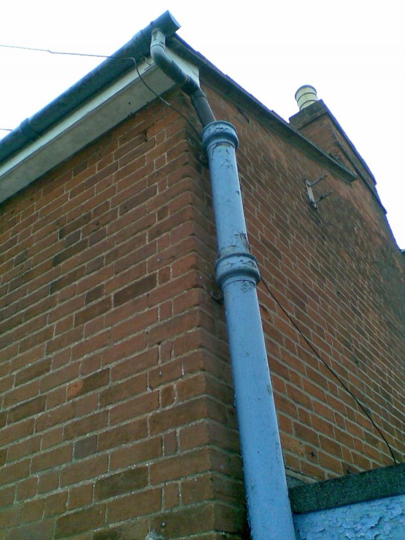

The reason the vent pipe doesn't go past the soffit is..................it probably fell off.

Asbestos soil stack??? i didnt no it was ever made, boiler flues due to the high temperatures, soil stacks, i think not, its a cast iron stack, and will cost you a hell of a lot less to expose of than a asbestos one would
Yes, asbestos stacks were made, also gutters, downpipes and hoppers amongst other items. That could well be asbestos looking at the profile of the collars. Note the use of steel clips, whereas CI has the lugs attached to the collars, formed as the pipe is cast.

Also looks like its rusting, beneath the paint, asbestos wouldnt do that, would it?

Bonded asbestos was used for a variety of things, corrugated roofing sheets, flat panels for garages, even water mains. I think it was the material of choice at the time, probably due to cost. Whole estate near me built in the 60's had asbestos soil, gutters and downpipes, although the majority have replaced the gutters, the soil pipes and hoppers for bath/basin wastes are still the originals.

To the OP, if you want rid of the asbestos pipe, do so, but take sensible precautions when dealing with it. You'll need to retain a vent for the drains, mimimum 82mm pipe to extend above eaves height. Fit a new rainwater downpipe down to the gulley, if the water has been going in there since 1976 I wouldnt worry about it now......

Yes, it's asbestos cement pipe. I've no issue removing it, I'm not about to sand it and down and repaint it!. The wall clips also look a very similar material to the pipe (would that be right?).
I may leave the bottom bend of the pipe or take it out, depending on how firm it is in the concrete.

I'll put in a plastic pipe for the vent and a new down pipe for the guttering. This will probably go into a a large capacity water tank, overflowing into the sewerage system for now. I'll consider a new soak away when I build a patio.
