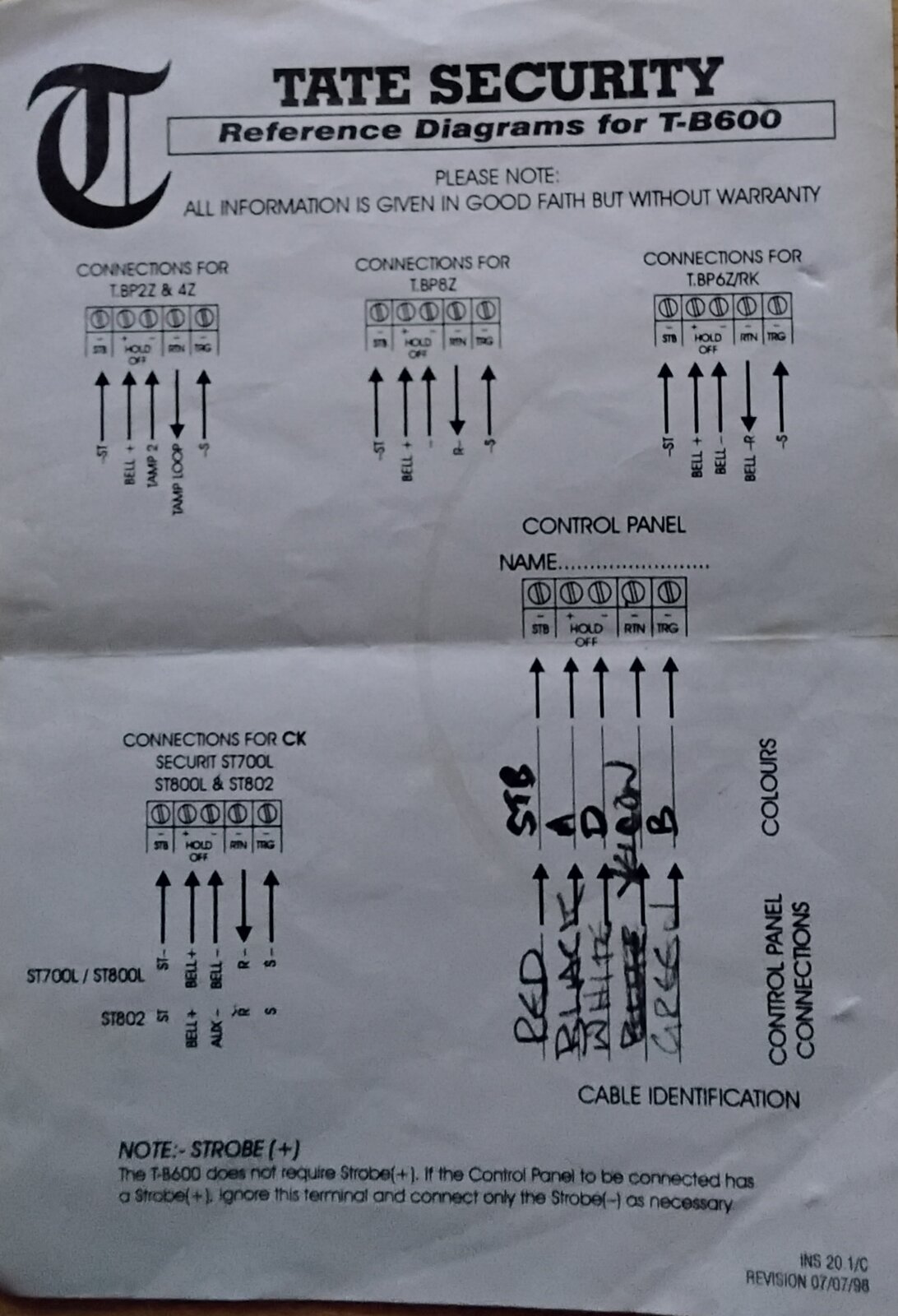

I also found what appears to be the details of the Bell box with strobe P1, this leaflet dates back to 1998 and could be helpful if the bell box needs changing.

My money is on the bellbox …. If it’s a Tate/ ventcroft bellbox with the strobe at the bottom ( looks like Texecom 1 bellbox ) the tamper switch is on the right hand side behind the screw , they are known for issues
