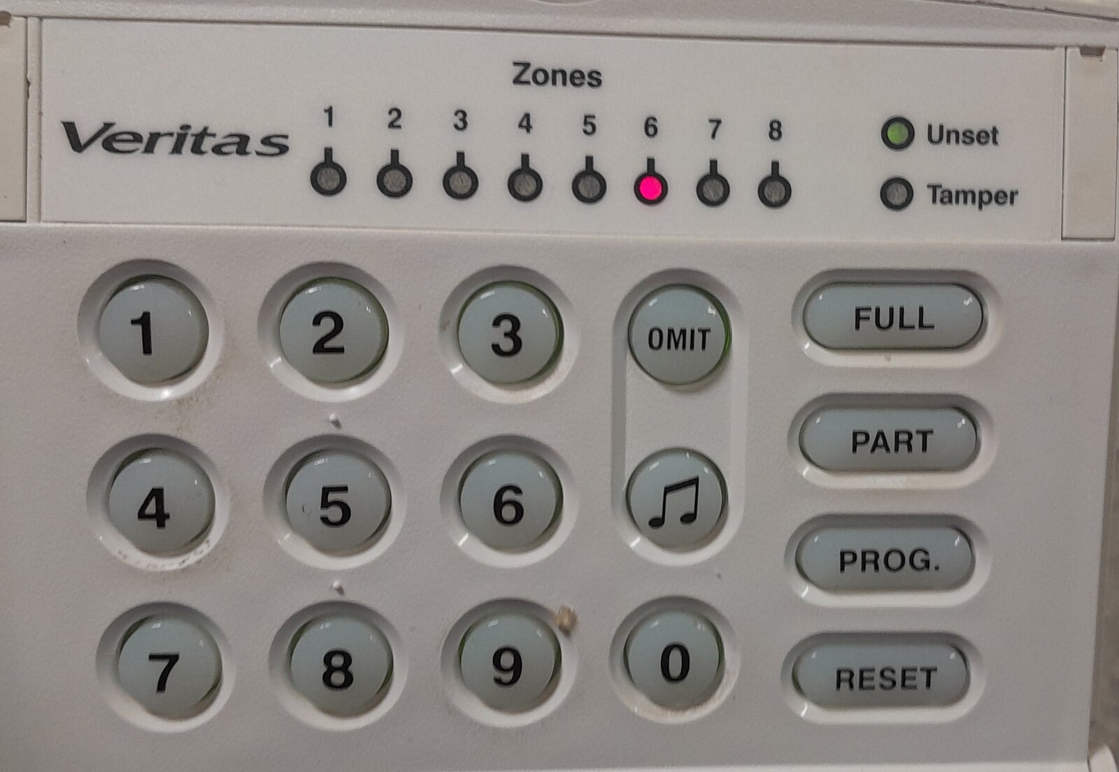

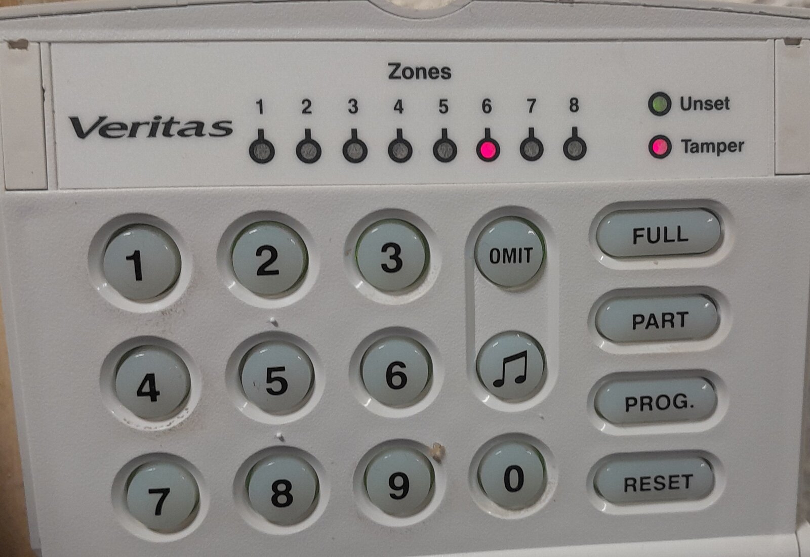

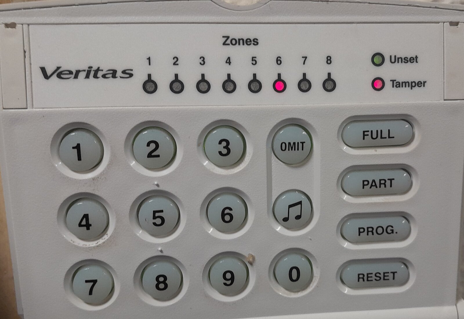

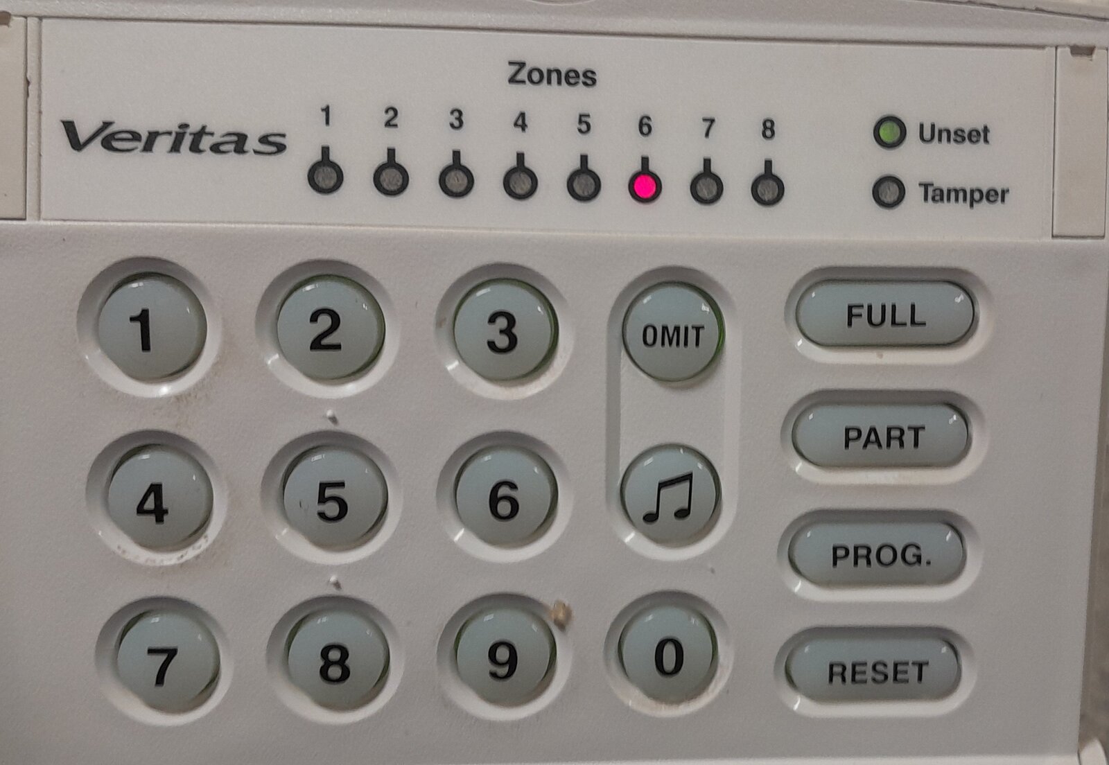

Just an update l finally got a tamper fault while in unset mode at about 11pm last night, it gave event an Zone number and flashing light which was Zone 6, this is the kitchen PIR and l was in the kitchen at the time (see attached files). It had been in unset mode since l deliberately sent off the alarm on Thursday and luckily with it being in unset mode it was only on internal sounder, but l was able to check the strobe was working having already checked the external sounder in a walking test.

apologies but the 00 version of the panel doesn't have the extended log.
I am not aware of the panel having individual zone tampers either.
so if the panel was unset and zone 6 was triggered, then the programming for that zone is likely to be a 24 hour zone type.
So press rest twice,
Inter engineers code then 00
Then type 16 what number is displayed?

My friend that emailed me the page that l previously uploaded was able to get hold of the original installation manual for me and dropped it off this morning so l can photocopy it and return it to him to return to the owner. l have attached the relevant page and from section 2.12 and the above already loaded pictures confirming tamper is flashing and zone 6 is steady, l presumed the tamper switch on the PIR set off zone 6 on the system last night.

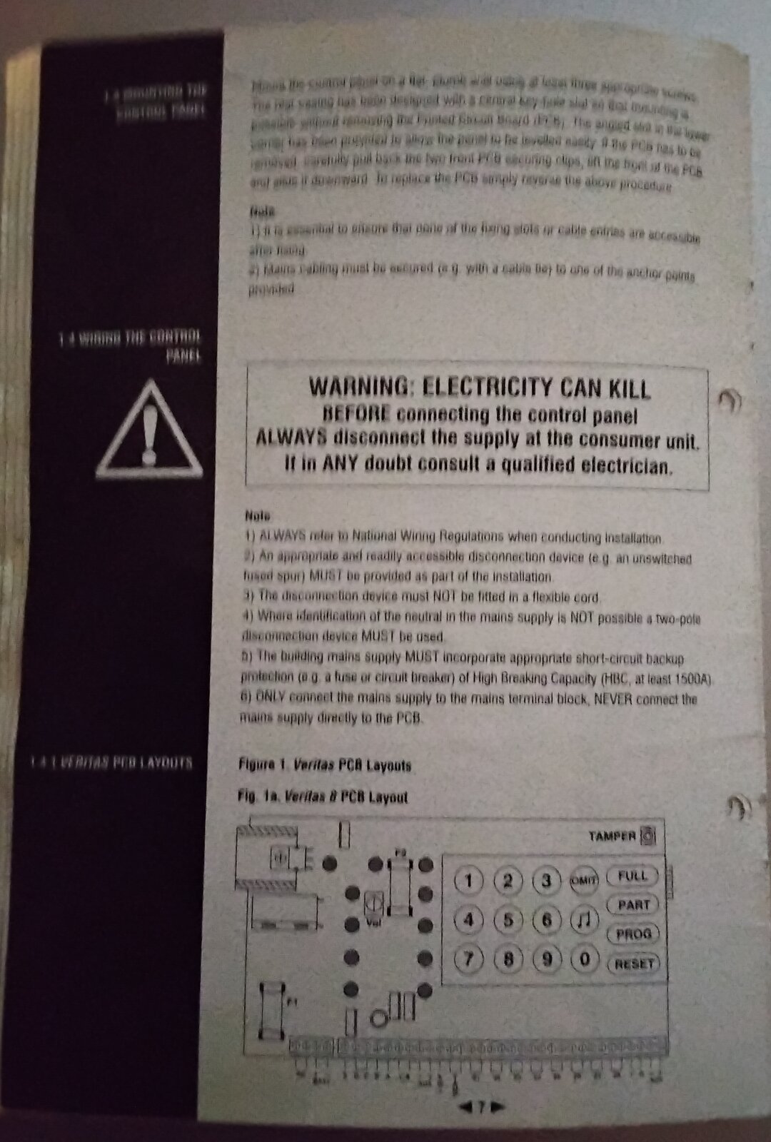

Are you sure this isn’t an early R8plus panel ….post picture of alarm panel PCB …as asked previously..
It states on the panel it is a Veritas 8 and here is the PCB from the manual l have borrowed and it looks exactly like that with the front off, l described it as a Veritas 8 in the post title because that is what is written on the front panel, l even stated it was a very old model of over 20 years old. A Veritas R8 has the tamper switch in the centre of the PCB and not top right like mine and the R8 has no built-in keyboard.

As best as l can with my limited knowledge, l am now following the Veritas 8 manual l have just uploaded page 4 that may help, you told me to key in 16 after using the engineers code and then 00, when l did key 16 in the keyboard confirmed the zone type was a 1 and if you look at 1 on page 20 under section 2.10 Zone Types then that is: 'Entry/Exit with Final Door Set' but that as never been altered or changed!
