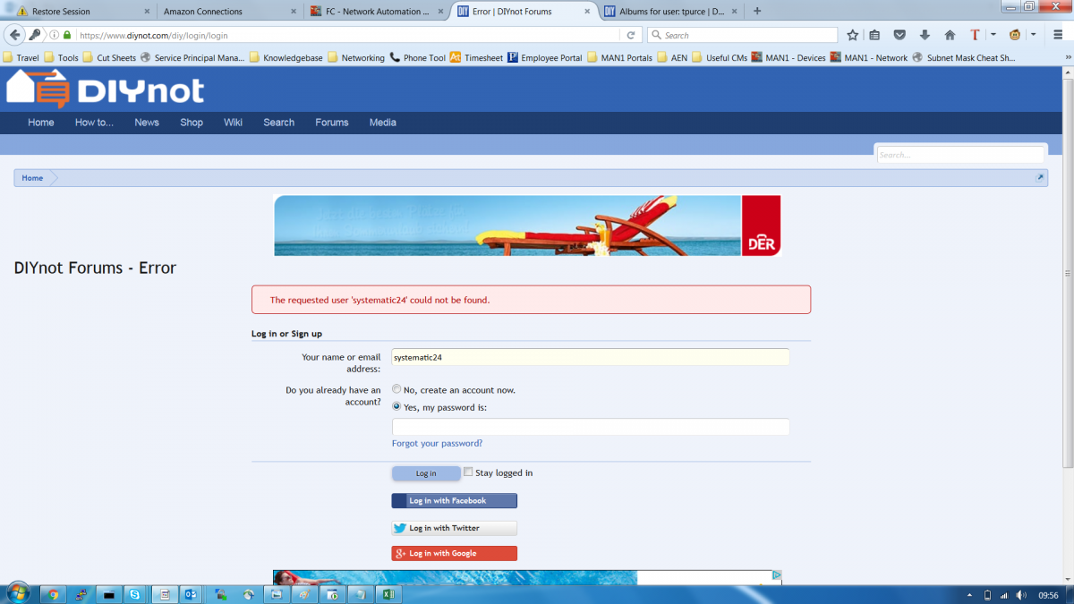

Morning Guys,
I just did the following on my Veritas:
1. 1234
2. PROG
4. 19
5. 9 Bleeps
6. Omit
ZONE 5 lit up for me.
The issue is there is a solid red tamper light illuminated on the panel that I cannot get rid of. According to one of the earlier posts, my issue is:
5 Keypad offline
Any ideas on how I can remediate this?
