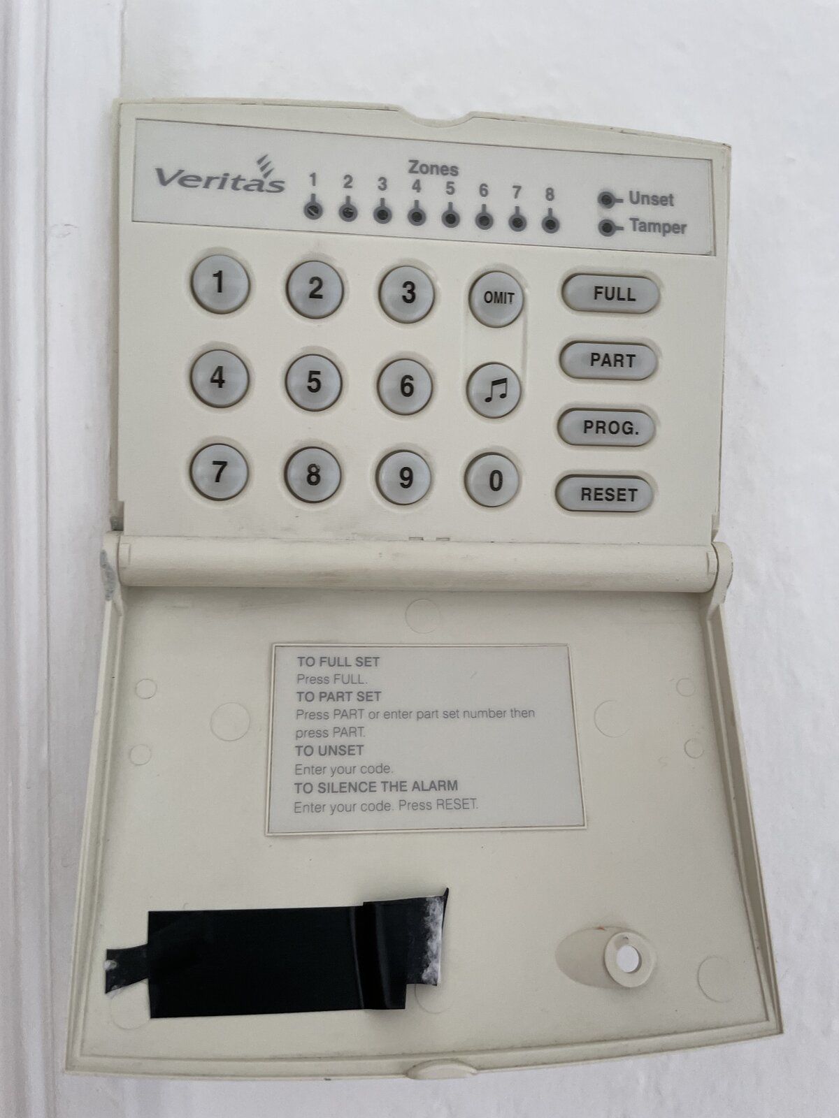

Hi all,
I have a Veritas in my house.
(I think) it’s from 2000.
It’s been working until now.
I was watching TV and I heard a beeping noice (like the alarm reset sound ) coming from the alarm every 1 minute it stopped after 10 of them .
Then, the next day I suddenly heard a noice coming from outside and it was the bell outside sounding.
So I tried entering my passcode in and it wouldn’t stop.
It eventually stopped after 15 minutes.
Now no lights are on the keypad or detectors and please help to fix it because I use it a lot.
When was the alarm battery last replaced ?
Possible faulty battery which has caused a fuse to blow .
Veritas control panel commonly default back to factory settings.
Hi,
It has been serviced since 2015.
As it has had issues before (I was told), but I didn’t live in the house then.

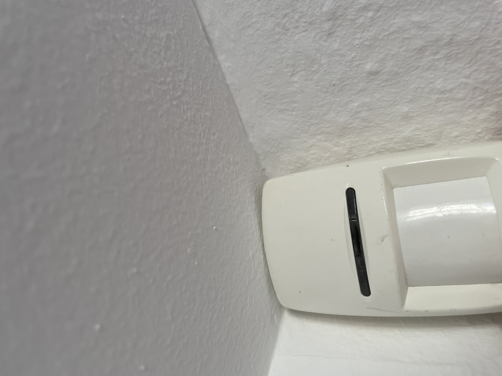

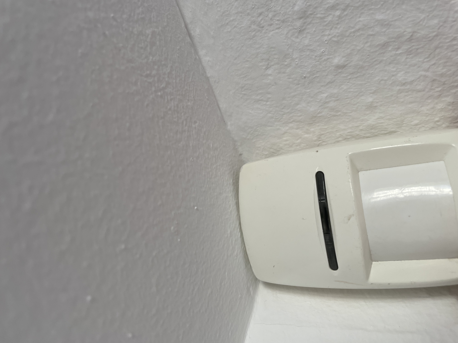

Here’s the PIR that’s also stopped working.
I might get it replaced as I am going on holiday soon and do need an alarm.
Last serviced 7 yrs ago,bet it needs new battery.
Your detector is an old enforcer and the lens break down and go brittle, bet that wants replacing as well.

The alarm booted up as I turned the electrics off and on and it seems like it was asking for my code and pretty sure the bellbox sounded for a couple of seconds and it’s back normal.
Very odd
Not odd at all.
if you turned mains off and bell sounded panels back up battery is dead as mentioned already, mains power back on bell stops ringing the panel starts beeping as it starts to set entering your code stops that process.
your original post 10 beeps is indicative of a power fault, whilst you can set the system with a power fault it is prudent to resolve it asap.
it is clear from this thread your Panels backup battery is the most likely cause if your issues You mention.
As for the PIR can’t be certain, you say it’s not working, but don’t say how it’s not working, if anything has been changed and the picture doesn’t tell me much.
