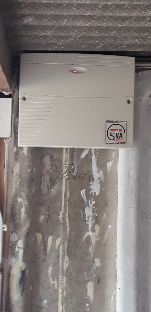

Hi guys I'm hoping for someone to provide me with the installation manual for the alarm listed above, in the box it says texecom 1996, thanks
Thanks for reply, I have tried Google and all I can find is the user guide I have read it's the same manual up until 1999 or 2000, would u know any1 I can contact on here who may have one as I'm desperate to get alarm working right as I have expensive tools in my lock up
