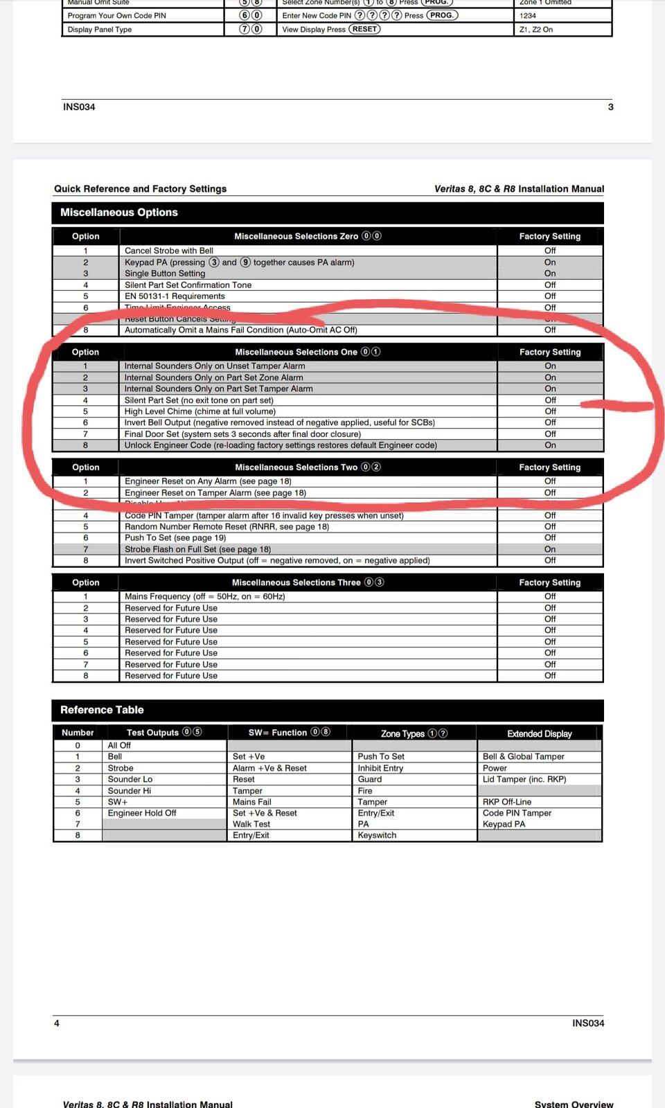

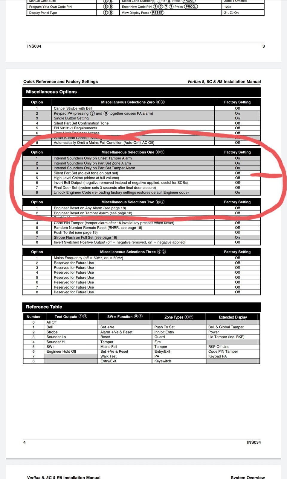

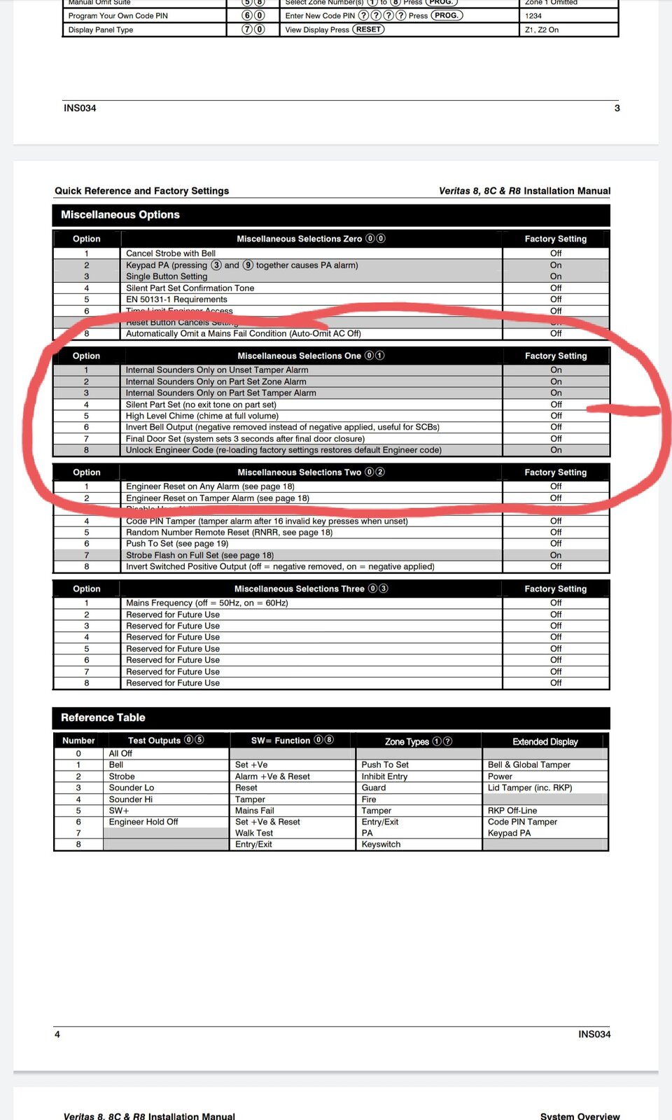

Hi all.
I was wondering if someone can help me. I have the Veritas R8 in our home but whenever we set the part arm, we have loud beeping and clicking noise until it’s fully set.
Anyone know how we can silence the part arm?
I’ve looked at the manual but haven’t really figured out how to do that.
thanks a lot.
Program option 01,then press 4 to turn silent part set on,prog 20210906_072833.jpg
