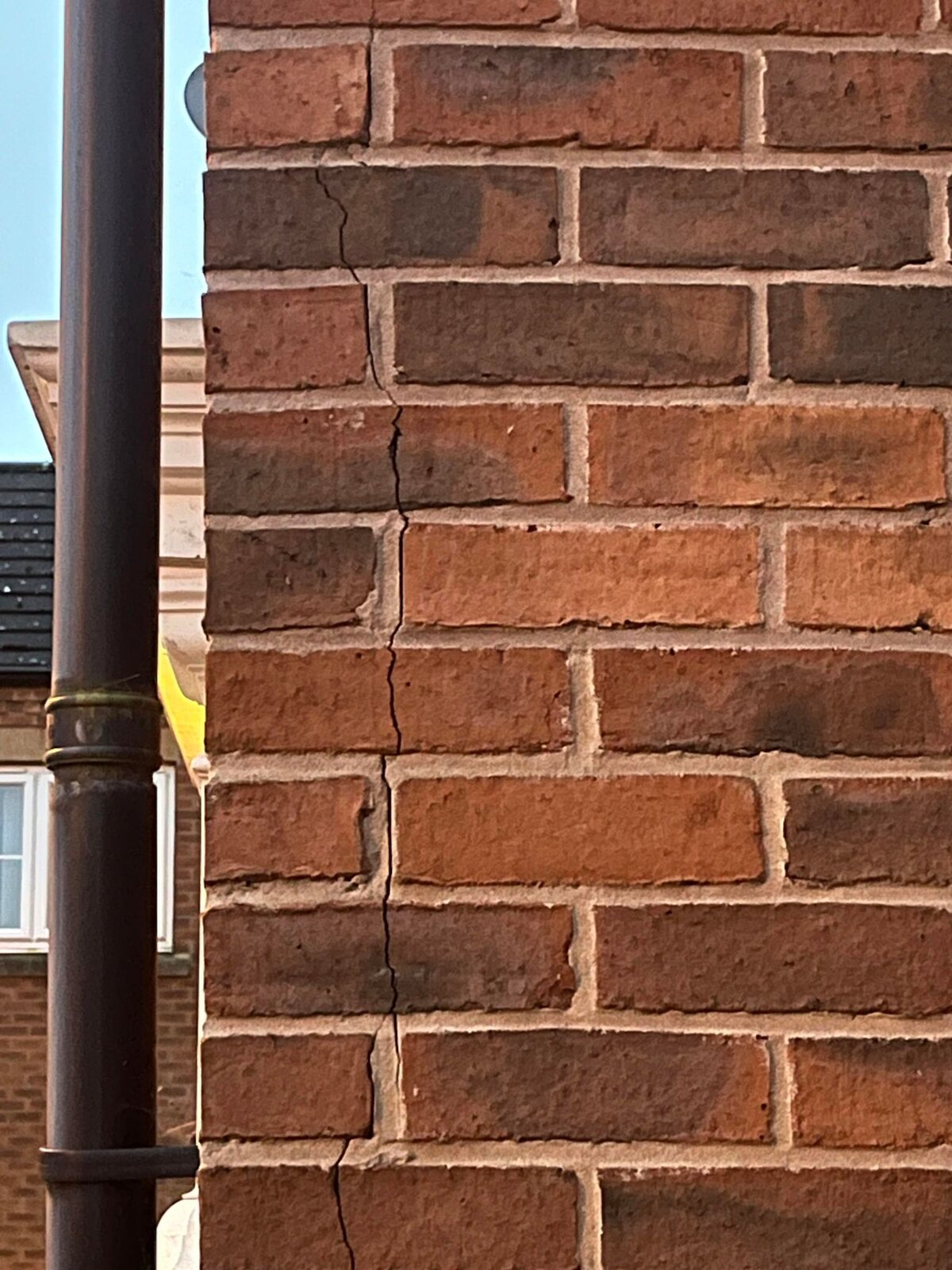

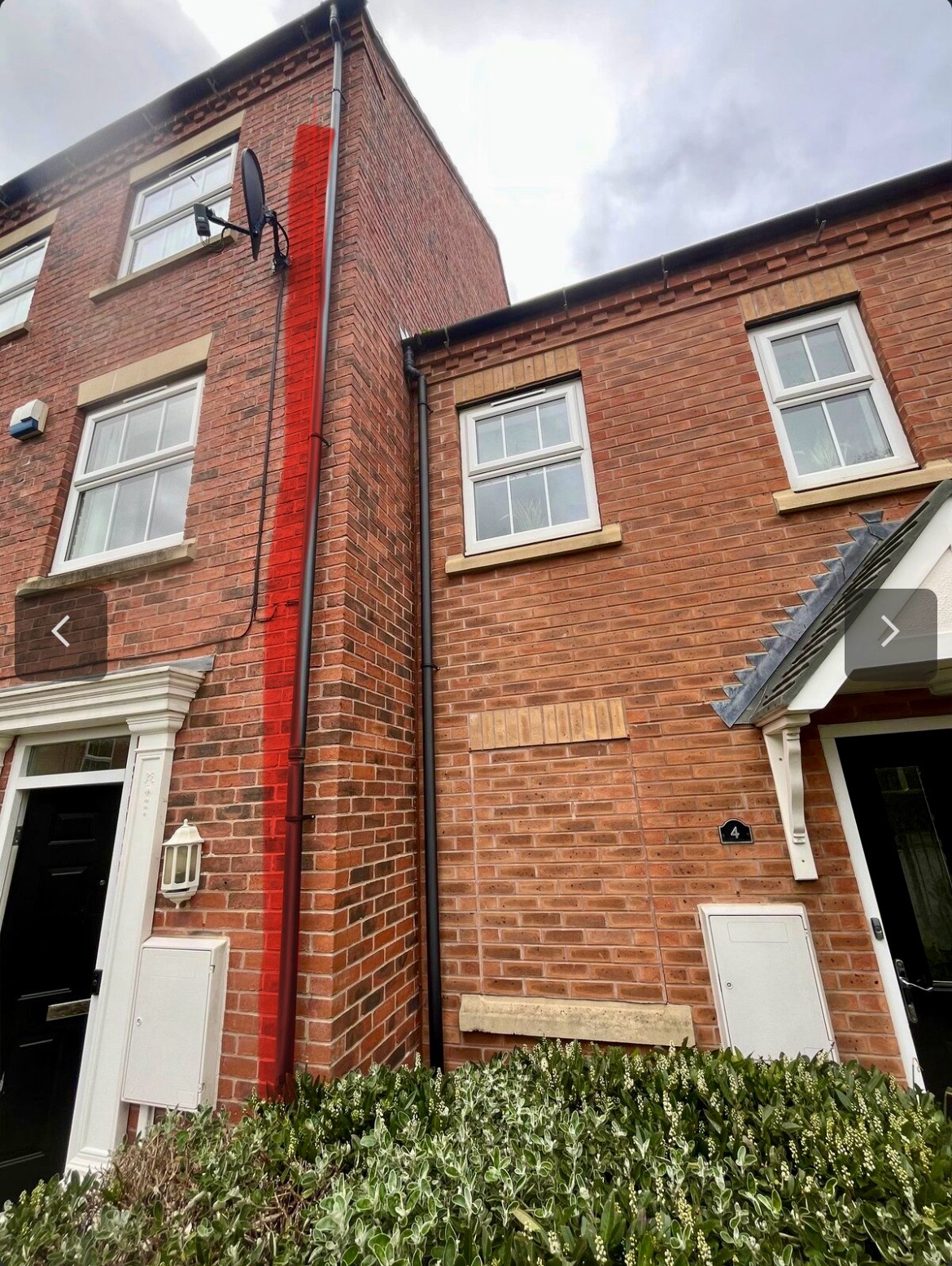

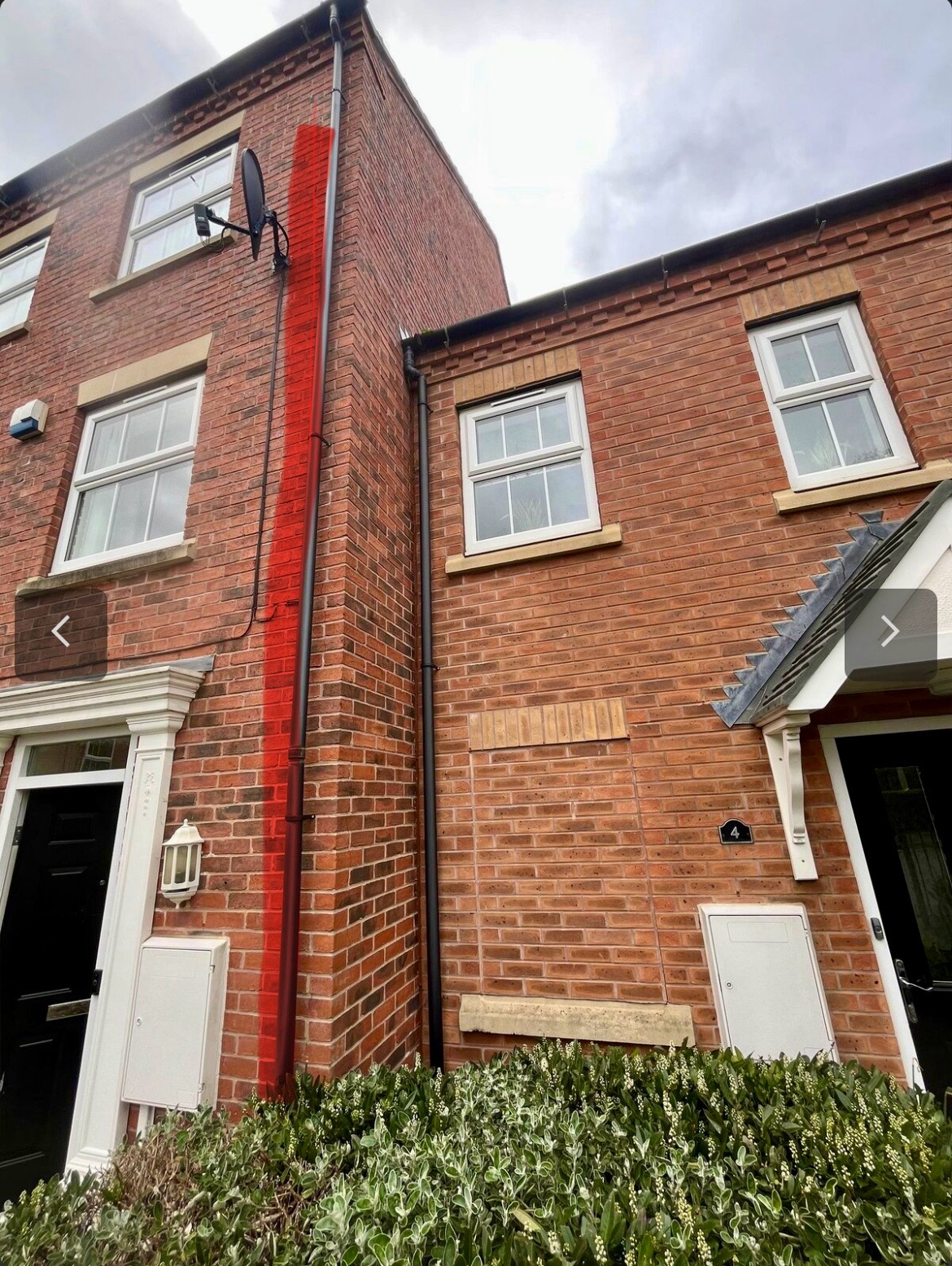

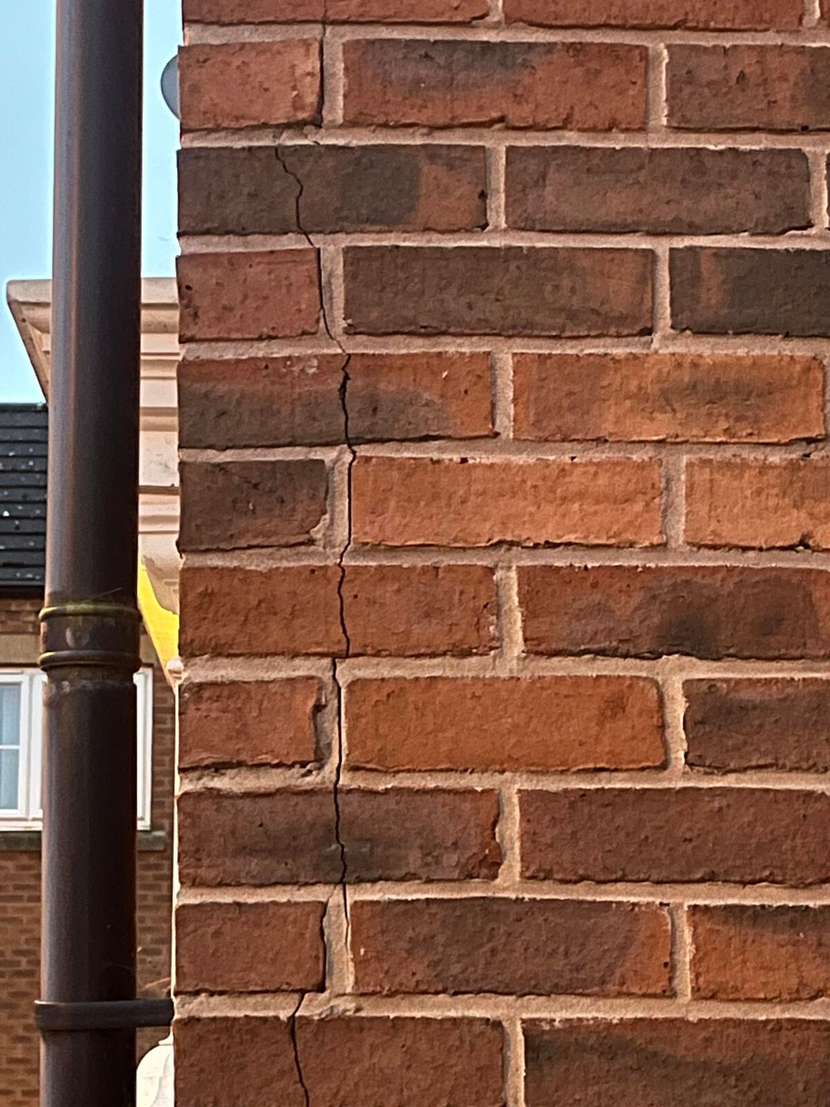

Vertical Crack through bricks - 3 storey townhouse
The cracked brickwork basically runs down the right hand side of the red line/drain pipe. At no point does it deviate around the ‘corner’ to the flat next door.

Hi Woody,
The crack is only on the front elevation, not round the side towards the 2 flats.
I’ve thought about an insurance claim but wanted some opinions/advice first.
The wall is clearly cracked around the corner up to about the same level as the front door height, then it seems it starts and goes up vertically on the front elevation.
Long
Hi Woody, so it is, I'd not noticed that, thanks for pointing it out.
Do you suggest I contact my insurance company please?
Thank you.

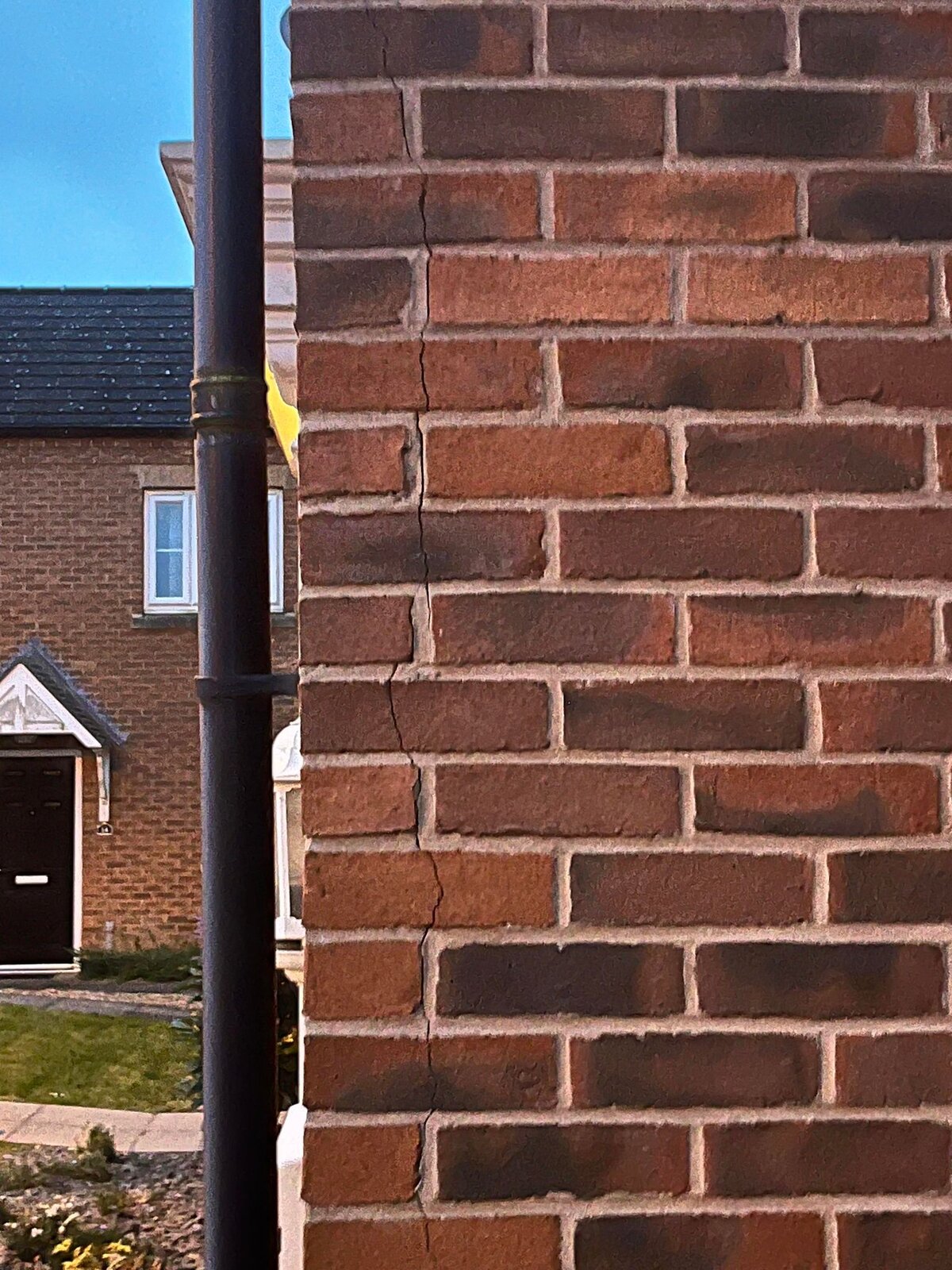

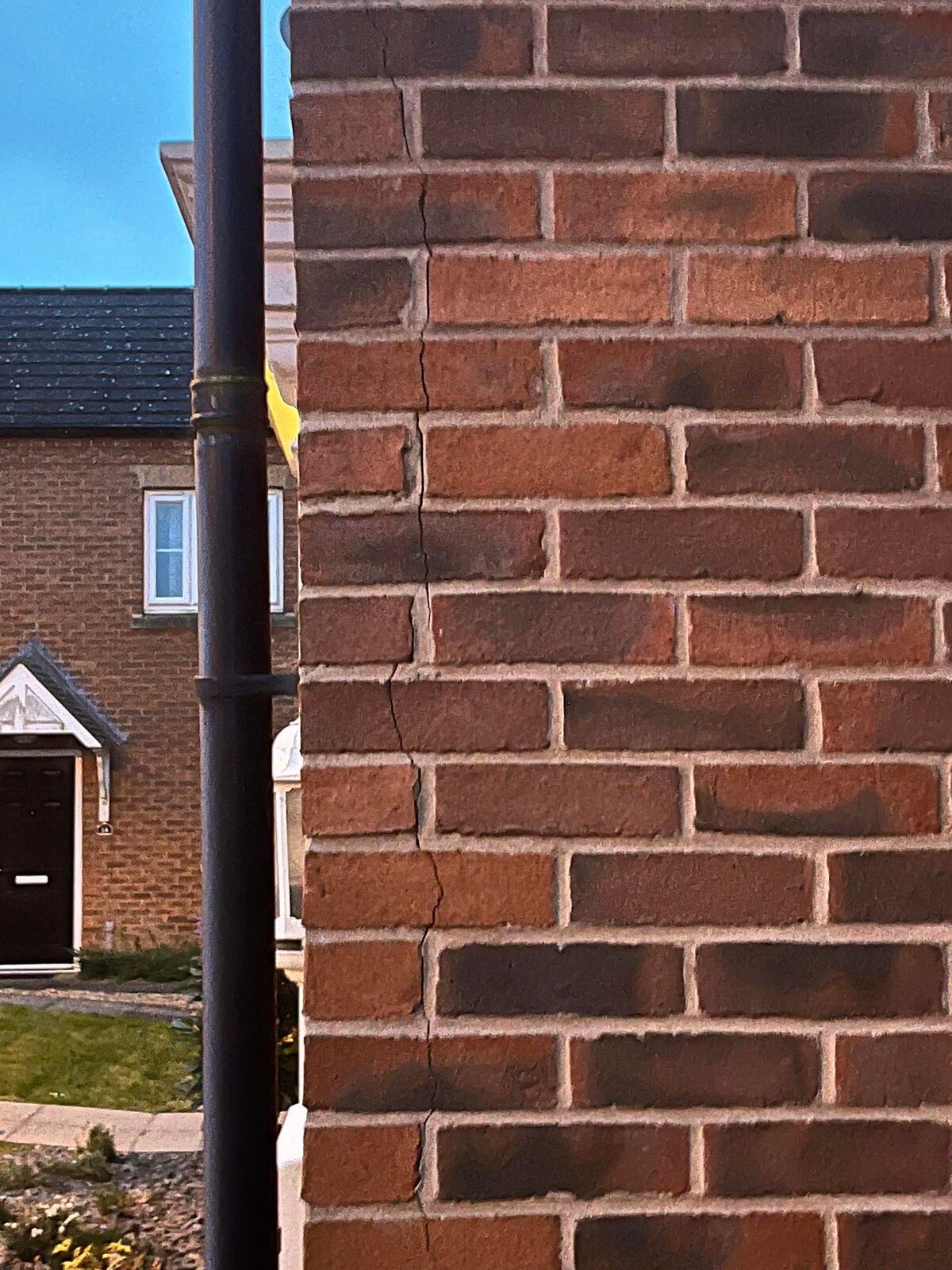

So I've just popped outside (nearly dark here now) and taken a photo, these are on the 'corner'?
Thoughts?

It looks to me like it's just cracked at the weakest point between the two buildings.
It's a long length of wall, there should have been a movement joint somewhere along its length. It's probably just shrinkage, as there's no vertical movement.
Basically the two houses have shrunk and moved apart. The ceiling has moved your way, but the party wall has remained attached to the neighbour. If the two leaves of the wall are rigidly tied then your internal wall may have moved their way. The decor issues may well be related.
There probably should have been a movement joint on the internal corner between your neighbours and your end wall. But there isn't, and this wall has decided to become theirs.
It's probably done most of its moving though. Your rooms are now a couple of mm bigger.

The house was built in 2006, we had it redecorated 2 years ago and in places it's showing the same traits as it was before we got it decorated, IE cracking where ceiling meets wall.
It's hard to tell from the photo, but I'm wondering if there's meant to be a movement joint in the internal corner where the neighbour meets your end wall - it looks like there may be brown sealant there? If so then it's failed to move there and should be looked into - it may be a fake movement joint, basically a bead of sealant over the mortar to keep the inspector happy.
You'd need to dig out some sealant, find out whether there's mortar or foam under it.

Yes, and/or get someone qualified in to have a look, perhaps a structural engineer. You may not have much comeback against the builder after 18 years if it was botched.
It's not going to fall down though, it's just an annoyance and it looks bad, and would have been much easier to prevent it happening than to now have to fix it.

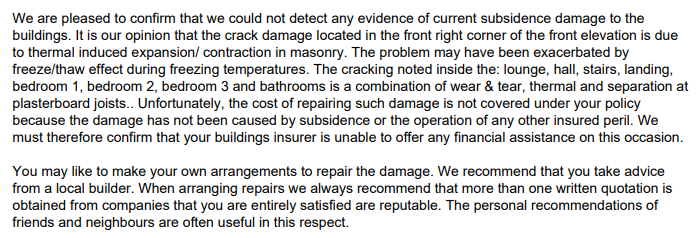

To follow on from the above a week ago, I made a claim through my insurance company and thankfully there is no current subsidence. I think the way ahead now is to contact some local builders and hear what they have to say. Below is a communication following the surveyor visit:
