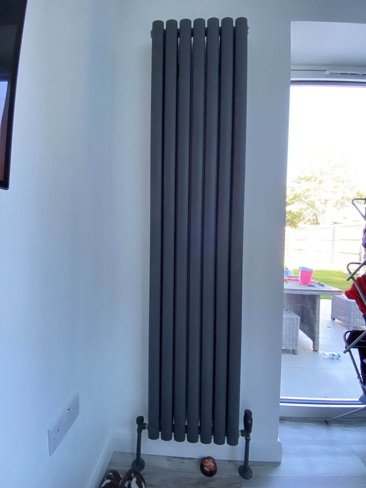

2x vertical rads (Ximax Fortuna) installed in extension a couple of years ago = 2 cold winters in this room, the roads take ages to heat up and the columns heat randomly and unevenly.

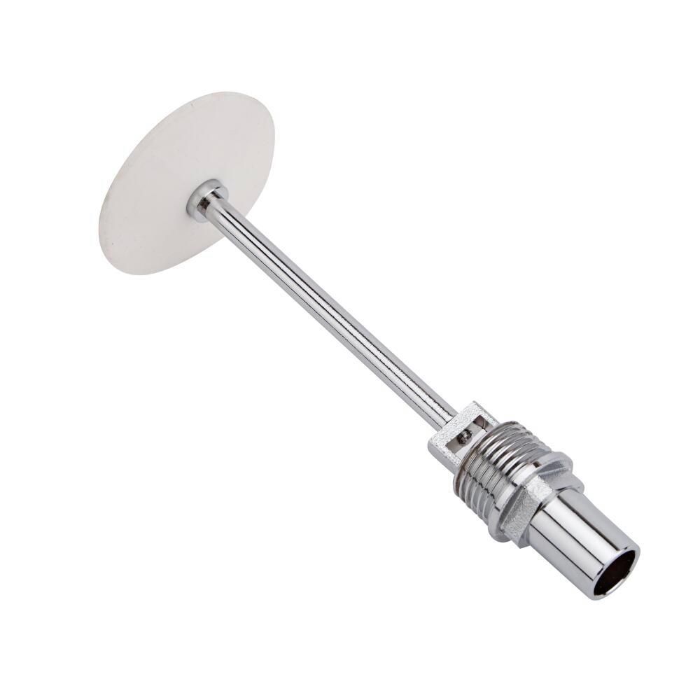

The manufacturer has sent me baffles to fit, but I’m wondering whether maybe the plumber didn’t check originally and maybe the rads do have a baffle and they’ve both been installed upside down, what are the odds!!
So, what do I do, drain the rads and look through top and bottom to confirm no baffle, then fit the baffles? If so which side should I fit the baffles on, return? Worried if there on the flow water would run in, up across and out causing similar issues?

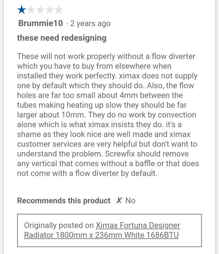

Most of the one star reviews on Screwfix mention the lack of baffles, and the need for them...
It appears your plumber hasn't done anything wrong, and you need to have a go at installing the baffles.

Here's an example of how to fit one, on a similar (quite possibly identical OEM) rad, by Best Heating.
I’ve got the 2x baffles, 1 for each rad, quite happy with draining the system and fitting these, I’ve removed many rads and put them back on for decorating….
In your opinions, baffles on the flow or return side? (Not that I can easily identify which is which as the pipes heat up pretty close together, but I think I know!
And, do you think I need to chop down the rubber bit, it’s quite substantial and think when placed in the rad it’ll crumple, whereas if chopped down, but still a little oversized it should lock the flow causing the water to run up the rad?

If the extension is a decent living room size, going by the pic it may be, with a patio door, no lined curtains etc, then I can just about be certain those rads will take forever to heat the space, if at all. They look nice but honestly they are crap at heating anything but the smallest of spaces. They will heat anything within 3-4 feet and the rest just won't warm up for an absolute age as their convection potential is lousy and that's really the only efficient way to quickly heat up a reasonable sized space using radiators.
