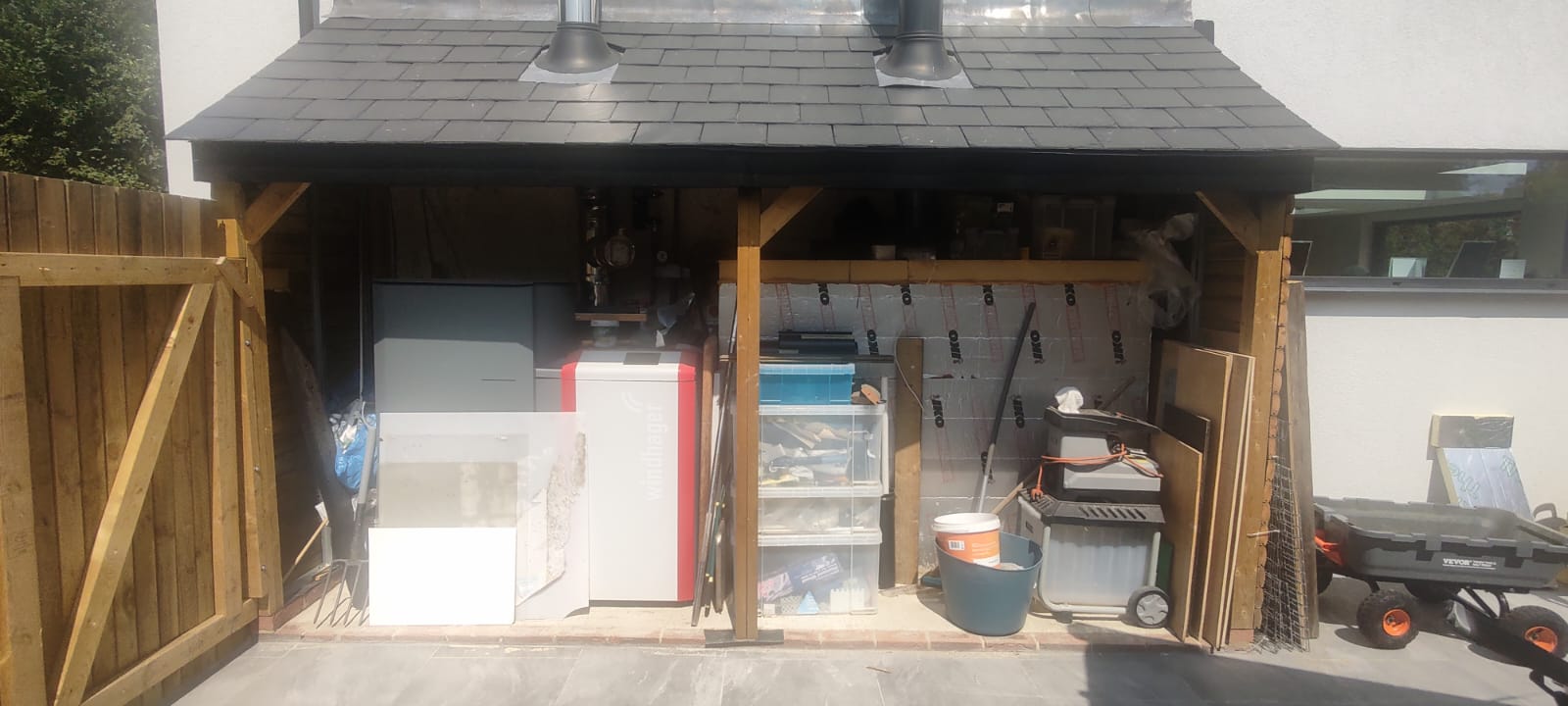

I'm looking for material for a very specific application. I have an outside storeroom that I am fitting 2 x 2m roller garage doors to.
I have a storeroom has a boiler inside that needs10 sq cm of ventilation and I'd like to stop the doors down securely onto a solid surface that has ventilation gaps below it.

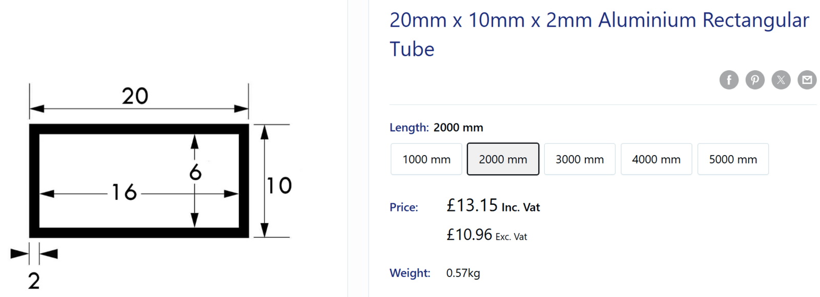

My latest idea is to get an aluminium box section (8mm x 40mm x 2m and rout a series of channels through the narrow face on both sides to provide the necessary ventilation. Like this:
Does anyone have a better idea? If not - can anyone suggest where I can get this sort of box section?

Thank you for the replies. The boiler is a Windhager pellet boiler that sits outside the main house - the required vent sizing I got from the Service Engineer/Installer
The storeroom is a timber framed/slate-roofed lean-to. 1m deep, 4m wide (hence two garage doors) and the opening is 1.8m high

Pure asethetics - I don't want to drill a hole in my lovely log-lap wall
The sizing I was proposing is 8mm HIGH, 40mm deep and 2m long i.e. as flush as I can get it

PS I've found this which is very close to what I was thinking, if a little narrow
Such a thin section will be of no use, as a slot a few mm wide will very quickly be blocked with dirt and provide no ventilation at all.

Also, the wider and thinner a vent hole is the less air will actually go through it. The static "boundary effect" reduces the effective gap.
