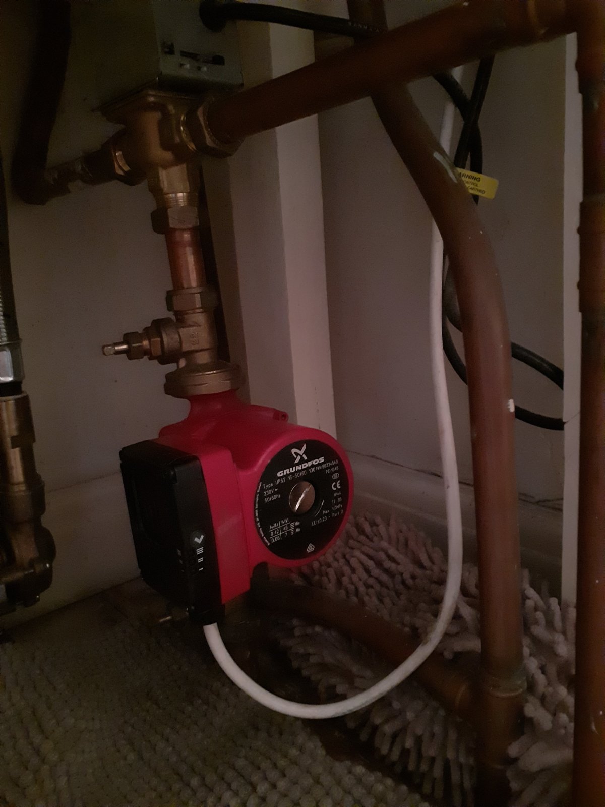

can you check to see if the pump is fitted on the flow or the return pipe, turn the boiler on and the flow should get hottest first, you say you are getting air problems, if this is the case then with your boiler the pump should only be fitted to the flow, for others reading this is for this boiler not every boiler

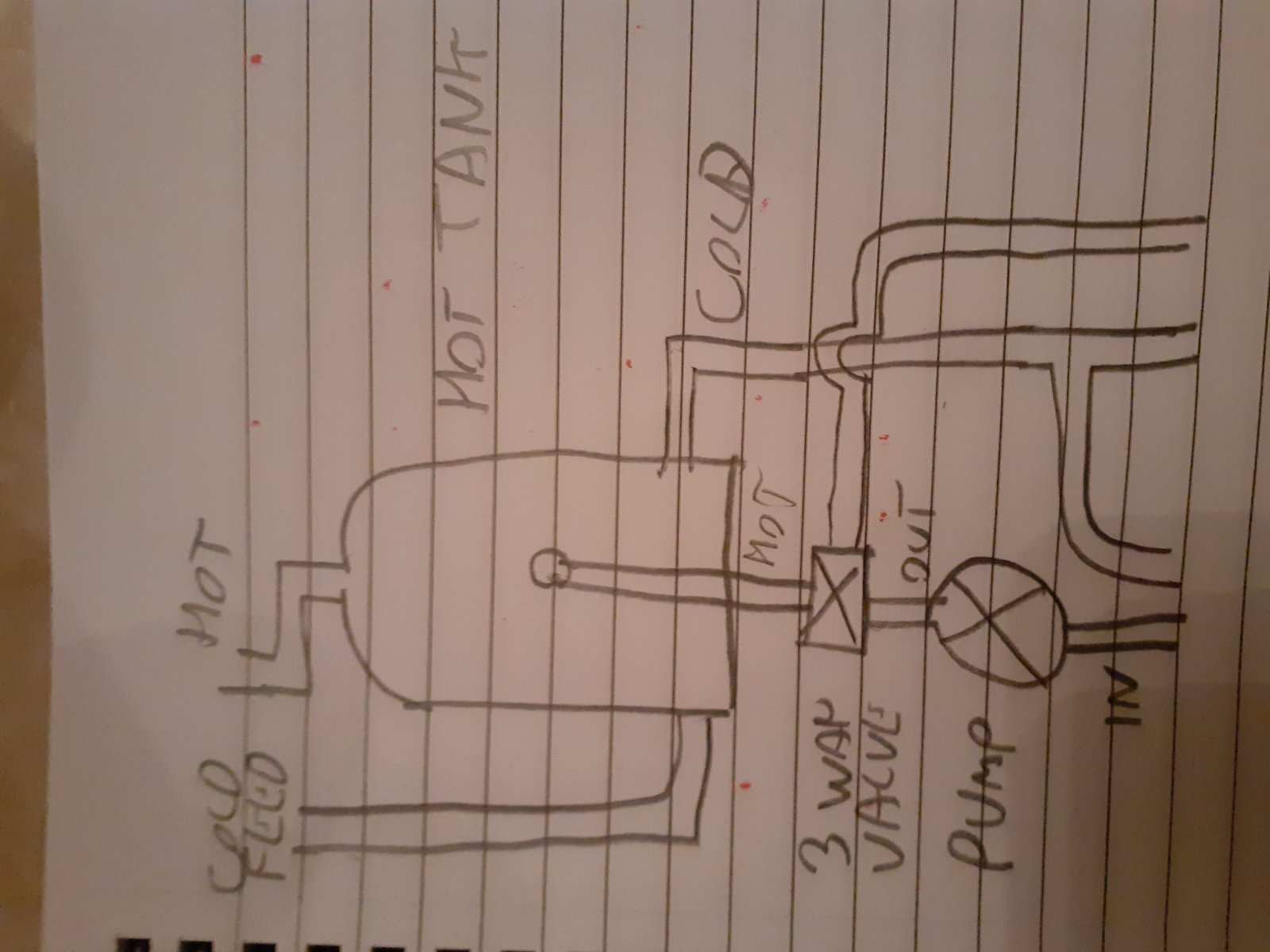

Pipe goes into bottom of pump (inlet) then out of top (outlet) into 3 way valve
It was already warm , it's not easy to follow pipework as it disappears into floorboards but the other pioers I airing cupboard get warm after it runs
Pipe goes into bottom of pump (inlet) then out of top (outlet ) into 3 way valve
These pipes already warm, when I start the pump other pipes in airing cupboard get warm, not easy to trace as they disappear into floorboards
Not sure if the pics or my rough diagram will help

No sorry your diagram makes no sense, wait untill the system is cold then turn it on and see of the pipe with the pump on is the first to get hot

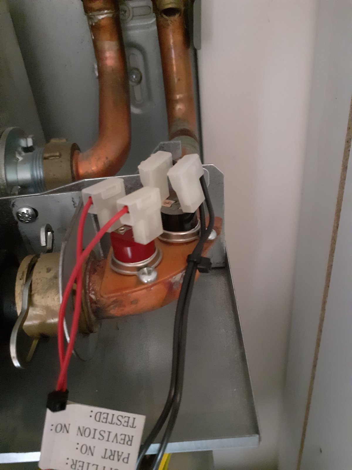

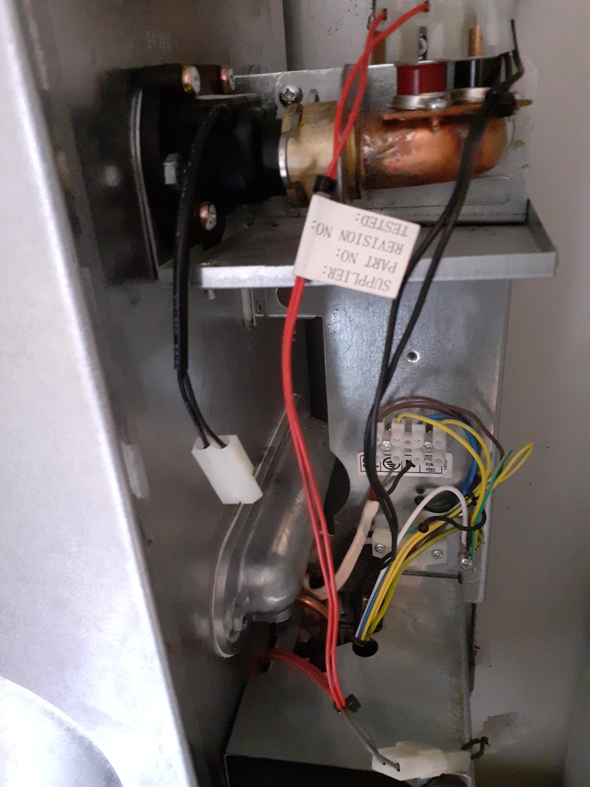

Yeah, the two black wires are now connected together, see pic
That can not be left like that, my advice is to turn off the boiler immediately, an engineer is permitted to by-pass a safety device while still on site and working on a boiler, but at no time can a safety device be left by-passed, you definately need a different engineer
