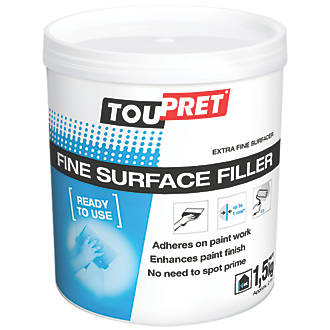

I use https://www.screwfix.com/p/toupret-fine-surface-filler-1-5kg/935jj
Stripped a wall, there was paint underneath that half came off. Looked like Tommy Lee Jones face.
Filled all the holes and scratches. Feathered edges.
Cannot tell. Great stuff. Only good for 1 or 2mm deep or it sinks, but, deeper holes require their normal filler.
Way better than cheap filler.
It kinda depends on your tolerances.
The Toupret fillers are a cut above the likes of Tetrion or Polyfiller powder based fillers (in the main) but any filler that is slightly harder or softer than the existing emulsion will leave a dent or ridge.
I haven't used the particular filler recommended by Jacko though.
Part of the secret is using the right grade of abrasive. The mesh papers (eg Abranet) are often better than standard papers
