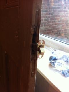

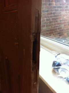

Hi,

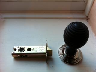

I've recently had an internal door dipped and stripped and have purchased some new door furniture to fit. Unfortunately the door has a large hole in it where the previous latch was fitted. The latch I have purchased and want to fit is much smaller so wanted some advice on how to fill the gap so I can re-cut the smaller space for the new latch. Would Wood Filler work?
I've attached some pictures below for clarity. Any advice is gratefully received.
get the correct latch and lock set
or a wooden block the correct size covered in pva then completly remove the damaged area on the door edge to a depth off 5.5mm the full width and angled to 45% at each end to hold the patch in
glue and clamp in place then fit your tube mortice lock
