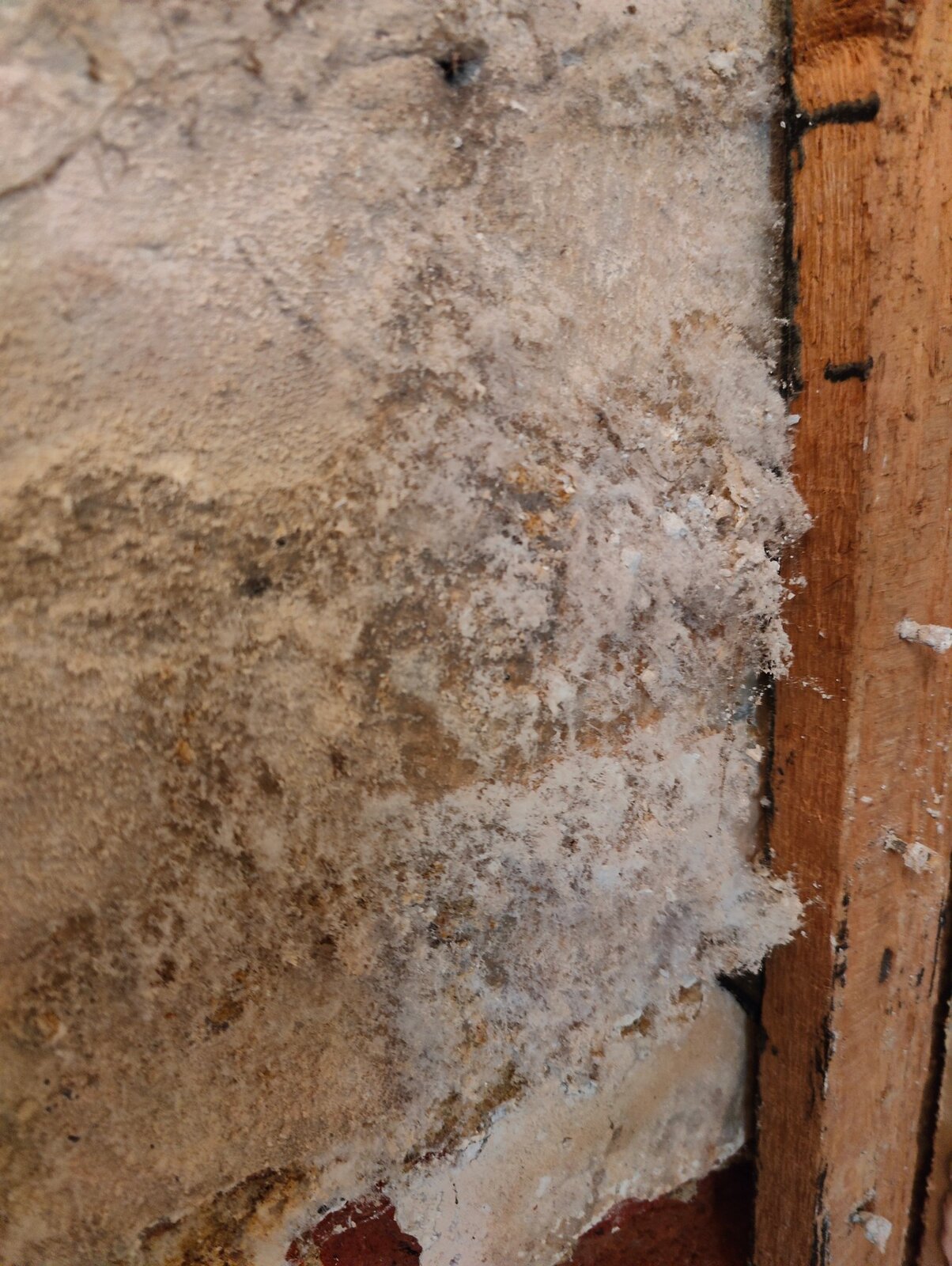

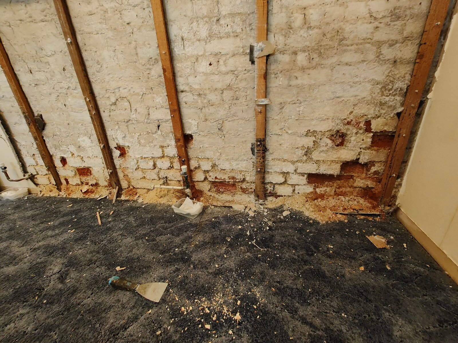

We've lived here for 25 years, the flat is a basement of an 1860's victorian terrace and was converted back in the 1980's. It was obviously whitewashed bare brick before so the "developer" battened and plasterboarded every internal wall. The floors are screeded and we don't know what is beneath, probably brick and no damp course.
Anyway; we've had the bottom of the walls in the living room blowing the plasterboard so we've decided to rip it out and have a look.

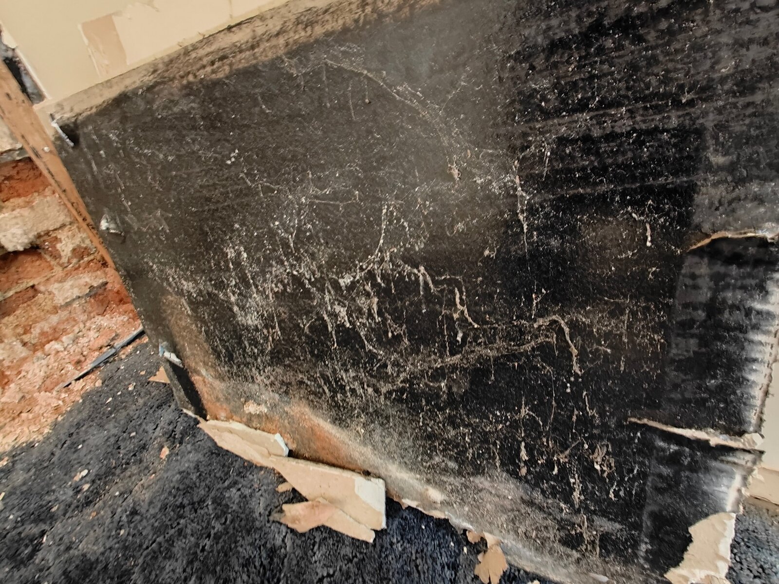

The cause of the blowing is spalled brick dust and it's several inches deep. The battens are, surprisingly, in pretty good condition although some have rotted at the bottom. The lower plasterboard panels have been painted with black bitumen (I think).

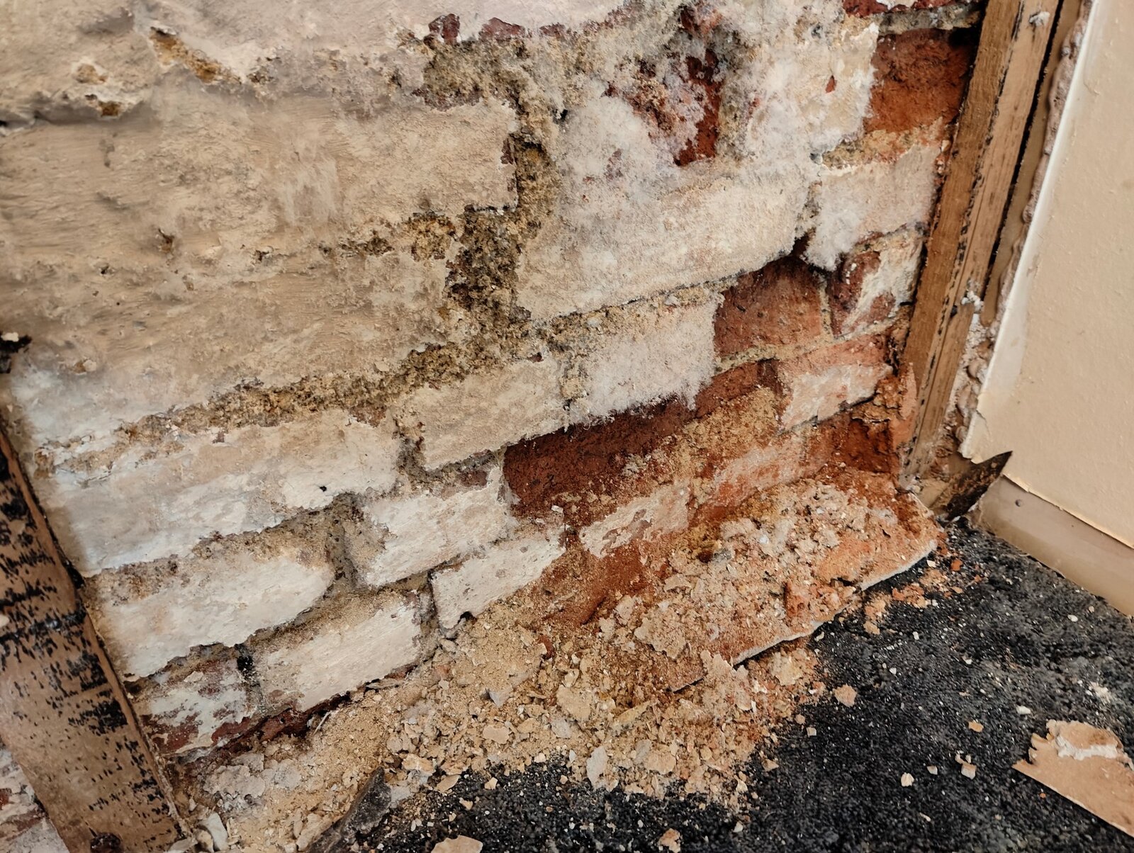

Main issue is, many of the lower bricks - up to about 5 or 6 courses - are badly spalled (but there's also a kind of furry coating in one place that as far as I can see isn't fungal but crystalline). See pics for what I mean.
Anyhow - what's the best way to proceed? I'm going to clear up the loose dust and brush down the brickwork and probably replace the battens, but do I use a masonry sealer or should I get the bricks replaced somehow (I think the wall in the pics is a supporting wall)? Should I go ahead with wood or galvanised steel battening?

Replace tne bricks and put in a dpc, ideally physical but an injected one is probably better than nothing. You also have an opportunity to add a dpm
Treated wood should be fine, use plastic plugs and spacers to keep wood from touching the brick. Maybe add suitable insulation
Replace damaged pb

With that basement to do a proper job you really need to consider tanking up the walls and across the floor, with a pumped drainage system. That is the only way to do a permanent job on it without any future problems.
The white furry stuff is salts, a sure sign of dampness.

As @tony1851 says, the white fluffy stuff is salts. They are hygroscopic and will be growing from damp both coming from the brick and from the humidity in the air. I'm not going to comment on what you should do with a basement as I have no personal experience of ever doing this. The only thing I can add is that I have stabilised very badly spalling and crumbling outside lavvy walls by wirebrushing back and then using an SBR slurry of almost neat SBR and cement, which once painted with masonry paint has proved to be surprisingly durable.

That's an internal wall (there's a radiator pipe coming through it), so it will be rising damp and can be remedied with a suitable dpc (there was probably never one there as it was originally a basement) looks like they just asphalted the floors and lined the walls instead of continuing across the entire floor.
If the right hand wall is the external wall it appears to be the worst area and needs stripping to investigate - if this is similarly damp it will need vertical tanking and a vertical dpc where it abuts the internal wall.

You really think all that damp's coming up from the floor? Impossible. The pipes are an interesting mystery though.
It was an internal wall. Now it isn't, there's a load of infilled stuff behind it and the sky above it.
I think (but obviously don't know), that the wall facing us is an internal wall with another room on the other side, in which case it would benefit from a dpc that would be continuous with the floor dpm. If the right hand wall is the party wall now backfilled with whatever from the new construction next door there's no point installing a dpc - needs fully tanking as said.
