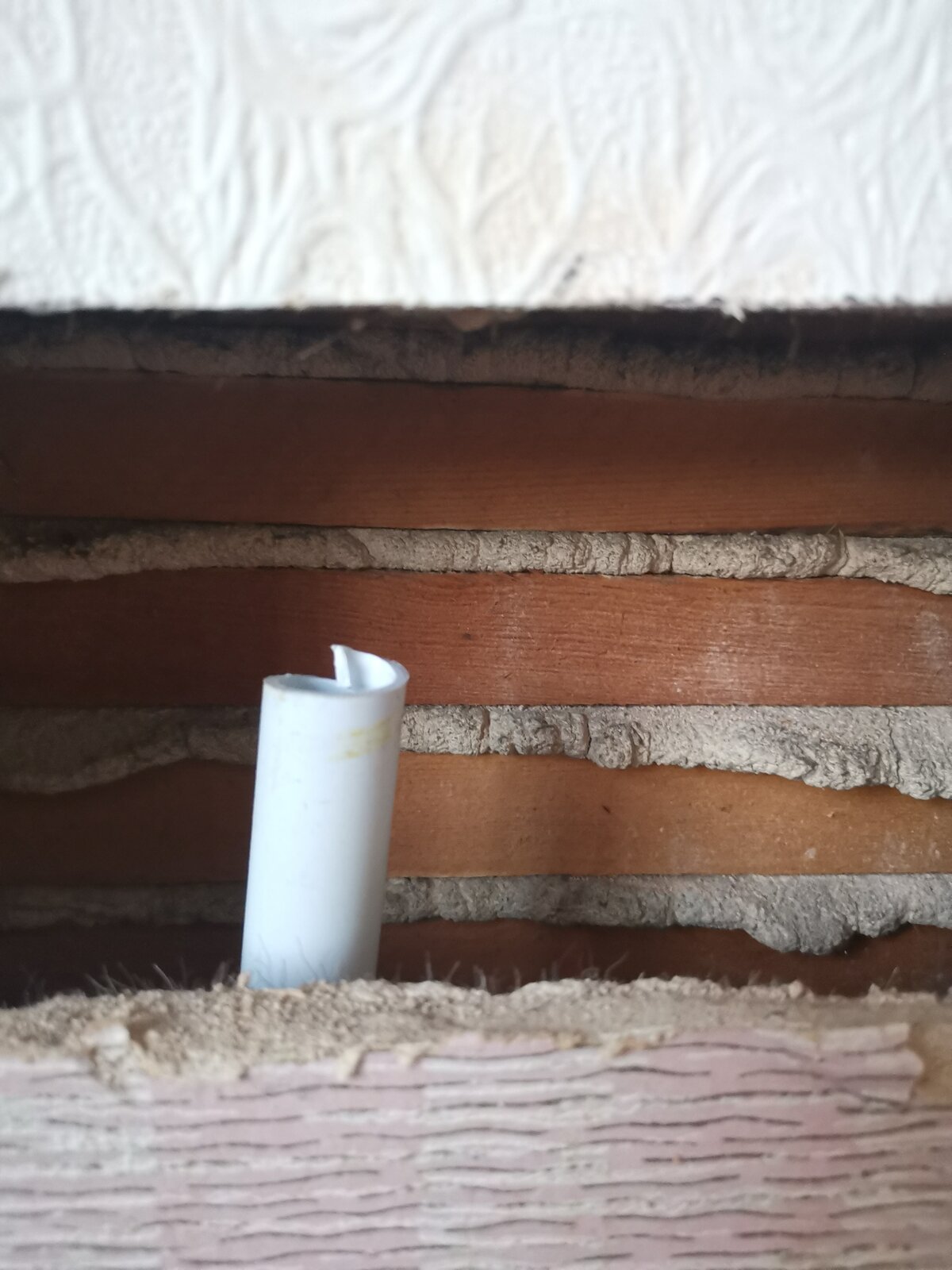

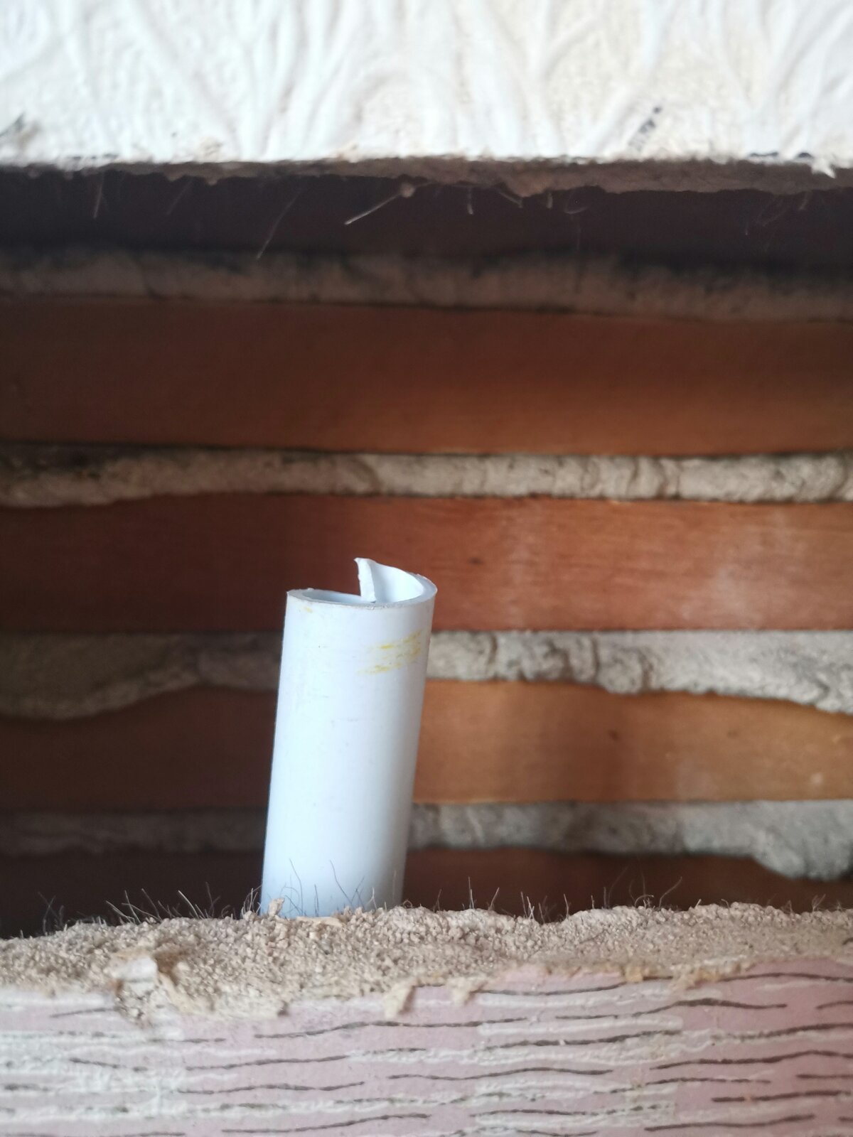

Hello everyone. This has probably been discussed previously but have not found any informative posts making me feel a bit better. (panic) So as many other fellow DIYers, I have purchased a nice Victorian terraced house built in the 1920s.The big renovations have started today and boy is the project full of surprises. The main bedroom is seperated by, what it seems, a plasterboarded wall. This does not look like a recent build as the plasterboards is extremely crumbly. Having cut into this wall, I have found that little fibers stick out of the plaster material, so immediate panic stepped in as suspected to be asbestos. Could any way more experienced people let me know what you think? Upon researching I came across the fact that hair was added to Lime plaster back in the day for strength. So I am currently very conflicted.
Ordered an asbestos test kit but wanted to see if anyone had an idea here first.

Lath and plaster. It contains horse hair. Totally standard for any stud partition in a house of that age. Asbestos would look nothing like that
The ceilings will all be like that too if they haven’t been replaced

Assuming you’ve cut out the same stuff as you can see on the other side (wooden laths and plaster) if it’s sound I’d patch it - it’s horrible dusty stuff to remove and dispose of if you don’t need to.
I’d patch it by fixing a couple of battens behind the cut out section (screw from the front into them to pin them in place) then fix plasterboard to them to fill the hole, then plaster.

If you can see hair or fibres, you are not seeing asbestos fibre, as that is microscopic.
A lot of so-called horse hair is actually coconut fibre. Usually brownish, sometimes a bit orange, burns without unpleasant odour.
Was widely used for "horse hair" mattresses and padded furniture.
Naturally free of odour and infectious disease. Does not support clothes moth.
Also called Coir, it was cheap and plentiful in the days of Empire, for marine ropes, doormats, brooms and brushes.

Interesting. This is for sure white-ish.
