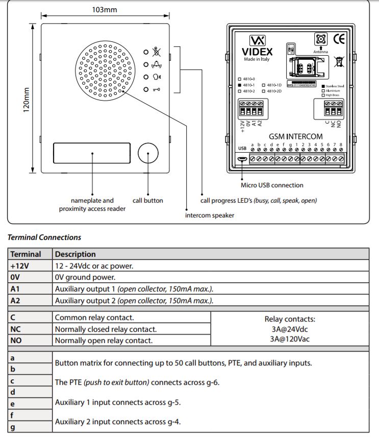

is it possible to wire the videx gsm unit to ring a normal type door bell inside my property?
The present arrangement is that it rings my mobile which isn't much use when it's on silent / not on my person
Simon
Sorry to bring this one back up, will any of the outputs in the attached file allow a bell to ring directly or via a suitable relay when the call button is pressed?

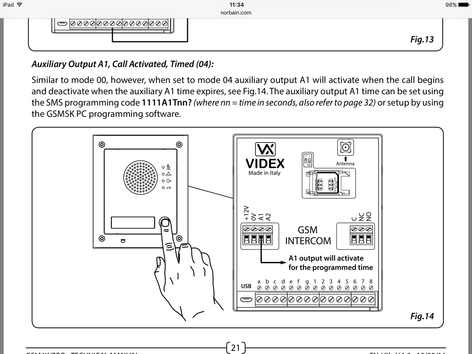

As in this ? If you have a spare cable pair to the house ....probably not if a Gsm intercom has been fitted , next step a transmitter and a receiver ....?
