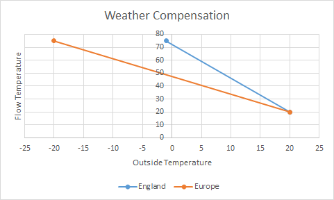

The value given to the heating curve is actually the average slope of the line.
The design flow temperature is the same (75c) although Europe can experience much colder winters (-20C) than England (-1C).
The curve/slope for "England" is (75-20)/(20-(-1)) = 55/21 = 2.62
The curve/slope for "Europe" is (75-20)/(20- (-20) = 55/40 = 1.375 (approx 1.4)
If the curve is left at 1.4 the water temp, when it's 15C outside, will be approx 25C when it should be about 35C.
Leave the "thermostat" at 20C, increase the curve to 2 and monitor the effect. If necessary adjust the curve until you achieve the desired result. Use the coldest room in the house as the guide (make sure any TRV is set to max). Other rooms will be controlled by their radiator TRV.

Nothing to do with improved insulation; that just means that the heat loss is relatively lower.
UK systems are designed assuming the outside temperature is -1C (or -3C); European systems assume a much lower temperature (e.g -20C). As both systems assume a worst case flow temperature of 75C (rads, not u/f), the Europe curve will automatically be lower than the UK.
A UK system could be designed so it uses the same curve as Europe, but the design flow temperature would then be about 50C. the rads would then have to be much larger to account for the reduced output at lower water temperatures.

The curves in the chart say nothing about the heat loss or the insulation. They just show how the flow temperature will vary with external temperature for European and UK systems, assuming that both are designed based on a flow temperature of 75C. If u/f heating was used the curves would be much flatter as the assumed temperature would be about 50C.

I was trying to explain why the default heating curve of a Viessmann controller, built in Germany, is set to 1.4. It's because they assume that the system will be installed in a country which experiences very cold winters.
