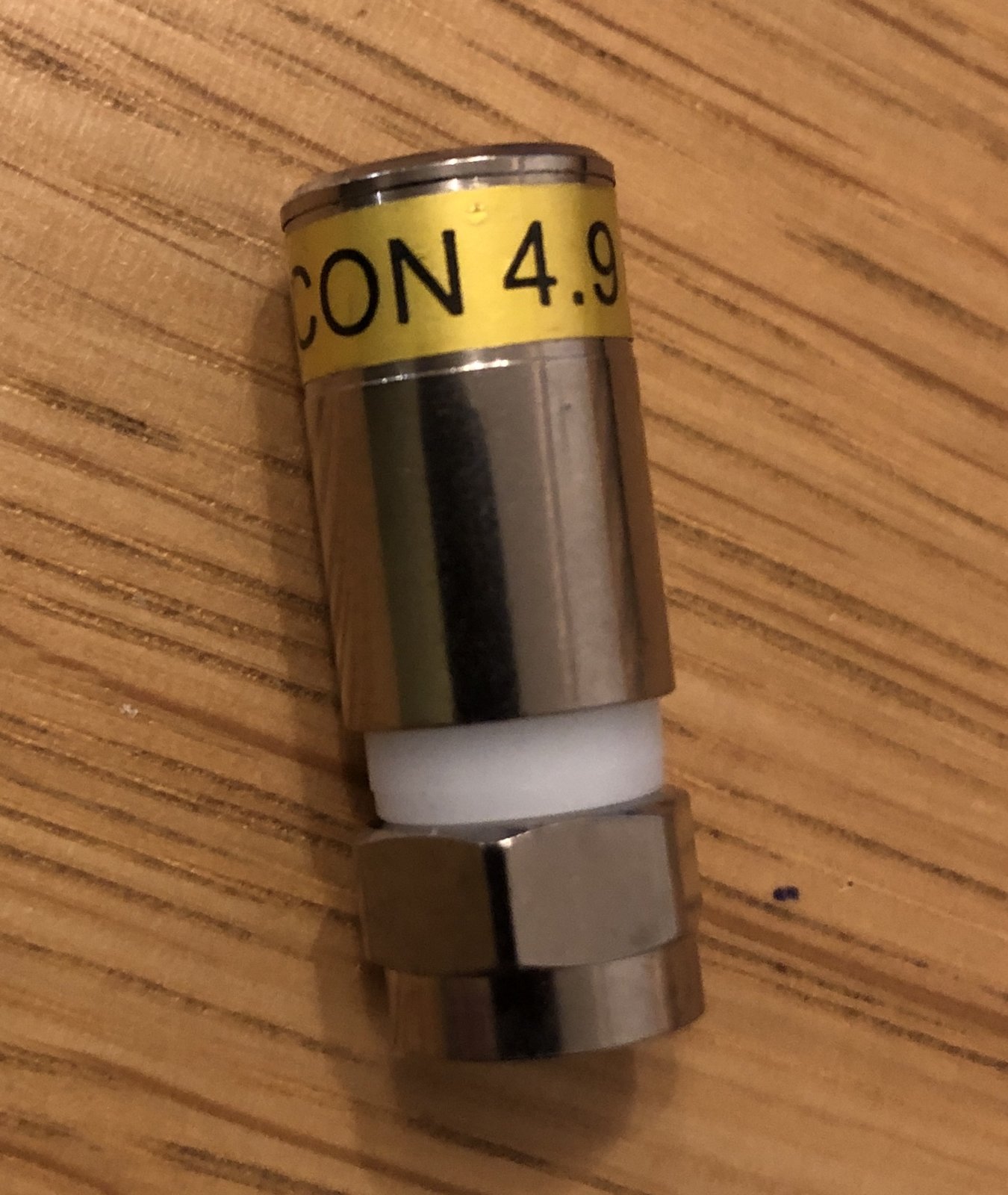

I have an old Virgin Media cable to test my F connector skills on (from last house). I have tried to install an F connector on it today and it doesn't fit!
The cable appears too thin and the connector just slides right off after being compressed, does anyone know if there a different, more specific connector?

If worried that you will get cuttoff by Virgin (which I somehow doubt it considering the weight of Virgin requests to join I get every day through the mail) you can get ones that look identical to the original.
They are called "Snap Seal F Compression Crimp Connector Plug"
I have never used so do not know how easy to "snap seal" without the dedicated tool. They are here on ebay:

In the video, the guy seems to remove all of the copper braiding when he uses the stripping too. Or am I blind?
Your not blind.
The snap & seal connector must push into the braid within itself.
If you look at the ends you will see a tube that the inner pushes into, forcing the braid onto the outside of it, this will then be compressed using the crimpers.
Your not blind.
Thanks, however, looking at other videos, other striping tools seem to score twice, leaving 4(?)mm of braiding and 4mm of the inner core. In each of those videos, the youtuber pushes the the braiding back over the outer sleeve before fitting the compression F-Type fitting.

It's me being a donkey! It does fit, I just wasn't pushing the inner metal tube through properly :LOL:.
I'm doing the proper (not old test cable) cable tomorrow. I bought these connectors off eBay, they are the same as currently on the cable.
