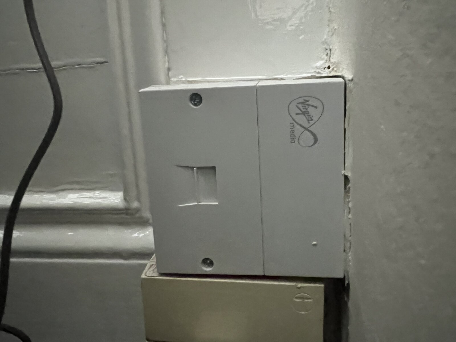

Hi all,
I have gone from having my landline to the ground floor to now having it plugged into the VM modem in the attic, this of course is causing connectivity issue due to the distance between the second and ground floor.
I have gone to VM several times but keep getting told I would need to move my modem etc, which I cannot do as all the network cables are feeding from the attic.
Has anybody got any advice or suggestions on how I can improve the landline connectivity pls?
thank you

Aha I am so sorry. So the base station was plugged into the VM telephone socket which is now redundant (attached pic)

Well this is hard going getting information here! So what exactly is this VM router in the attic, does it still have a copper connection to the outside world or is it fibre ? Why is the downstair socket now redundant ?
The modem in the attic is supplying the internet to the property, and now also the landline. The downstairs socket does not work anymore as my area has switched over to fibre landline. The reason why the modem is in the attic is because it’s where the modem was first installed 20-30 years ago during the NTL era.
OK got it. So you will have to move the base station back down till where you can get a service then extend it's connection to the router in the attic accordingly.
Yes that’s the aim, how do I go about doing this, that is the most quick and easier way pls?
