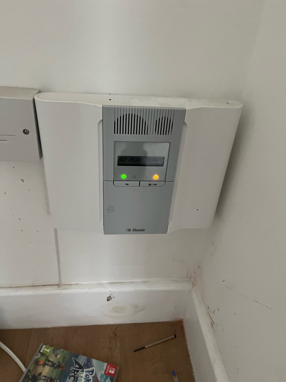

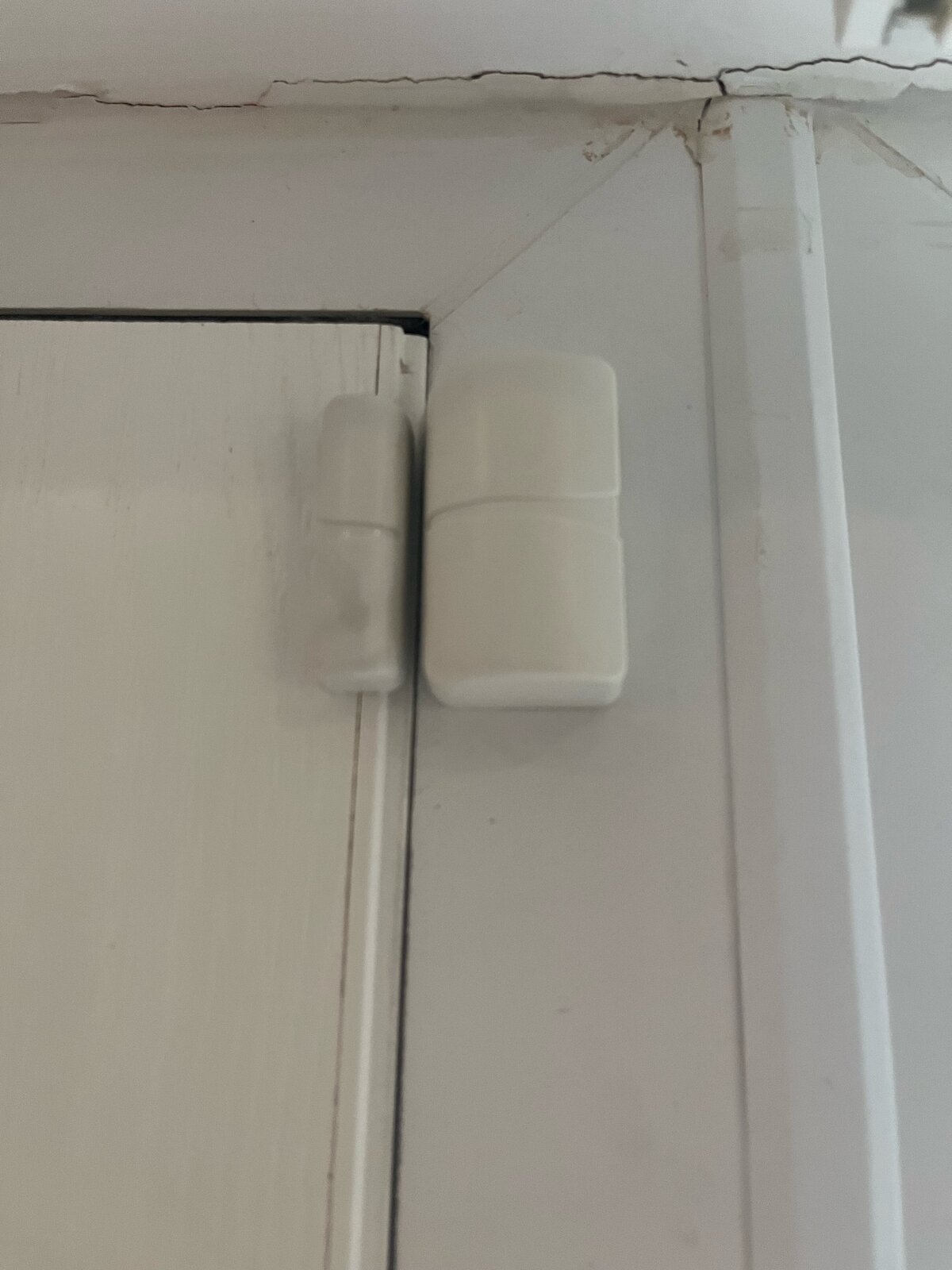

Hi,
I have a visonic alarm. A few days ago, the alarm began to annoyingly beep every minute or so and a orange light lit up on the alarm dashboard in the living room. Checking the status of the alarm, I got a "low battery front door". I removed the door contact and replaced the battery. Now I have another issue, with the alarm status now being "front door tamper alarm" and "front door tamper open". Can anyone let me know what I have to do? I attach some photos

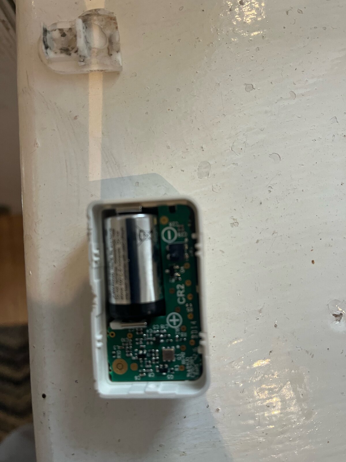

Open up contact take battery out,leave 10 sec put battery back in.Put cover back on ensuring it is correctly fitted.Reset alarm.
No luck. I've put the door contact back on, still the same problem. It is fully closed, the light is flashing red on the door contact meaning there is power. Anything else I can try?
I've tried to arm the alarm again, but I get a "disarm, not ready to arm, alarm in memory, check system for trouble". Checking status I get "tamper alarm", "tamper open"
Is there at least a way to stop the annoying beeping that comes with it, I think it returns every 4 hours
Do you have installer code ?
Google visionic trouble bleeps,video shows how to turn off,but you need installer code.
Obviously if that doesn’t resolve the issue you need to check that it has been closed properly.
