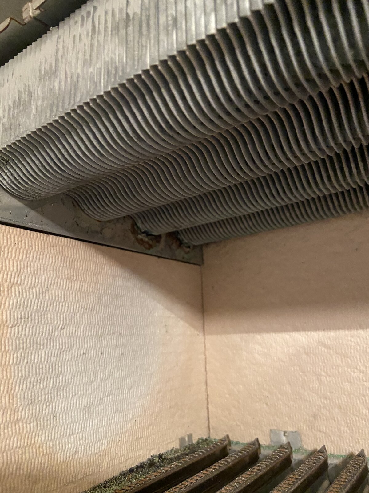

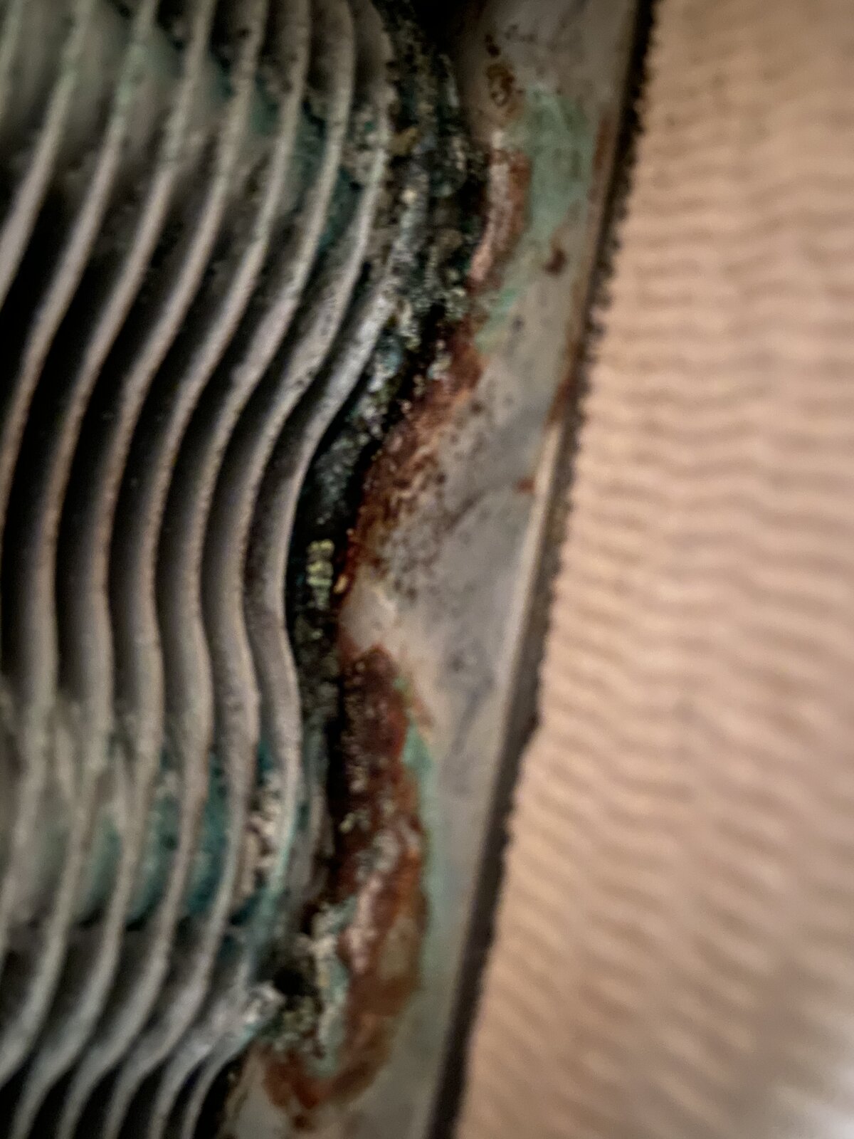

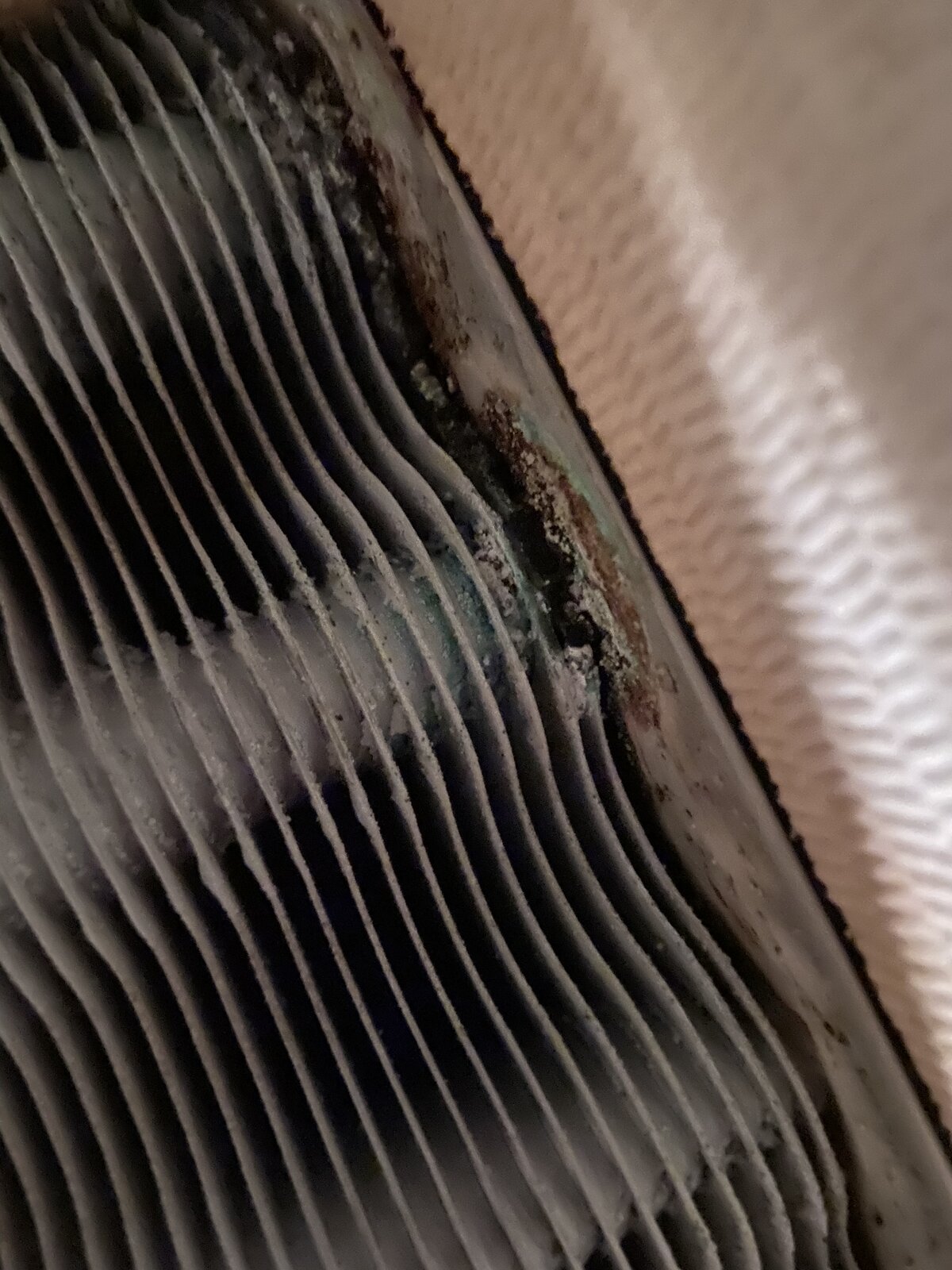

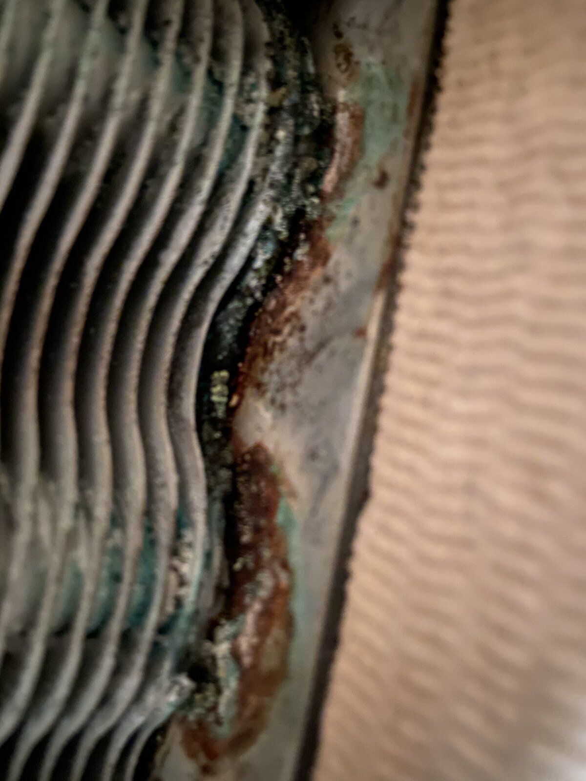

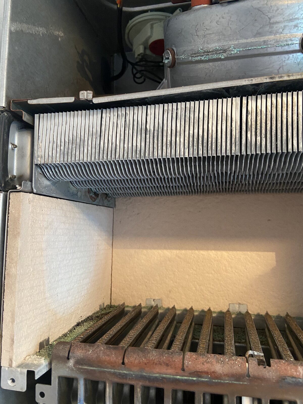

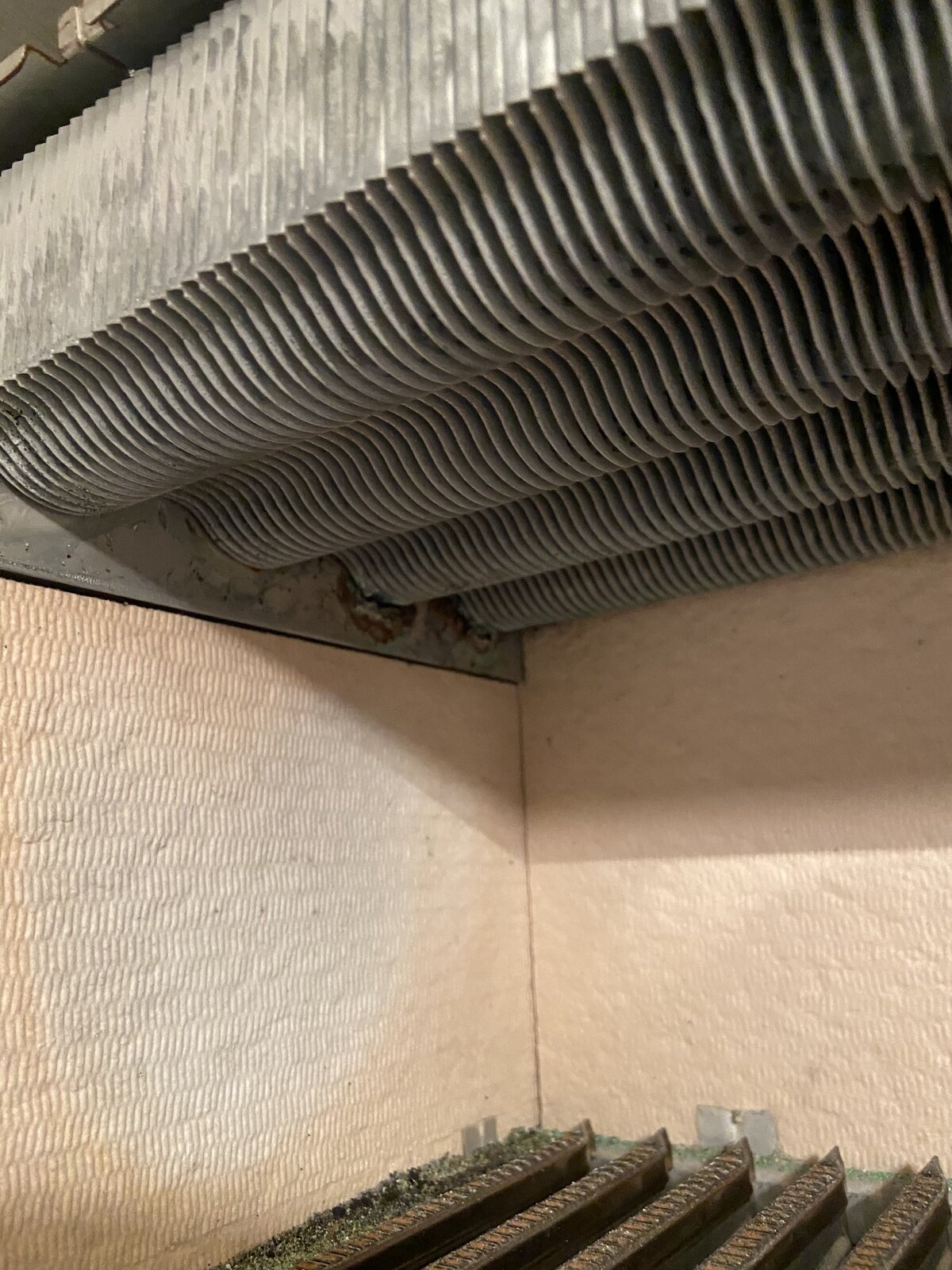

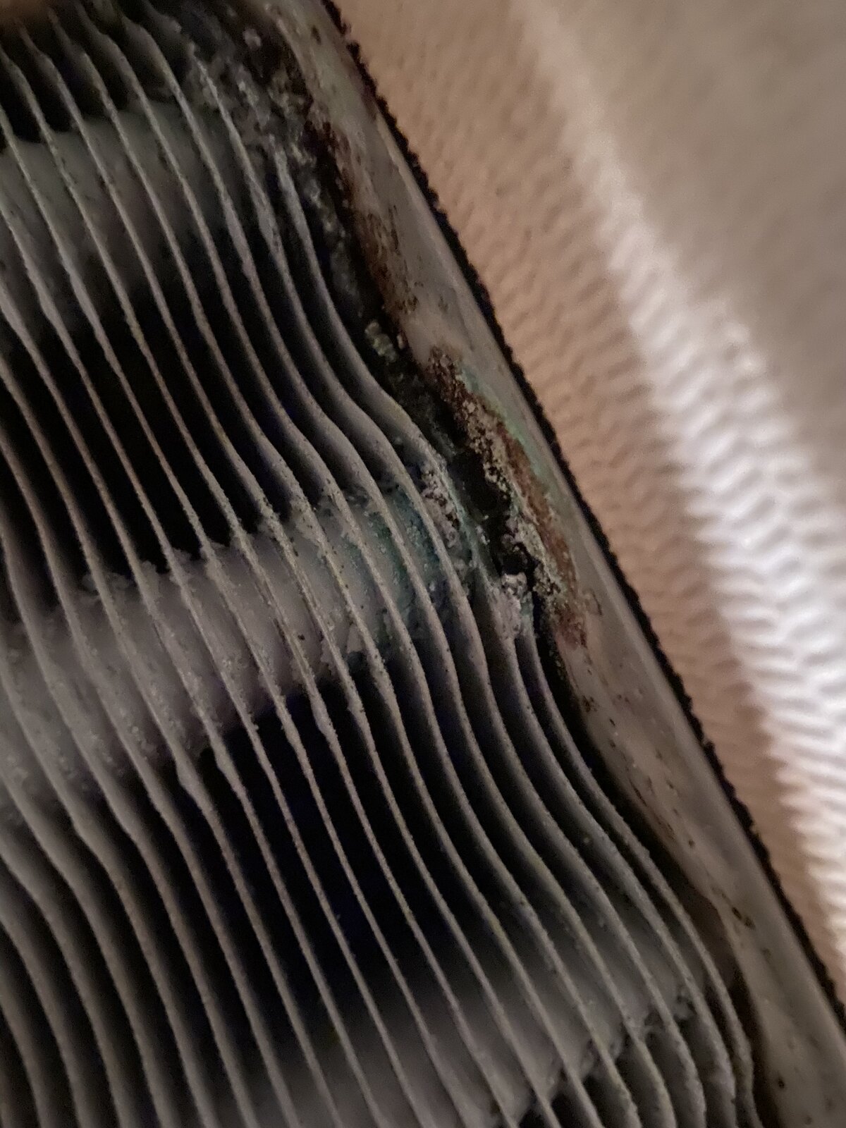

Went down under the floor this morning looking for any sign of water but nothing there either. From checking the heater exchanger this morning it seems pretty corrupt and damaged at parts. Could this be the problem?

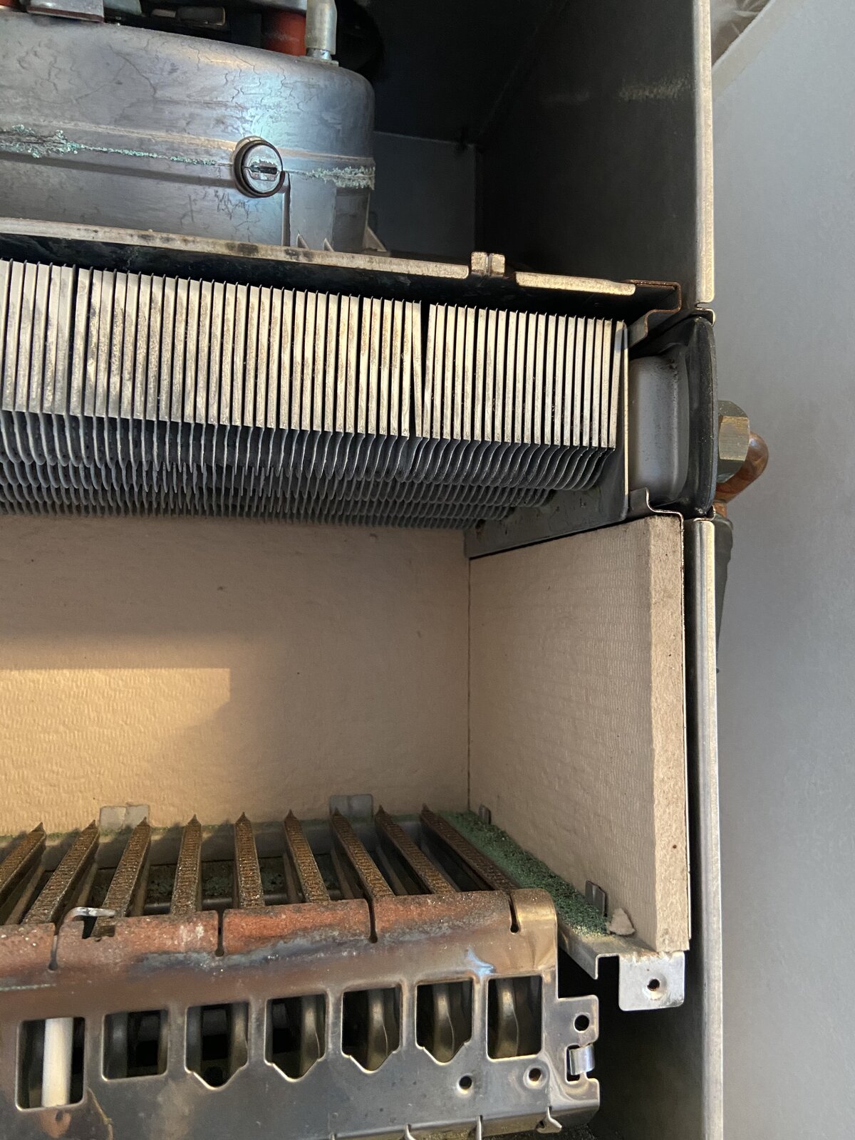

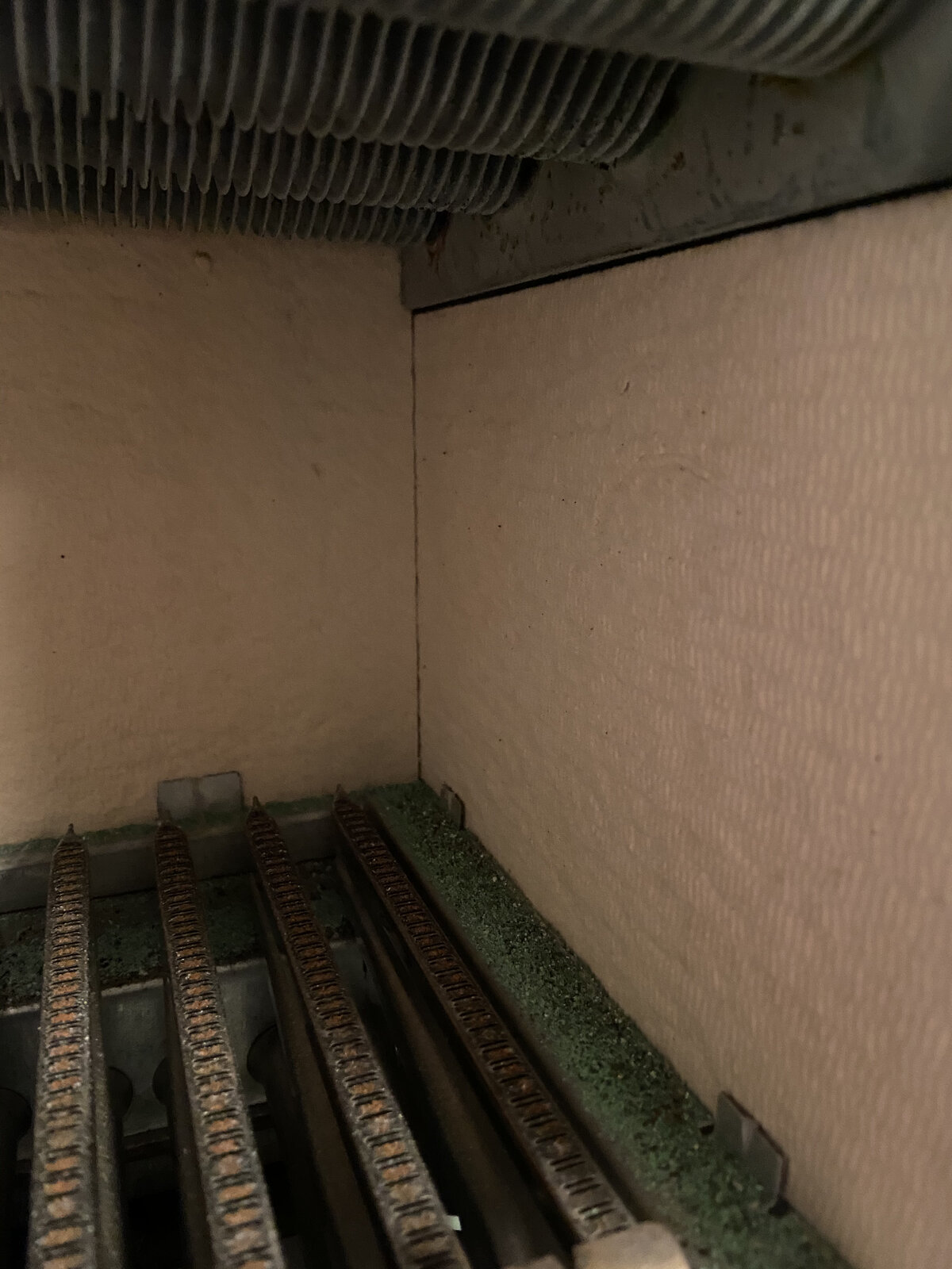

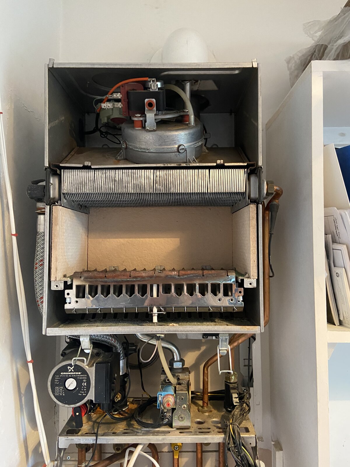

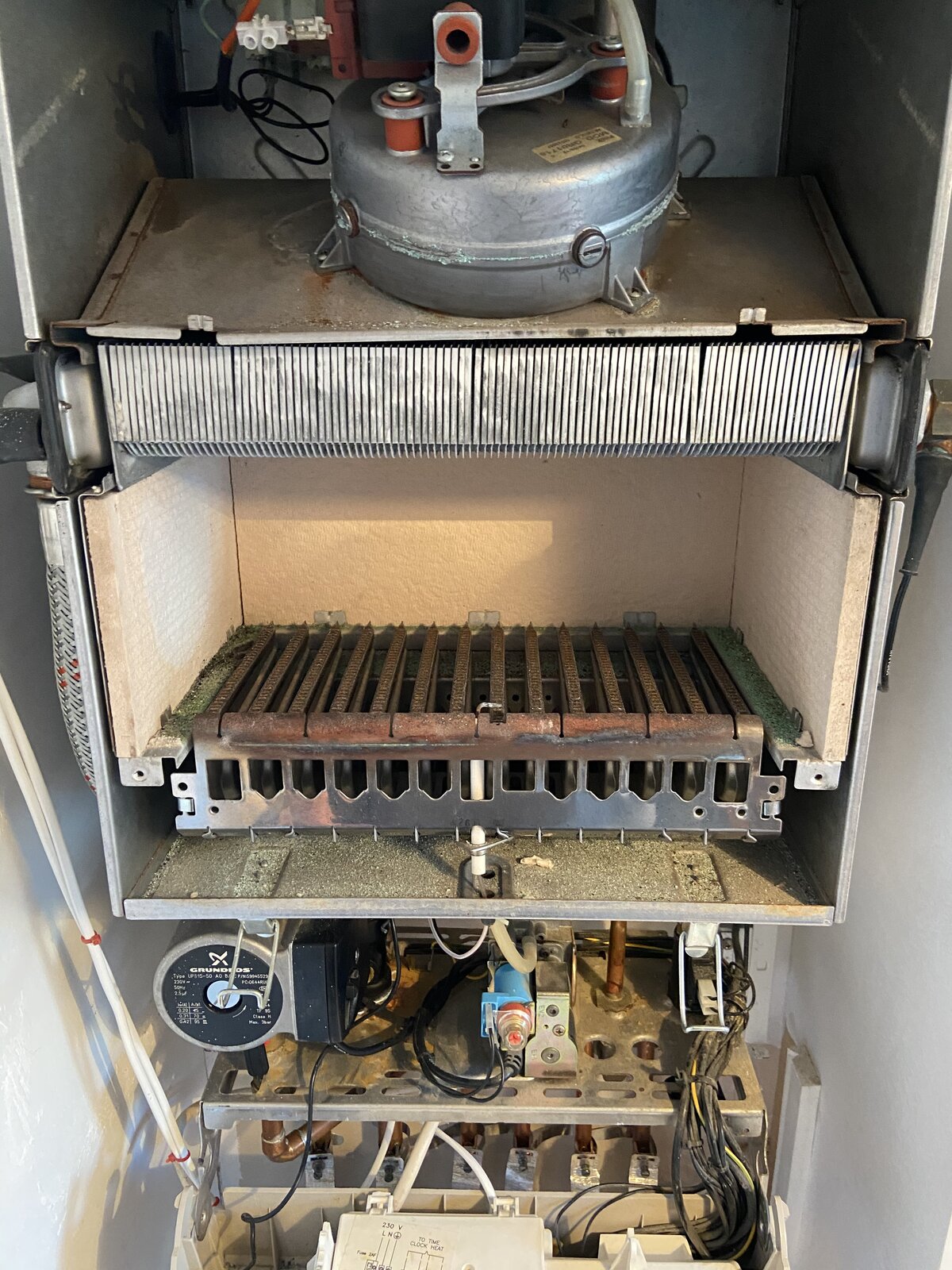

First of all you shouldnt have opened the combustion cover but too late now, the heat exxchanger could be leaking, but normally the insulation pads are a lot worse than yours post a pic from further back showing the complete inside including the bottom of the combustion chamber, there shouldnt have been any water whatsoever from the PRV what are you calling a little ?
When I say a little I mean I couldn’t see any water in the bag but could just about barely feel a drop in it. Maybe just condensation?

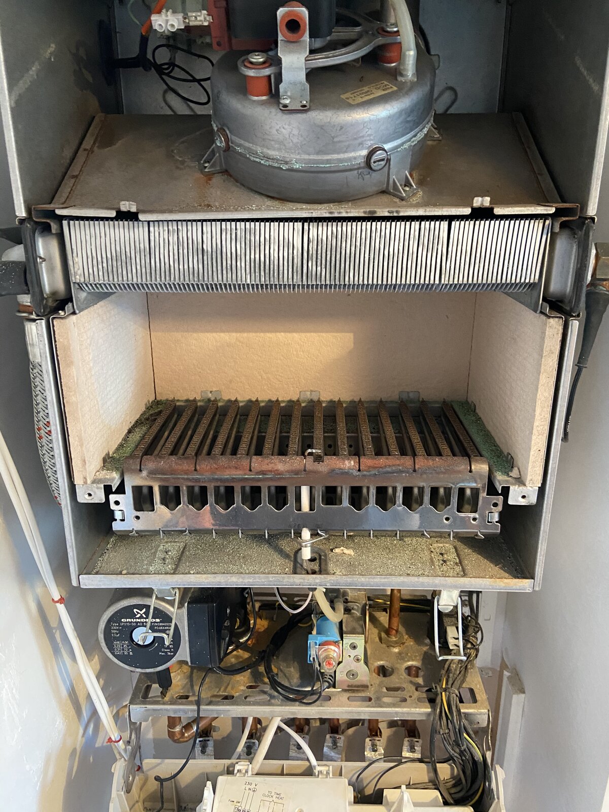

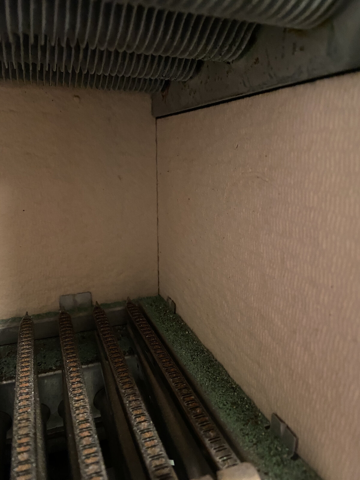

didn’t realise I shouldn’t have opened it but it’s closed now and here’s a couple of pictures I took

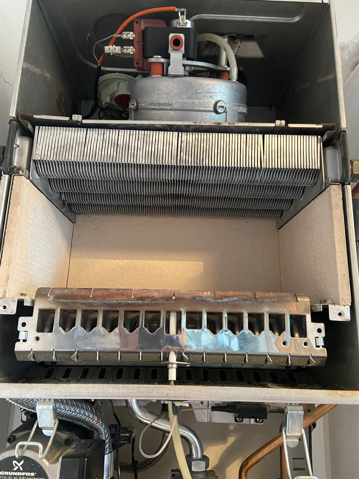

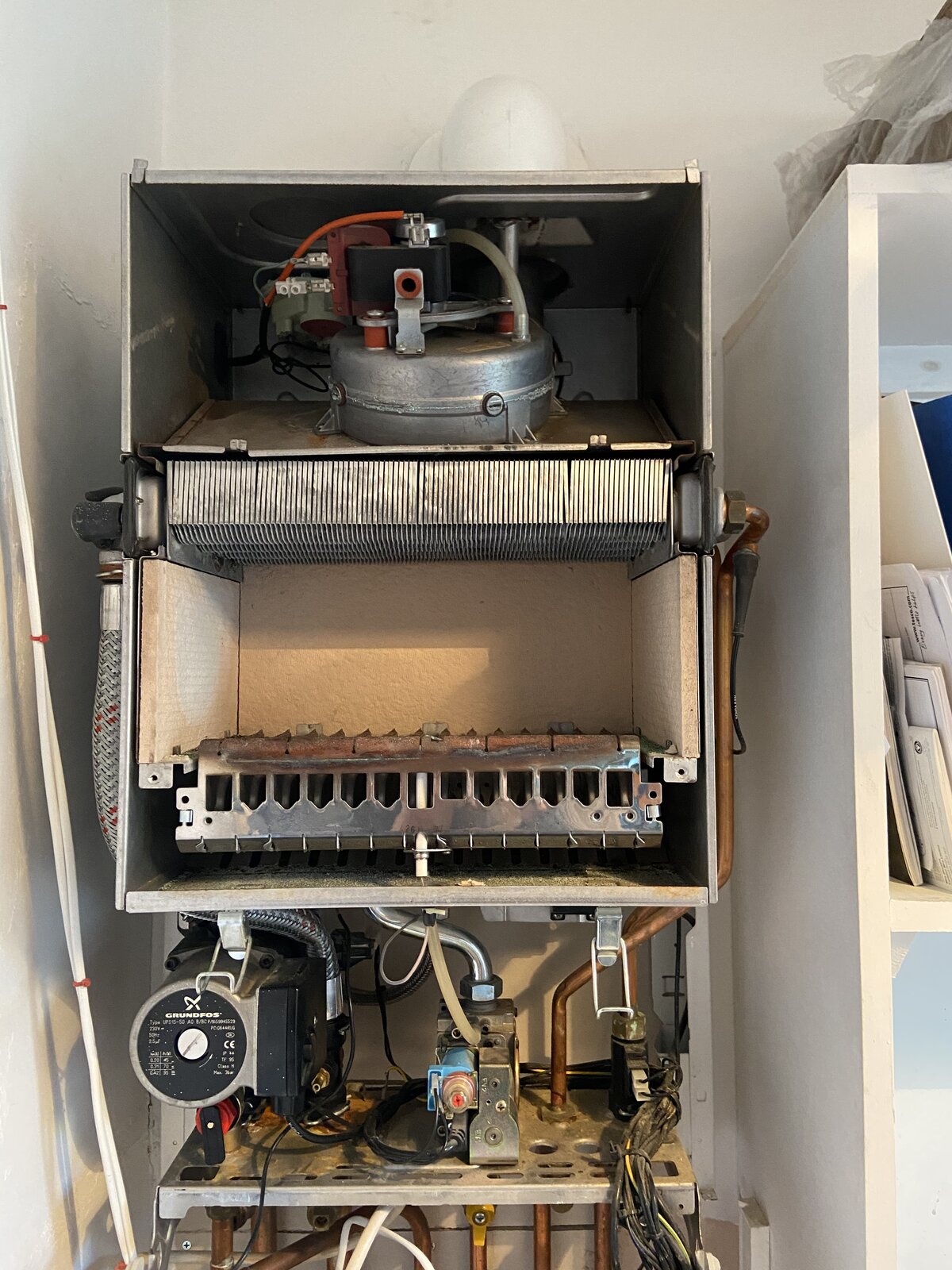

wanted to see the bottom of the combustion chamber, dont think your heat exchanger is leaking but it could be, normally I would expect to see a lot more damage if it was

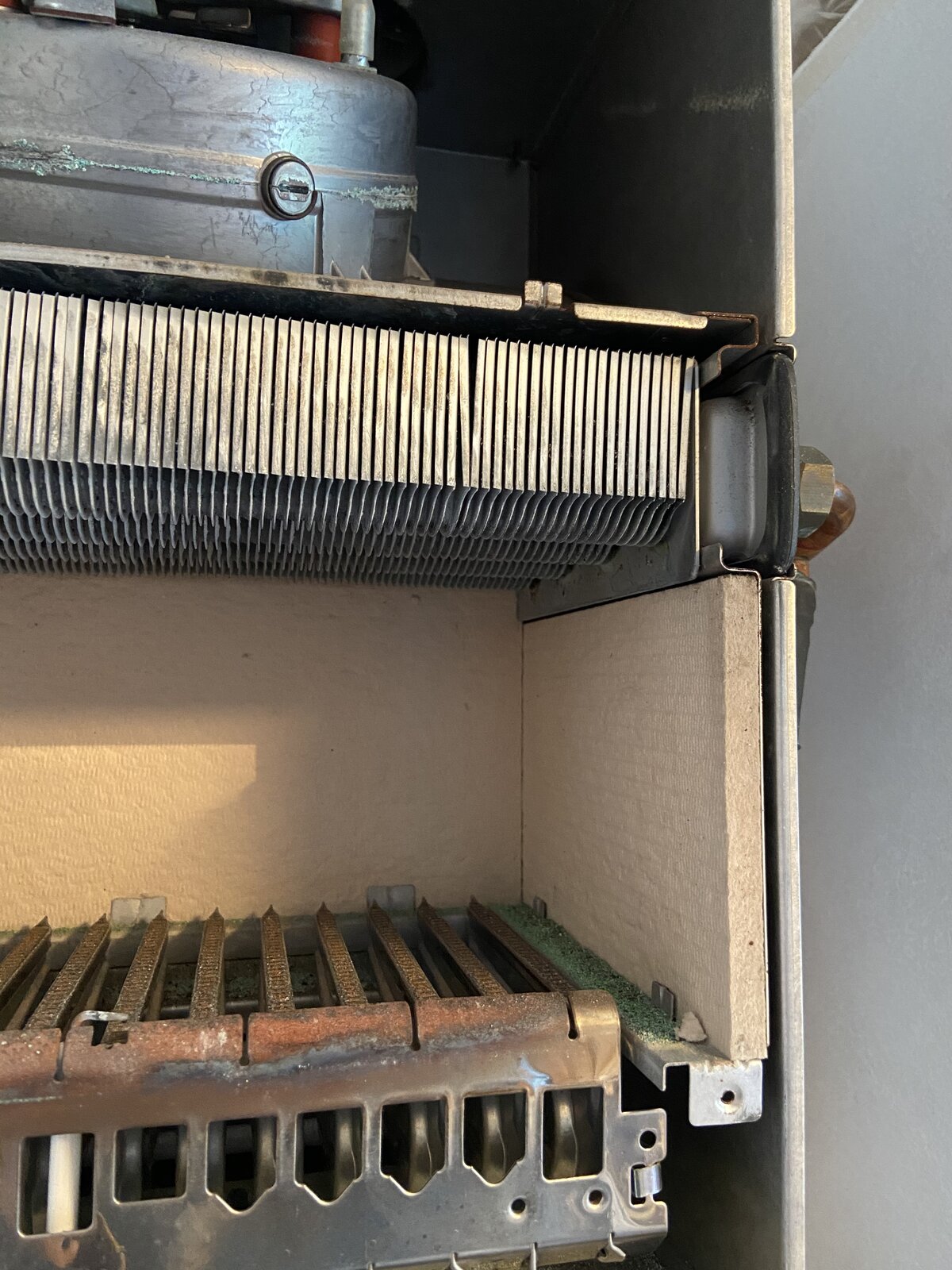

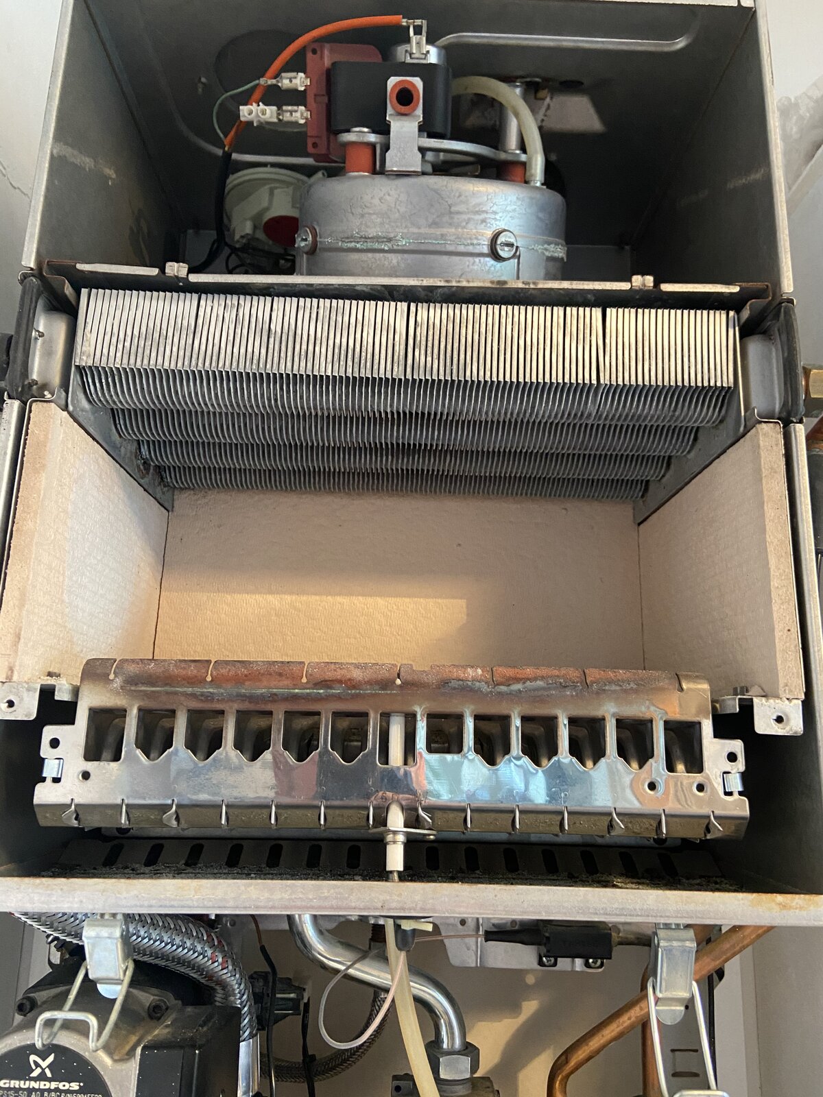

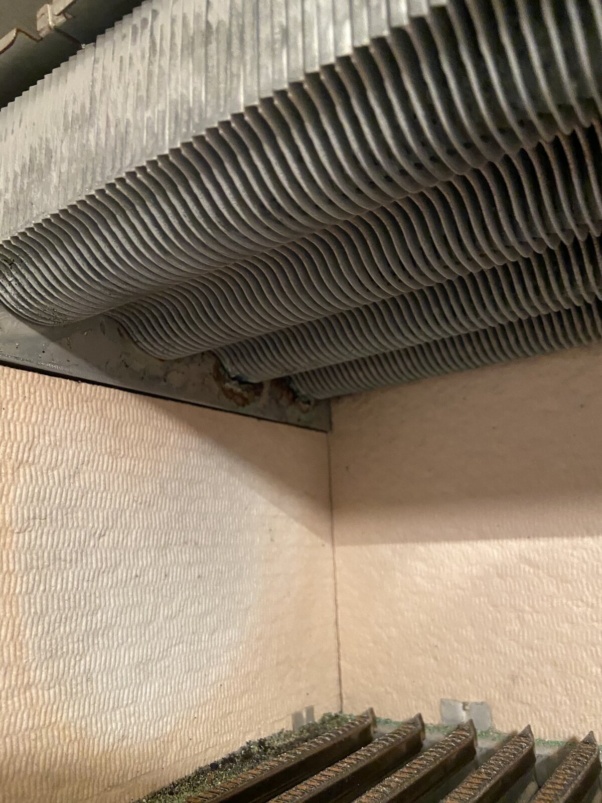

Found these other pictures.
Can’t find any water near the boiler anywhere but whenever I fill it it’s rapidly going down! Tried going round all my radiators with some tissue to look for water but nothing showing up

Vokera make many boilers and call them all compacts for some infuriating reason, for future ref yours is a compact standard efficiency, with a Bi_thermal heat exchanger, which looks as if it has been replaced, doesnt look like the boiler is the source of your leak
