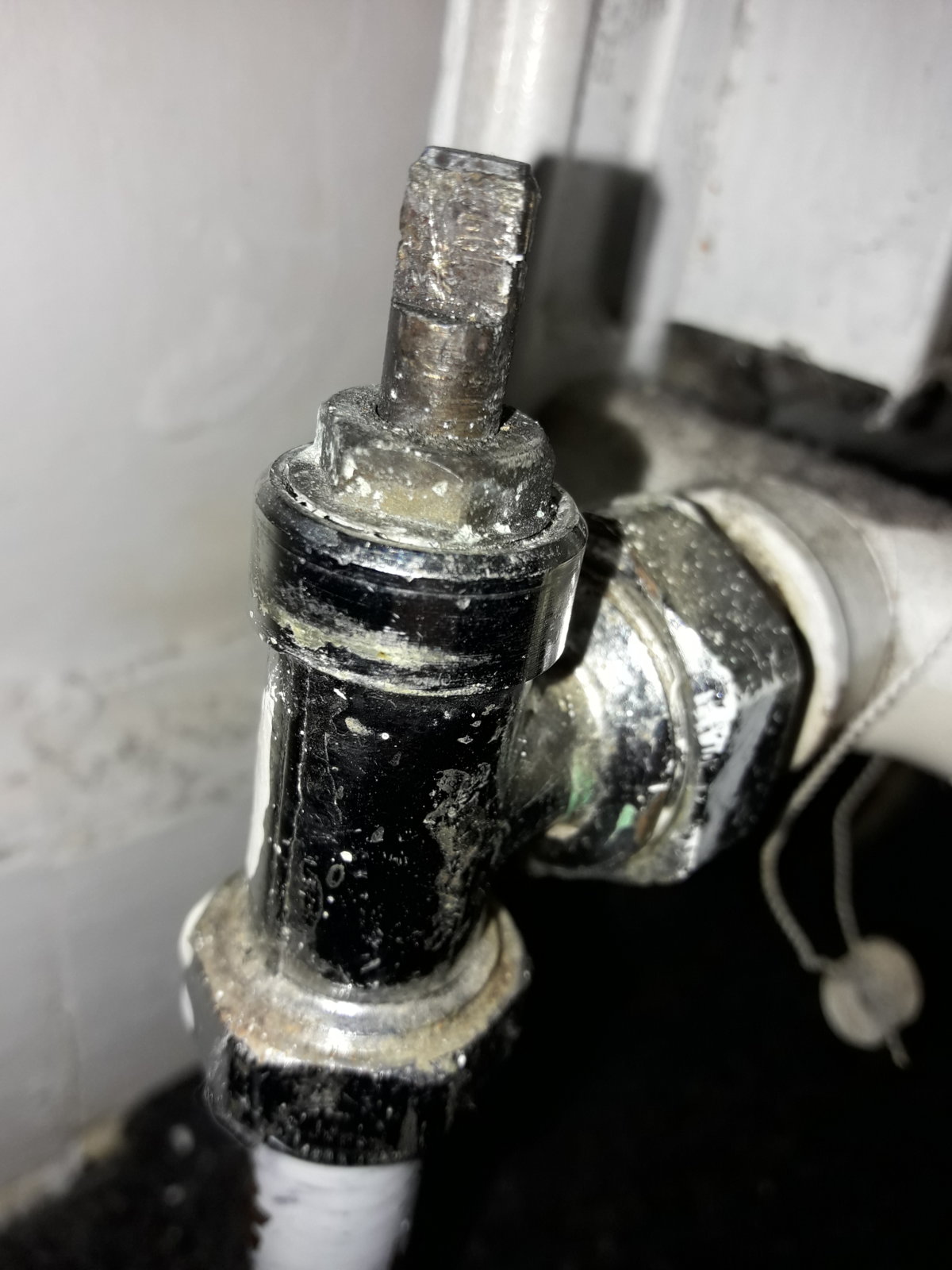

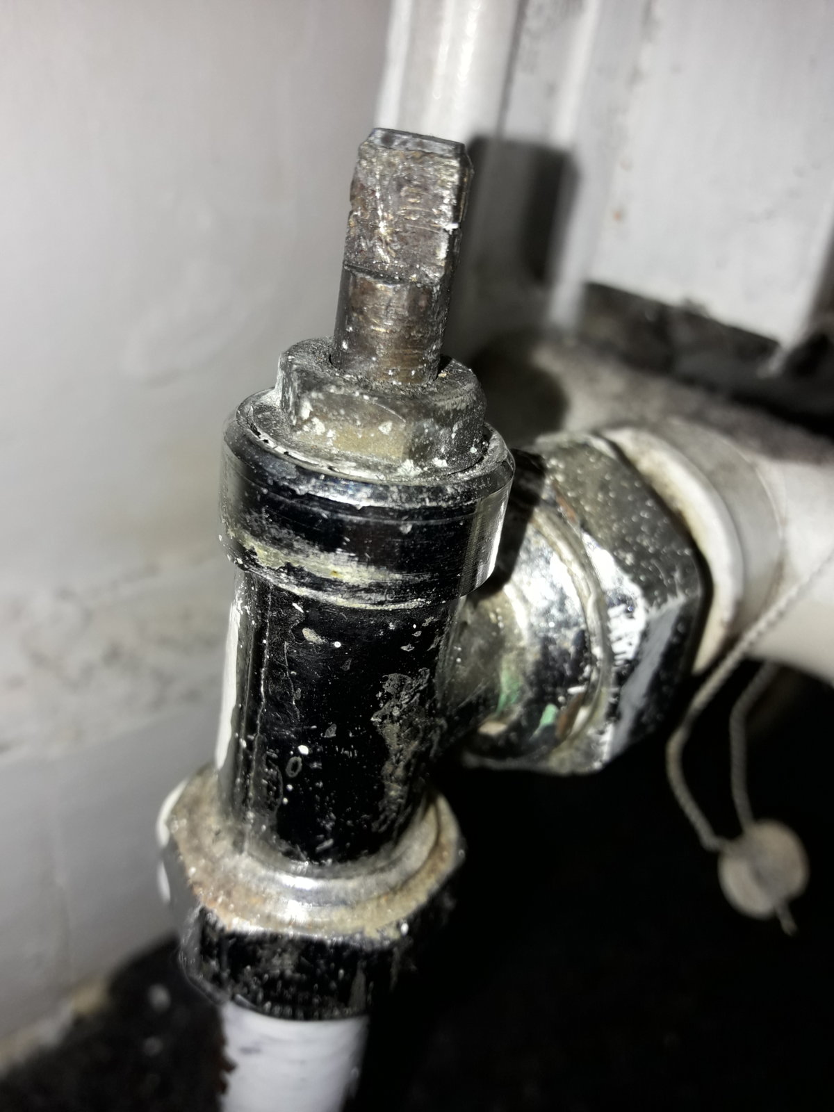

Thanks I also noticed little kind of condensation drops at the top inside of this white cap I took off radiator bolt, is this normal. see pics, you can see the water if you look closely inside cap. Can I also ask which direction I turn the bolts on this to tighten them? ie clockwise or anticlock wise? thanks

Radiator bolts? Do you mean valves?
Can't see why there'd be condensation inside the caps! Leave caps off and dry the valves with tissue. If they get wet again, there could be a weep from the valve but it's usually pretty obvious and would have to be extensive to drop your system pressure over a short space of time.
One of those caps looks like a decorator cap for a TRV head! Can you post a photo of the valve that this cap came off? And its better to upload photos directly to your post on this forum. Just click the "upload a file" button.

"One of those caps looks like a decorator cap for a TRV head! Can you post a photo of the valve that this cap came off?"
Here is a photo of the valve that this cap came off.
nope that is a lockshield valve and you wouldnt need a decorators cap for that, and where did you put the freezer bag on the inside ???? if you cant get to the outlet you will either have to cut the pipe inside or disconnect from the boiler
