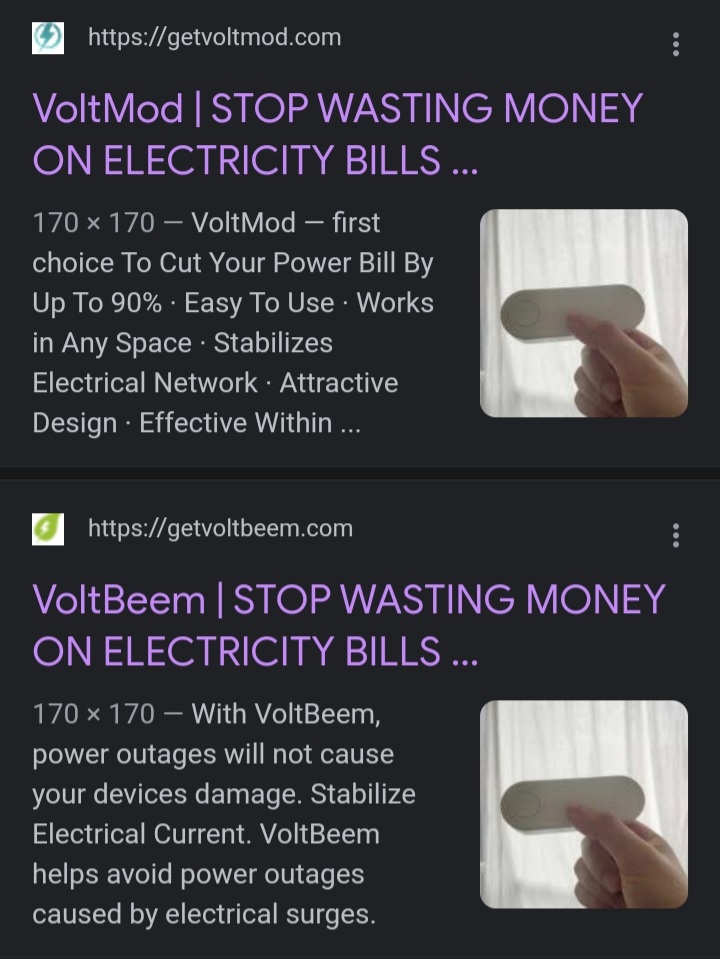

Ok....

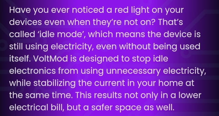

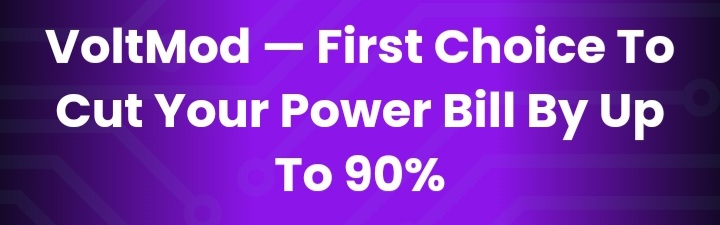

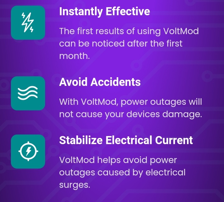

I had a bit of a delve into their websites - and I say websites:
I will let you make the decision whether they are legit or not...
Let's start with their claims:
Seems good to me!

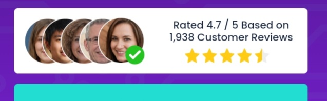

Let's have a quick look at the reviews:
4.7/5 based on 1938 reviews - impressive!
Funny how the banner isn't clickable, and those numbers are hard coded into the HTML:
It's almost as if those numbers are made up????

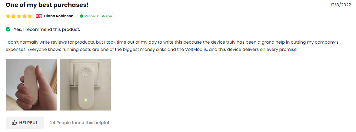

Now onto the reviews themselves.
Funny how there have been 1938 reviews, but the review section only includes three.

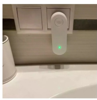

Funny how the British reviewers have very un-British sockets:
There's a very useful button below the reviews to register whether the review was helpful. When you click the button, your choice is registered.
Funny how when you click refresh, the number of helpful reviews reverts back to 24, 18 and 15.
It's almost as if these numbers were hard coded into the HTML:

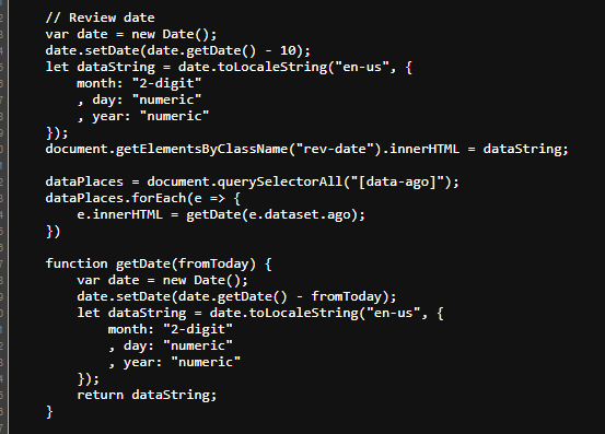

But it is good that these reviews have recent dates, it couldn't be that there is a bit of code to change the dates of the reviews, depending on the date you visit the website:
Where data-ago = 4, 6, or 7
Again, I will leave you to make your own opinion on the legitimacy of this product! :ROFLMAO:
