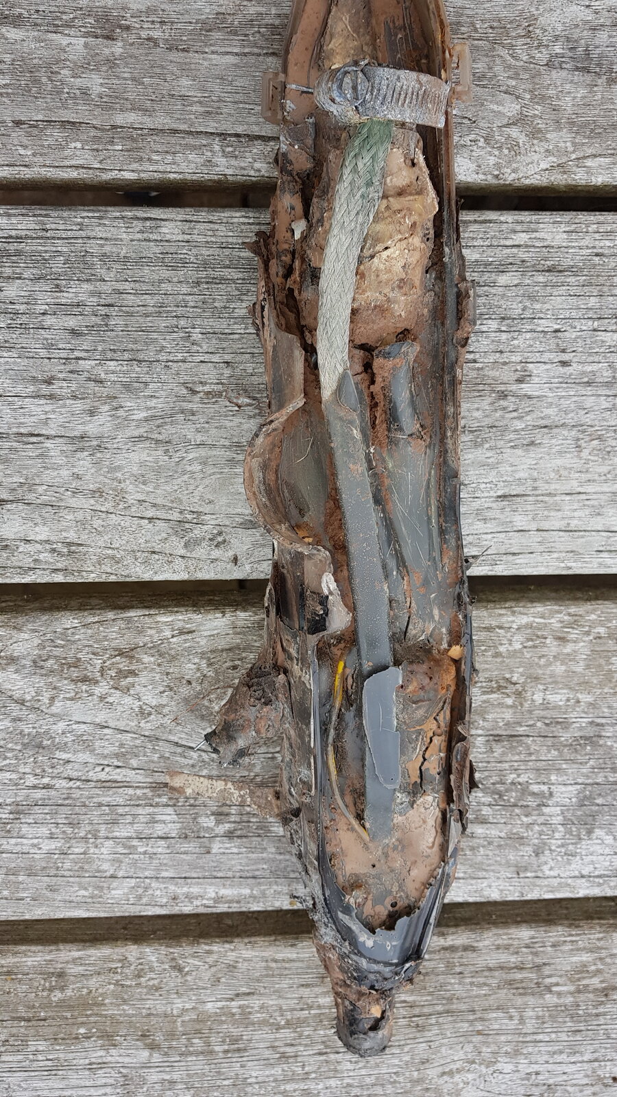

Pic 1. As it was when it came out of ground. Notice cracked resin bottom left and soil around main connector

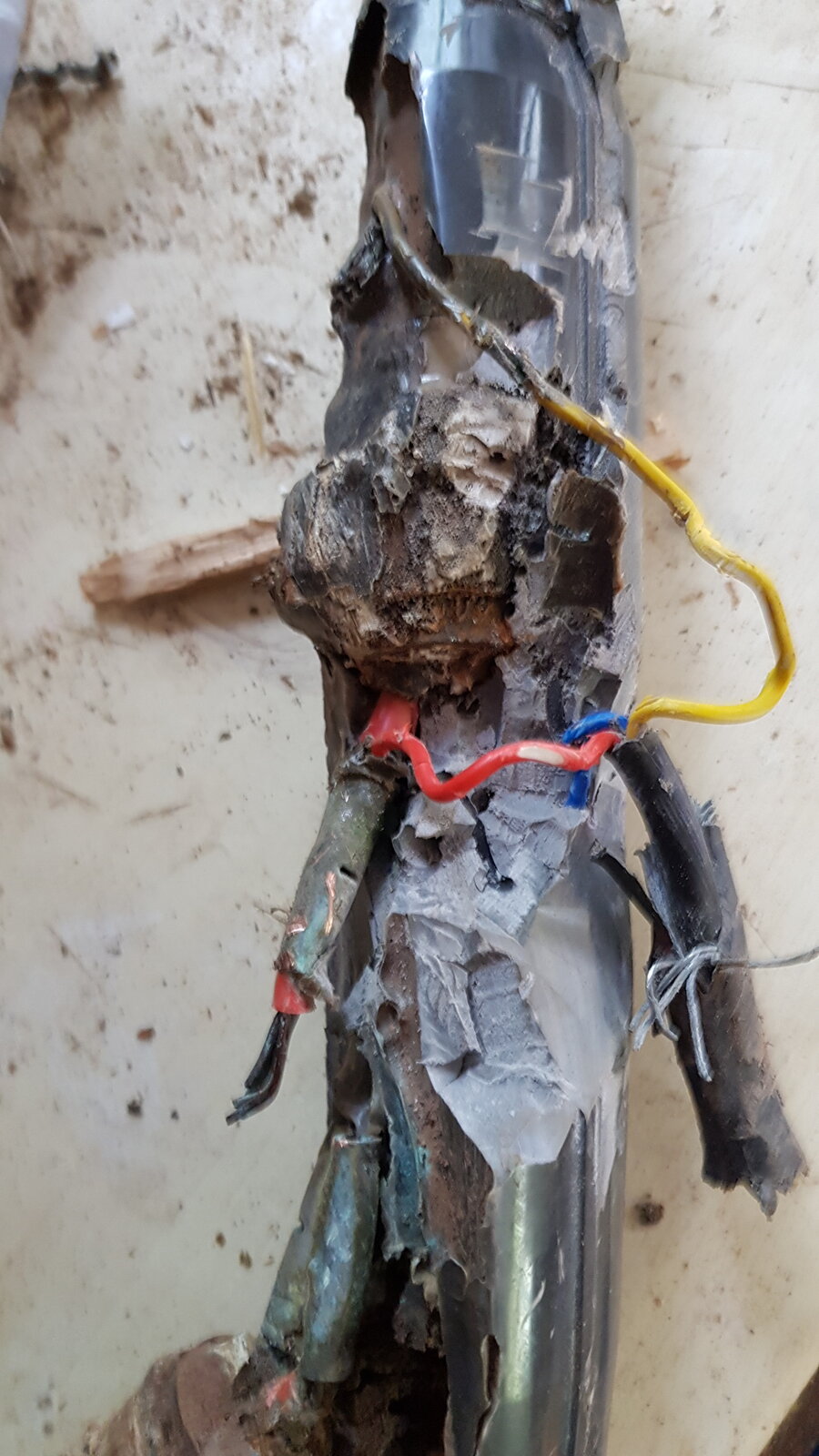

And then lifted the supply ...note soil and bare conductors.
I have been using a 2.5 Kw log splitter from that spur! I had assumed that the cable size in the shed was the same 16mm as in the pump house. Never bothered to look. Amazing it lasted that long...and I am still breathing.
So unfortunately noe need to hire cat4 detector to find the junction into the garage. If same techniques used...will have to fix and then replace entire cable run. All thanks to the cowboyscwho bodged this! Thanks for all your help.

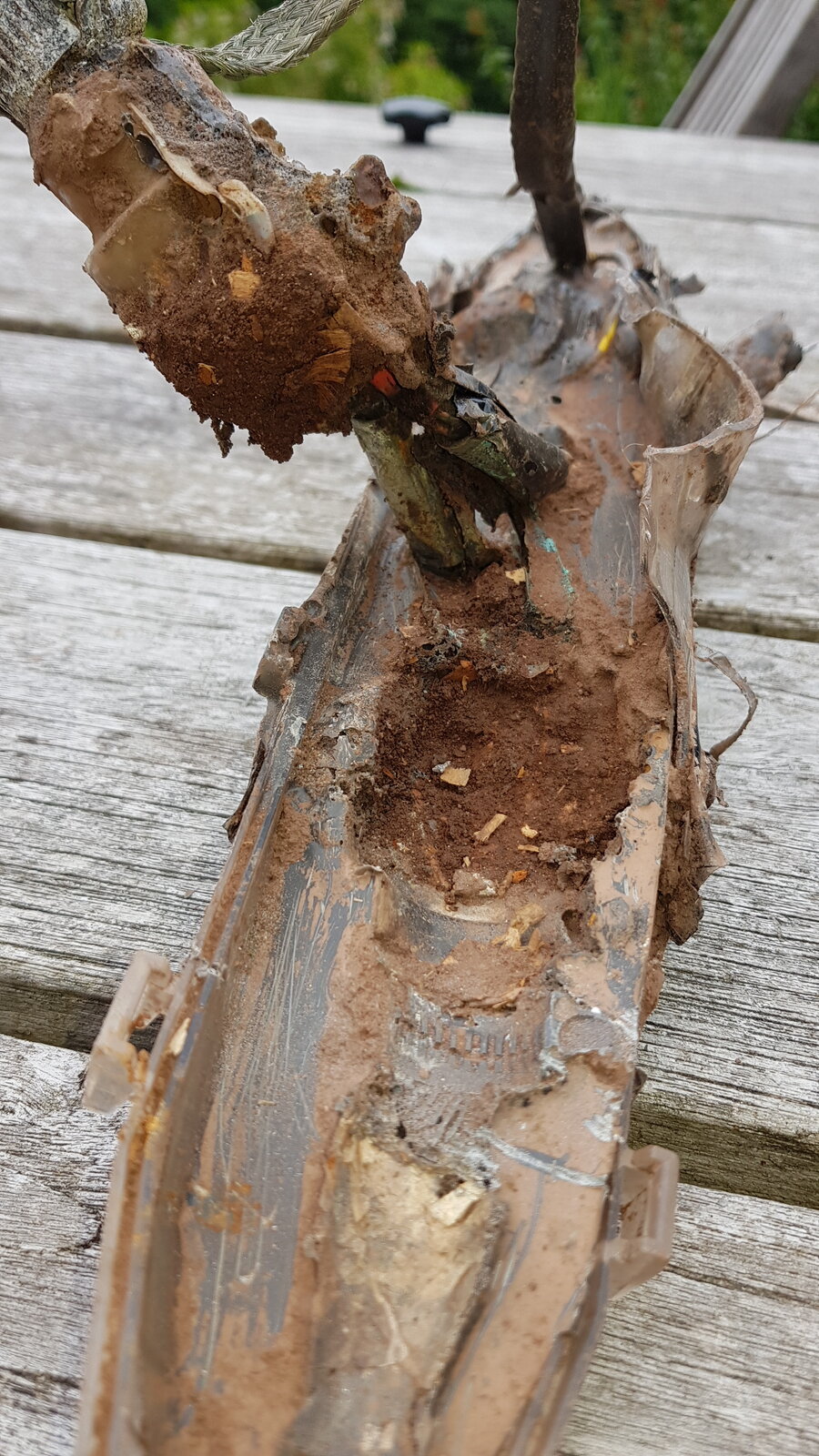

It looks as if they ran out of resin part way through making the joints. The plastic is only intended to make a former, to contain the resin which is poured into the joint.
Harry, the resin ran straight out of the hole they cut in the plastic case to take the spur. There was a massive blob of it on the underside of the joint. It was never going to last!
