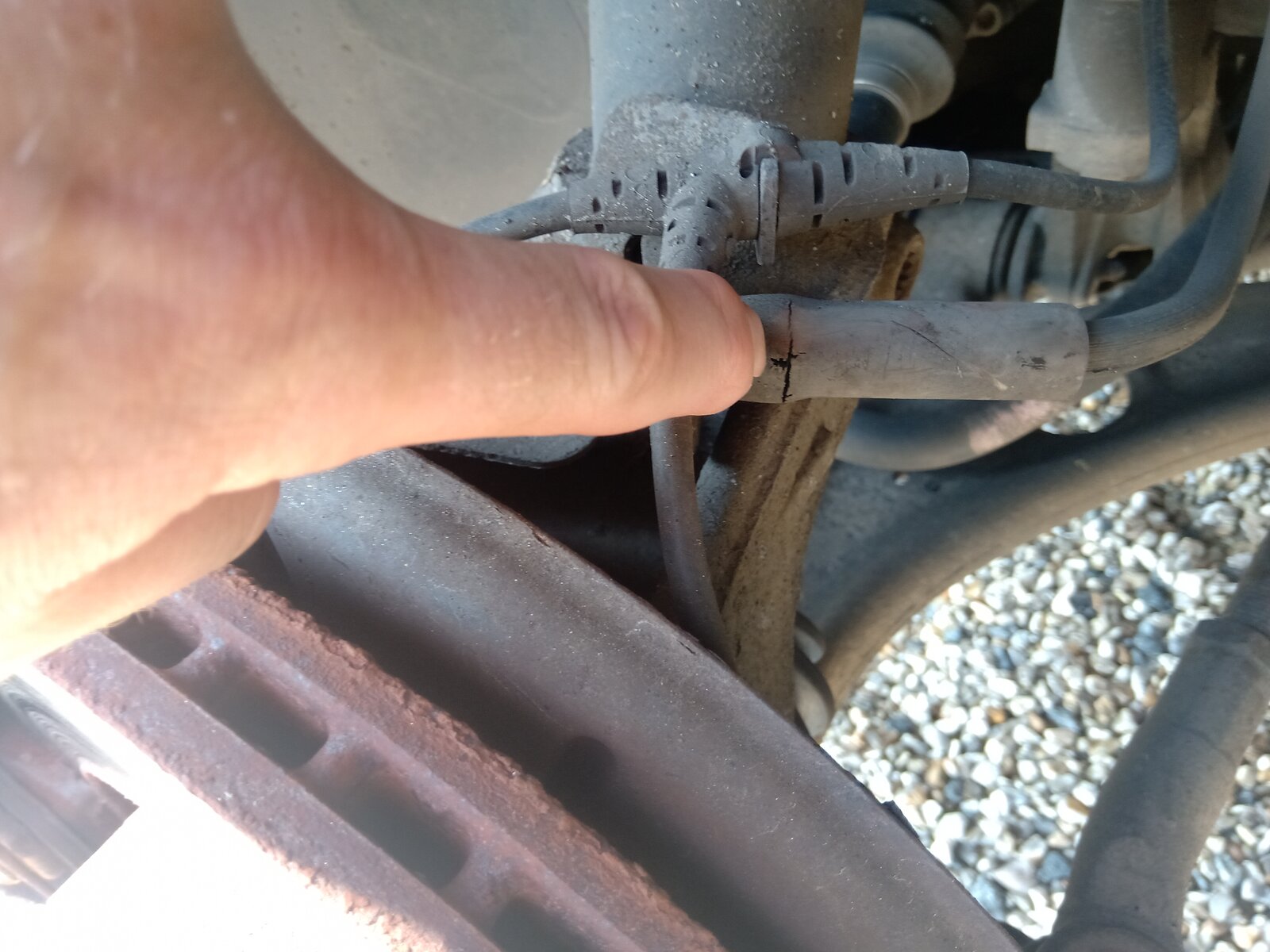

I took the wheel off. The calipers seem tight on. I've spotted a split in a hose, I'll try and attach a picture to see if anyone reckons it's that.
No sign of fluid getting out though.

If the hose was leaking fluid the brake pedal would hit the floor sharpish.
We are looking at the hose protector rather than the hose itself, but can I see damage just to the right of it?

The pedal dropped to about halfway and then the vehicle came to a stop - sort of! How typical that is I don't know but I can still bleed brakes with the foot pedal if it's done smoothly.
Maybe there's a shuttle valve somewhere that shuts if the pressure drops suddenly - I wouldn't know.

Yes, that's what should happen with a dual circuit system. Different manufacturers split them different ways, so a common way is front right and rear left on one circuit, front left and rear right on the other. Some are split front-rear. On cars with calipers that have multiple pistons, they can sometimes split so that (say) one rear brake and one pair of caliper pistons on each front brake form one circuit and the other rear brake and other two pistons on each front brake form the other.
Inside the master cylinder is a floating piston for one circuit and a piston directly connected to the pedal for the other circuit:
Hence, the extra travel when one circuit fails.
So I got it done at the garage. Firstly the fella green flag sent had zero tools with him. I thought they were supposed to try and fix things.
One caliper, front pads plus labour £231.
