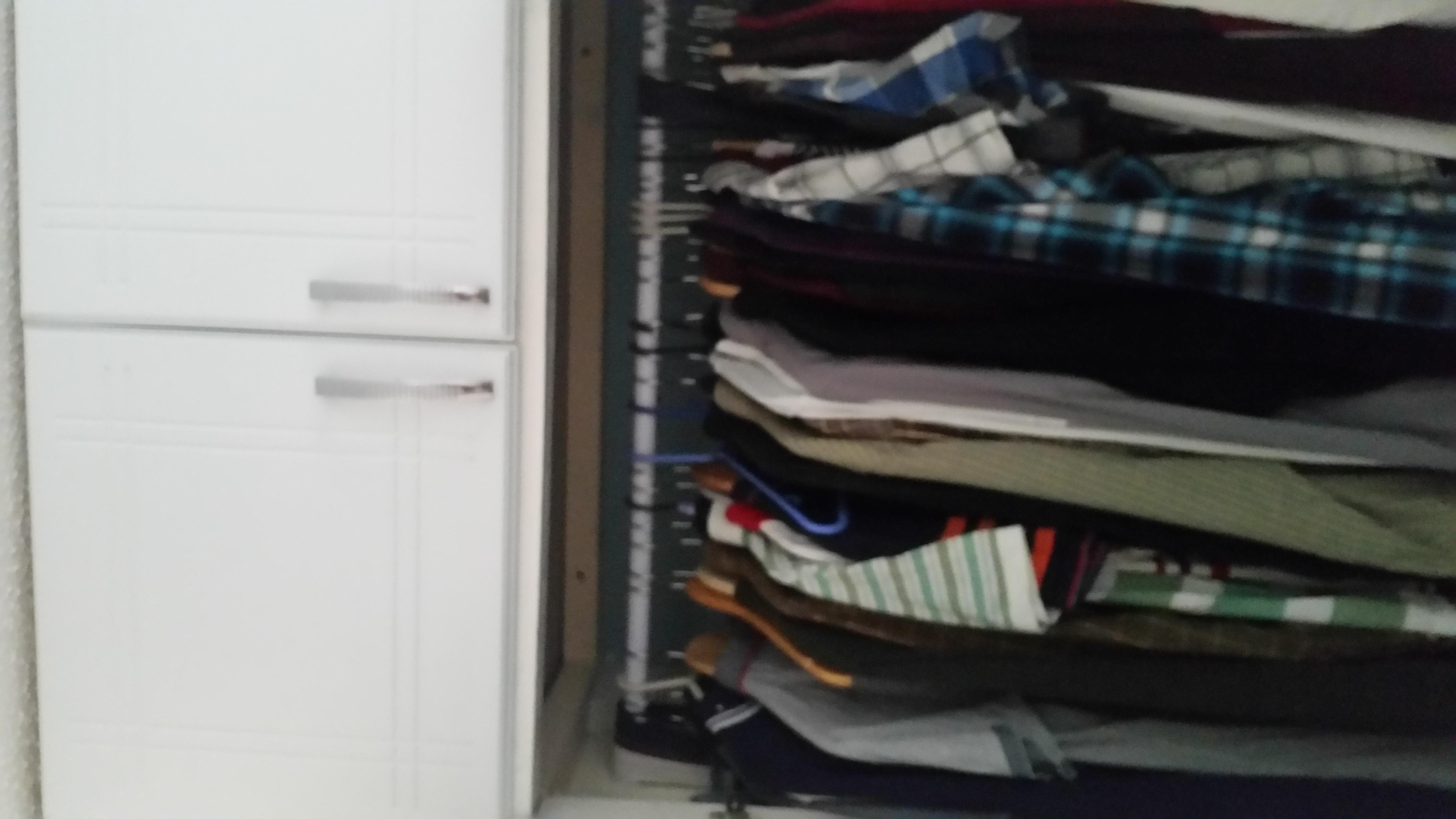

I made them going over my bed, double wardrobes each side with cupboards right the way across the top. I started by using 3x2 CLS timber for the framework then 18mm mdf for the doors and section at the side and over the bed. Fitted mirrors to the 4 large doors, routered a pattern and sprayed it all with 2k paint and lacquer.
The rail mountings I used fits directly to the wall on one end and the other end to the mdf
