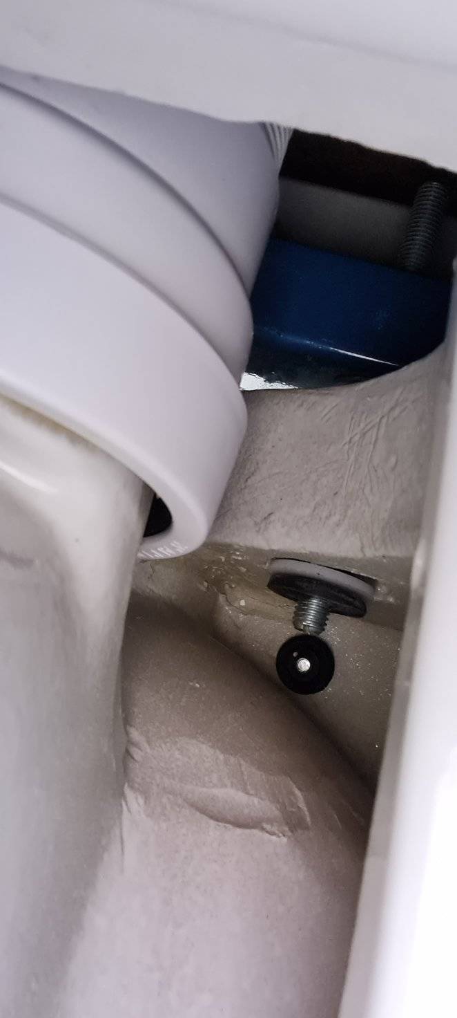

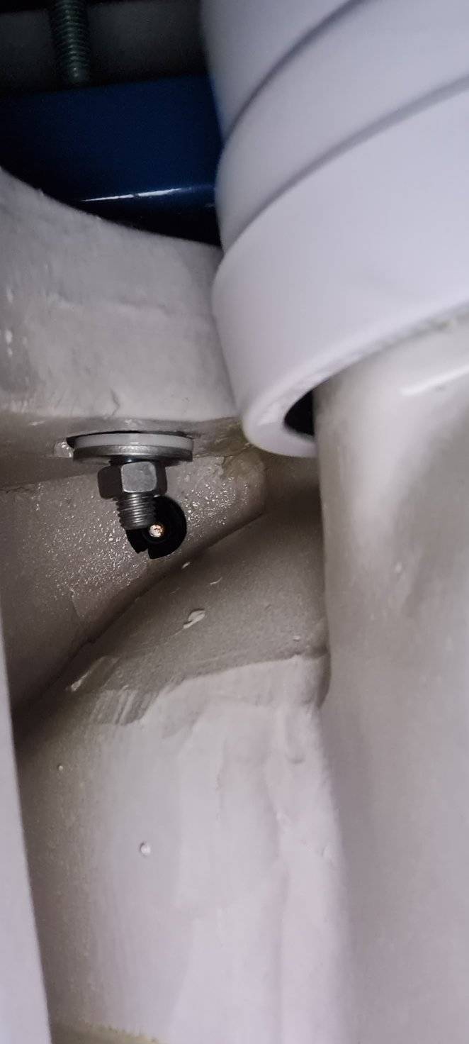

other than that plastic cover over the rubber sleeve there isnt anything else to protect the toilet from cracking but that mustbe enough. I wonder if what you have in that picture would work as the hole in the toilet which the bolt passes through is quite a bit bigger than the bolt

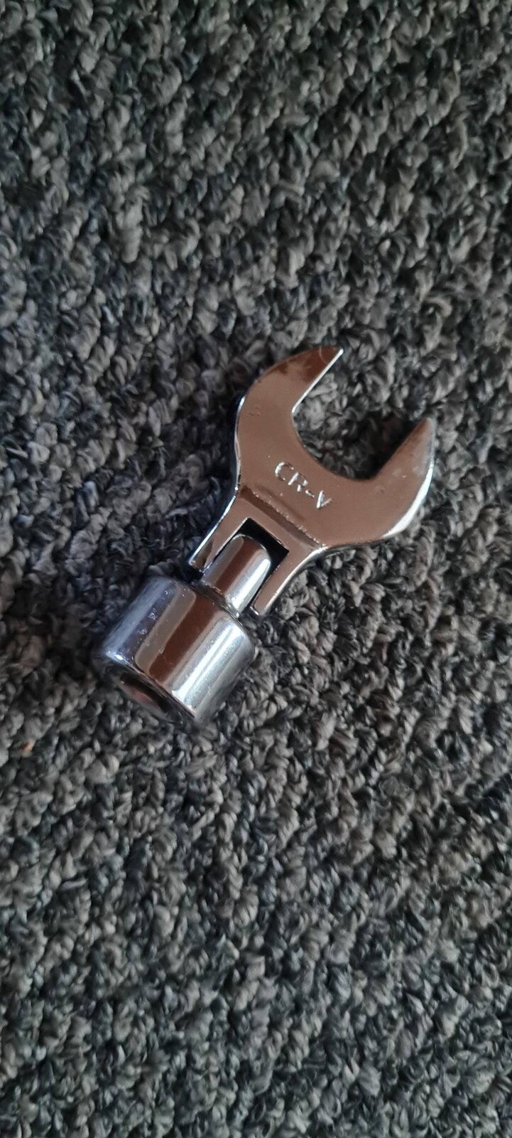

I dont mind trying a few things to see if that work, my main issue is getting to the nut underneath undoing it and tightening up.

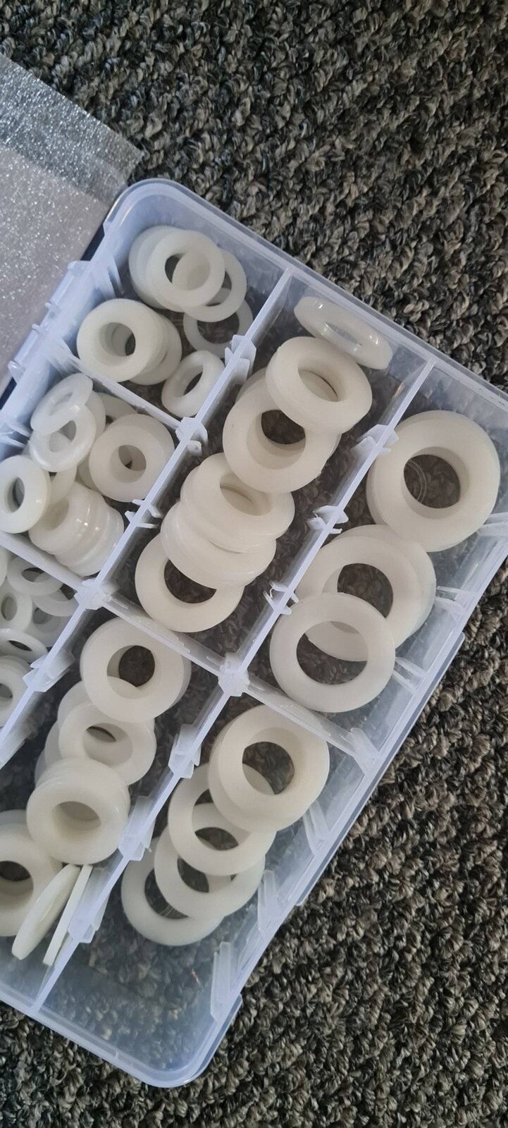

I have the sleeve and the metal washer , would you suggest something like a large nylon washer, they sell kits on amazon which may give my some chance of matching one that fits
such as this
nylon washers
would nylon be strong enough? stronger than rubber so it would look like this (red) being the washers?
Is the toilet not open at the bottom to give access to the rods and nuts?

I would use a sleeve to protect and fit tight into the holes of the pan, then nice thick wide nylon washers then a steel washer then the nut.

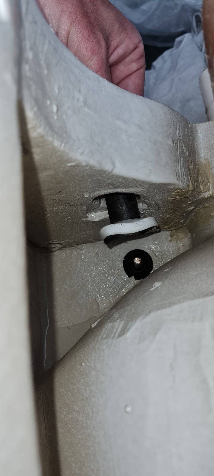

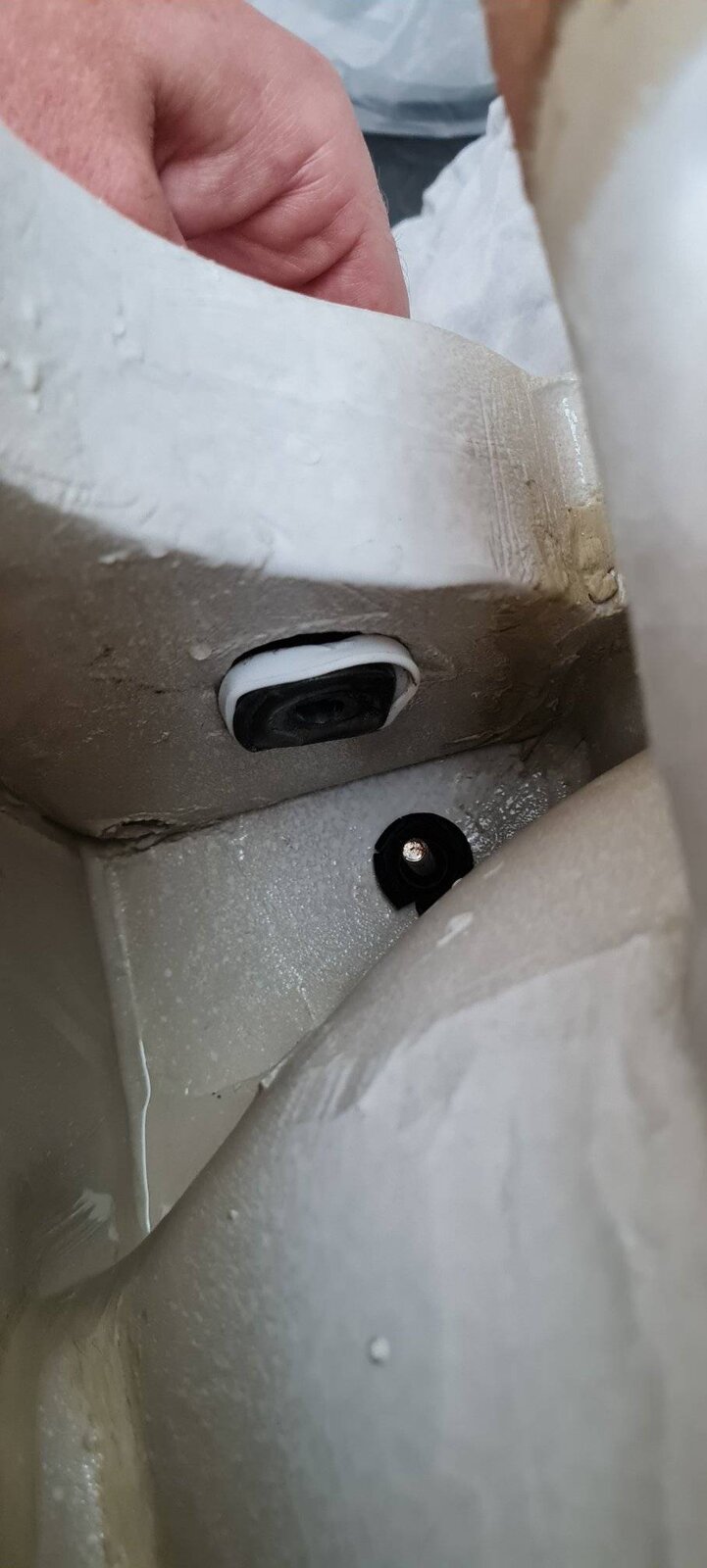

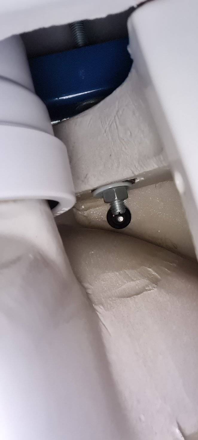

me and the missus gave it another go today after i filled in the cracks and then painted it, not sure whats wrong with it, we have gone through trying to use so many tools and the only thing thats worked is a head of spanner and no bar on it. just seems a awful design.
we tried washer then the rubber collar then another washer, then the metal washer then the nut, i cant get my hand in there too big, missus has used that spanner head to tighten it and its not wobbling etc and then did a test sit down and wall broke again. its as it needs something else at the bottom to brace the weight of when someone is on there.
going to order the fisher ones and then try to see if they make any difference or make it easier, the access is a problem, really poor design
Also the hole where the rods fit through havent really got any sort of designed recess for the washers, so when offered up they dont sit cleanly on if that makes sense.
open to anymore suggestions, fed up :)

Did you use long reach spanners? The sleeve should hold the rod so any washers used should sit centralised unless the sleeves aren't right.
As suggested though, if the access is that bad and you cant get your hands and tools in properly then the fischer fittings, or similar, may be what you need to use, you should be able to get the allan key into them from below I would think.

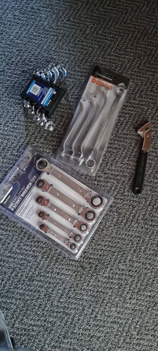

yeah used long reach and the angle is such it can just about get on the nut but even a movement to the left or right. I've ordered a Short stubby ratchet spanner and also re ordered the fischer fittings to see if they help.

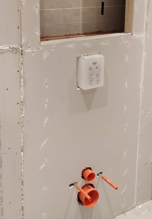

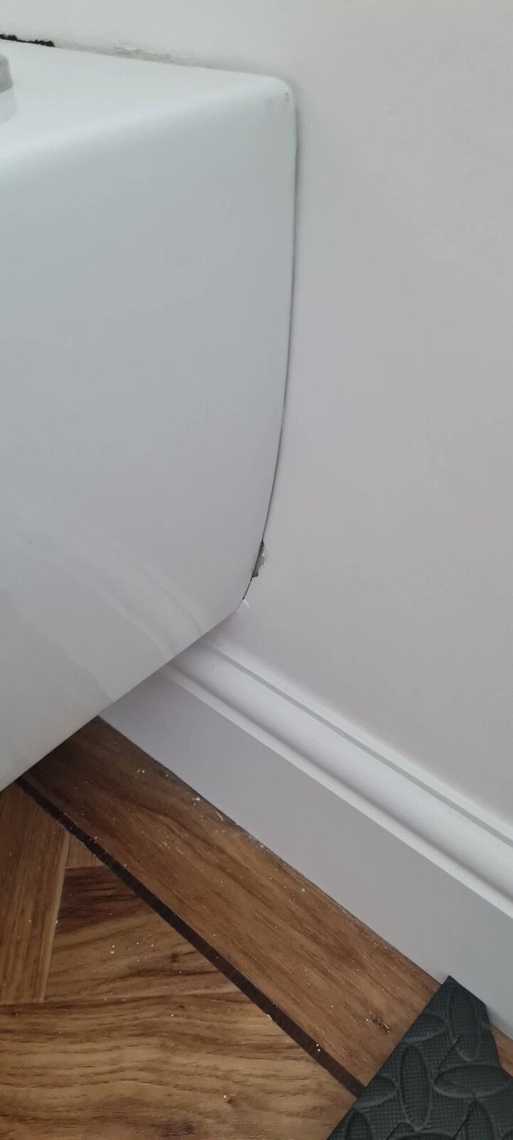

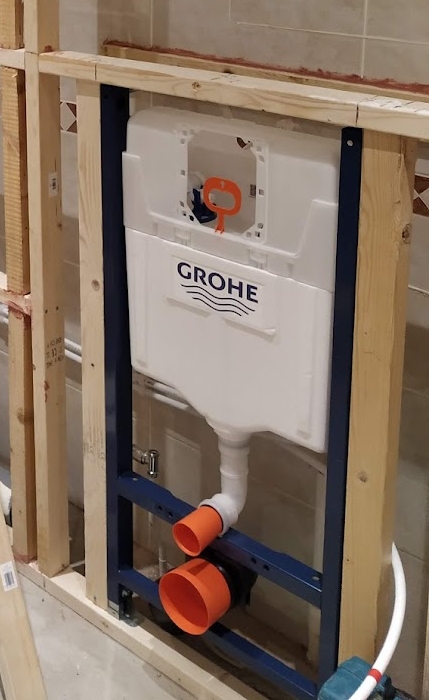

im now starting to think that the lower wall where the bottom of the toilet sits, needs to be braced and perhaps with the hole cut in the back wall its literally a a few cms of plasterboard that the bottom of the toilet sits
That will fail regardless of any fixings.
The lower edge pushes on the wall with the full weight of the pan and whoever is sitting on it.

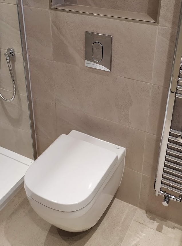

2x layers of cement board directly against the steel frame and tiles over would be a typical choice, covering most of the area behind the pan so just the pipes and fixing studs are visible.
Any forces on the pan go directly through the tiles and cement board onto the steel frame, so there can be no movement at all.
Frame, set in by the thickness of 1x cement board:
2 layers cement board over:
Finished:
If yours is just resting against a bit of plasterboard, that will need to be removed and replaced with something more substantial.
