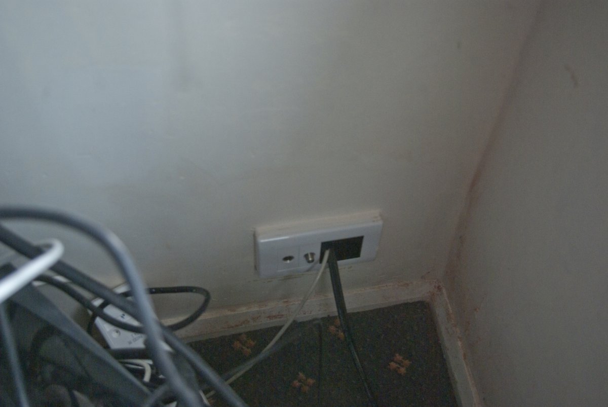

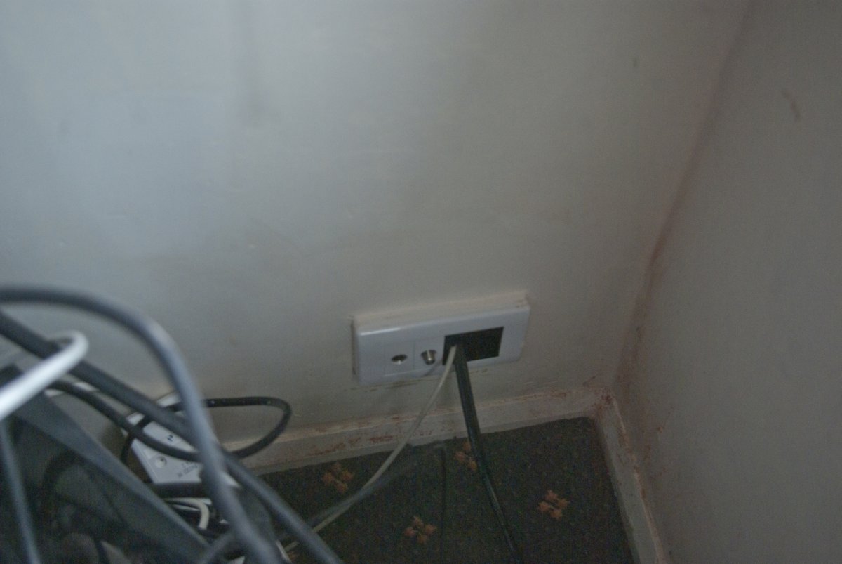

There will be power cable, co-ax, cat 6, two HDMI's and a sensor bar cable. I'll run the 2.5 separately to a single socket behind the TV, with the rest going to an adjacent brush plate outlet.
Bury it in the wall, going down under the floor, then across to the other wall where the worktop is. I've decided the bookcase is a no-go.

I am lucky in that we are decorating that room, so can go the whole hog and bury stuff in the wall.
I plan using a dual box: http://www.screwfix.com/p/appleby-galvanised-steel-dual-35mm/48234?kpid=48234&cm_mmc=Google-_-Product Listing Ads-_-Sales Tracking-_-sales tracking url&gclid=Cj0KEQiA5bvEBRCM6vypnc7QgMkBEiQAUZftQBHTODVbi-cm98UpTXYz8lIJA-k75ZBSOdOYGhNrHHEaAqW58P8HAQ with divider in place so there is segregation between LV and non-LV cables. One side will have a single socket, the other a brush plate like yours.
If I have so many non LV cables that they run outside the safe zones, I'll fit a box like this: https://www.tlc-direct.co.uk/Images/Products/size_3/AP540.JPG using the two gang for the non LV stuff.
