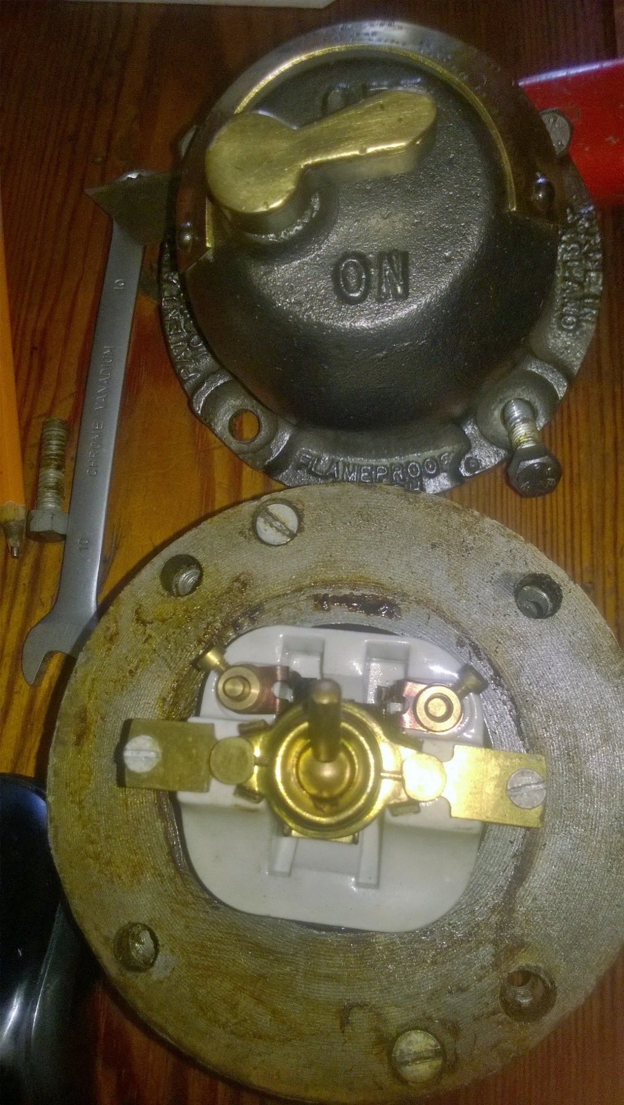

I have just bought an old Walsall one gang light switch. I want to replace one of the switches on a two way circuit with the Walsall. The wires for the Walsall are fitted thro the conduit behind the switch you can see in the photo, under the iron plate .
Would it be possible to replace the one way fitting with a two way and fit it to such an old switch although I cannot see any on sale. I am not an electrician so happy to pay one if needed.

Do you mean a two-way circuit - i.e. one light operated at two switches?
If so, the Wallsall is only one way so won't be suitable.
Also, it will require earthing - can't see a terminal for this.

Yes, Walsall and I think Crabtree did a two way version of that switch, they also did an intermediate switch. I think the castings in the photo were intended for flameproof use.
Is there no way of replacing the switch inside the casing with a two way. Looks as though it has been glued in so could probably be chipped out and replaced if it were possible to obtain a two way to replace it with. I have no idea It weighs about 3 kilos
Well - Harry says they did a two-way version, but I presume they are hard to obtain and no point buying one to alter yours.

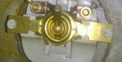

The switch obviously is held in with the two screws and the outside lever just moves the toggle.
I cannot tell the size of it but if you can find a similar two-way toggle switch then it could be modified.

EFLimpudence. Thats the information I want. I can now write to a few dealers and see if any if them have a two way toggle that could be used to modify the switch I have. I presume there is a standard size so any two way toggle should be able to be used in the Walsall I have. Thanks
EFL's suggestion is a good one, but you would have to devise some sort of bracket to support a modern switch in the enclosure and hope the 'swing' of the outer lever will work with your replacement. Be aware those screws will all be BA sizes, difficult to replace if any get lost.

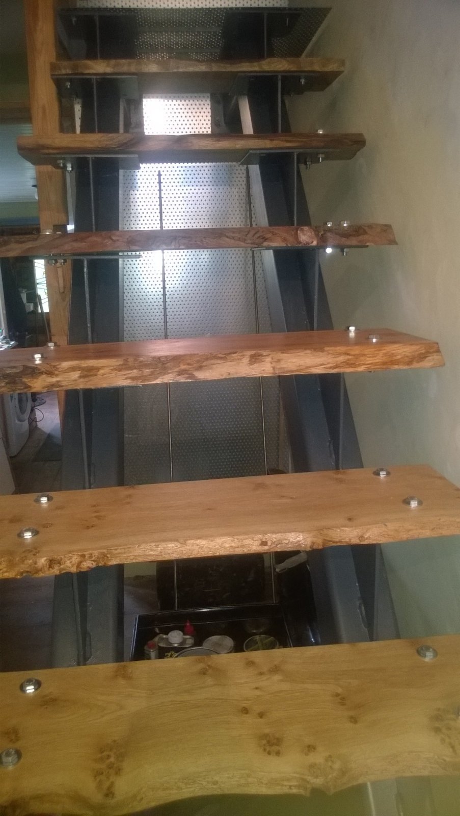

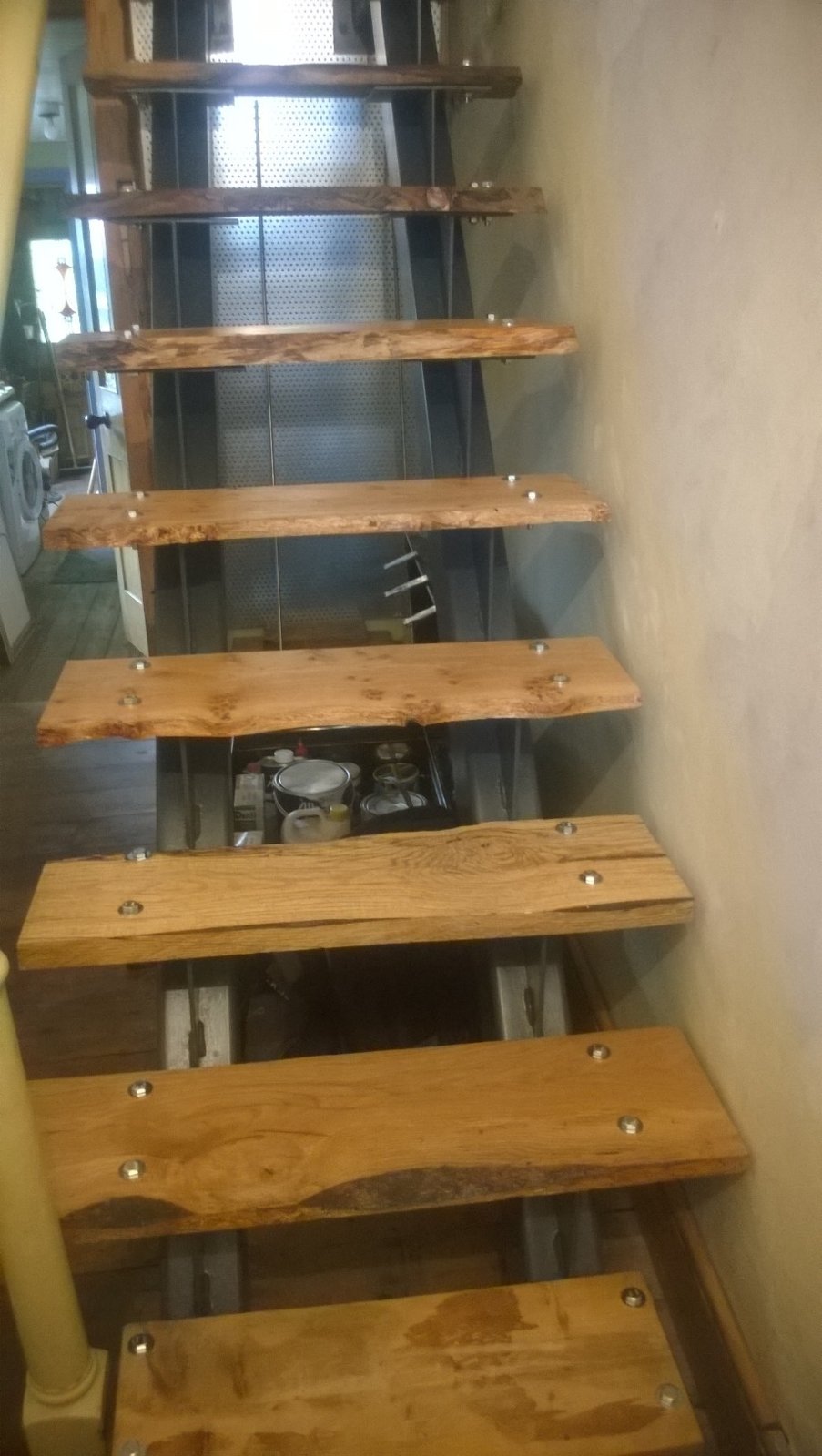

Purely for the look of them Harry. Big chunky piece of industrial heritage. Makes you feel like you are turning on the factory lights when you click one of these in the morning.
I also build book shelves out of galvinised steel and scaffold boards and am working on some stairs made out of steel stringers and off cut planks of wood which I have cleaned up and kept as natural as possible with the waney edge etc. The wooden balustrade will be replaced with stainless steel rods. Thats a sheet of perforated steel behind it I found it a skip and cut to fit.
