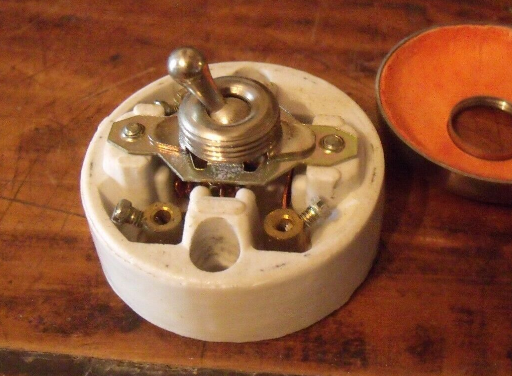

Walsall iron light switch
"there is the issue of earthing that metal"
Yes, that would work, but there is the issue of earthing that metal - they just didn't bother earthing the metalwork in those days :rolleyes:. I suspect, you might even be able to use that switch as a proper replacement, in your cast-iron enclosure.

In the bad old days, when your original switch was used in a wooden back box, the botch to earth the switch involved wrapping an earth wire under the head of one of the side fixing screws - the screws fixing it to the back box.
That 2 way switch on Ebay is a completely different style of switch. Rather than being fixed back through those metal lugs, the 2 way switch would have been surface fixed to a wooden pattress with a couple of wood screws through holes in the porcelain - so no obvious way to attach an earth to the metal.
My best suggestion would be to consider you might have to solder an earth lead somehow, then use a connector to connect it to your earth wire. Your ebay 2 way switch pre-dates my experience, so I cannot even remember what the look like under that metal dome cover.

Thanks, it should be possible to find a suitable surface to solder an earth wire to that. From memory, the switch frame/wings are fixed to the porcelain by a couple of screws coming up from the back of the porcelain, you can just make out the ends of the screws, in those wings. The screw heads were then sealed in place by some sort of very hard resin.

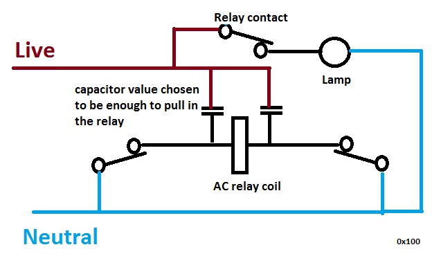

Indeed - and that would avoid any appreciable energy 'wastage' due to the relay coil being energised for appreciable periods of time. However, for a proportion of the time (depending on switch settings) current would be flowing through one or both of the capacitors, even if the light was not on - minimal energy usage, but perhaps not the nicest of situations.
... and, of course, you are introducing components (capacitors) which are quite likely to fail (potentially with a bang and a flash!) far earlier than switches or relays normally would.

I have just bought an old Walsall one gang light switch. I want to replace one of the switches on a two way circuit with the Walsall. The wires for the Walsall are fitted thro the conduit behind the switch you can see in the photo, under the iron plate .
Would it be possible to replace the one way fitting with a two way and fit it to such an old switch although I cannot see any on sale. I am not an electrician so happy to pay one if needed.

Oh Yeaaaahh they were used in intrisically safe locations, I think I want to say they were in a cast Iron or possibly diecast ali enclosure about 9x9x6" with a big red lens on the front, inside was a 80V 5W bulb (Very slim chance I may still have one) a 3000 type relay with huge contacts, 2 wacking great big waxed paper caps (4 to 5"x 1.5") and a terminal strip. There were also a couple or more resistors.
I want to say the name cast in the front was 'fielde'.
Every one I went in had a puddle of wax, a blown a cap and filled with the paper and ali dust.
