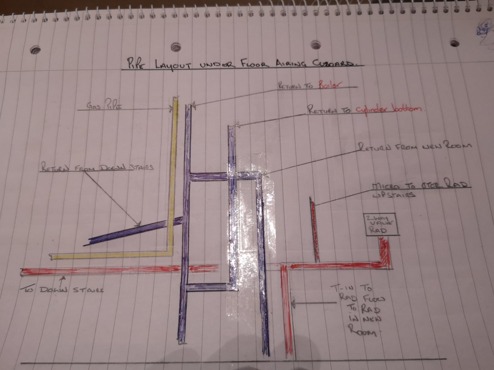

Hi all
Just had a radiator added to system since the radiators are warm. Would the position of the T in to current system have an effect have attached diagram of pipework. Advice would be welcome.
Were the red is missing sellotape over before adding colour
If I'm correct In saying the return on the new radiator has to be taken out and moved behind the T in for return to boiler and cylinder.
