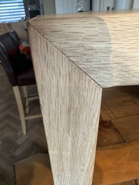

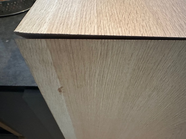

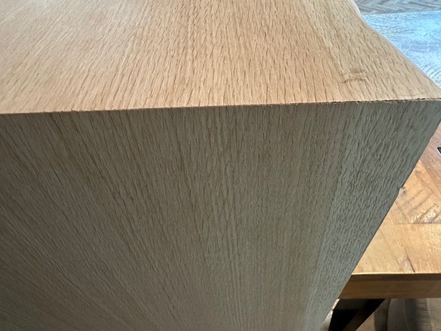

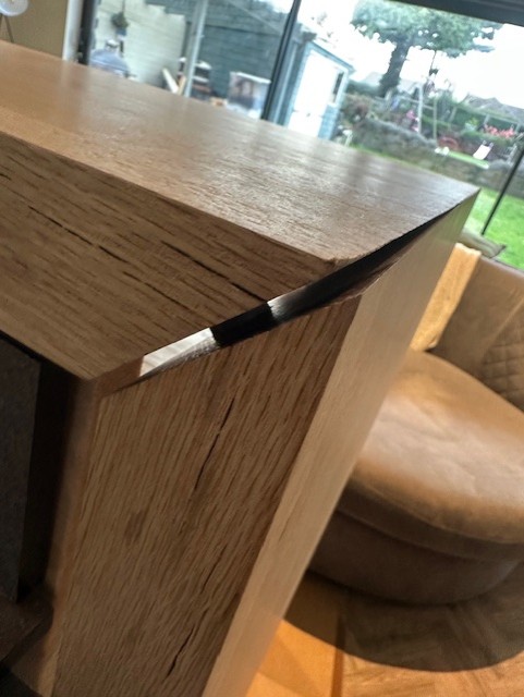

Hi, looking for help/advice on how to deal with some oak that has warped and is now impossible to get a good join, as shown in the photos. The first photo is how it looked in the workshop and the rest are how it looks now it's in my warm house.
Is there a way to get a nice join on this, now it has warped? Obviously want to avoid using screws if at all possible but have had no luck in finding a resolution, after having contacted a number of local joiners.

Ive not tried this but could you sash clamp the joint back together then instal hardwood bows at the 45 degree where it has pulled apart.
Maybe use Iroko or Maple for the bows, make it a feature, you could also reinforce the joint from underneath.
too ambitious a join for natural wood of such width - make a join where that movement won't be so noticeable.
