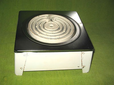

I do remember my mother did have one ring, and the wire would regularly fail, and we would get a new one from Woolworths, when it failed it would often touch bottom of pan making it live.
Eric, explain that 'wire' a little more, please?
I think that it must be very rare to see a domestic dryer or washer-dryer on a 'dedicated circuit'. I don't recall ever having seen that - have you?
Agreed I know mine is need centre of the ring final, so no problem, but the appendix is not a regulation although we were tested with questions from the appendix in the exam.
It looked like a spring, you connected on end then wound it around the porcelain former stretching it as you went, then connecting other end.
Seem to remember ours did have a wire guard over the heating wire, but clearly no earth connection as common to get a shock when the element failed.
I've never seen on like that, as a top ring, our rings were metal slabs, apart from the grill, which used bare wire. To rewire them, you didn't 'stretch as you went' - you measured the length with string, then stretched the element to match the string length, so it was nice and even once in it's slot.
