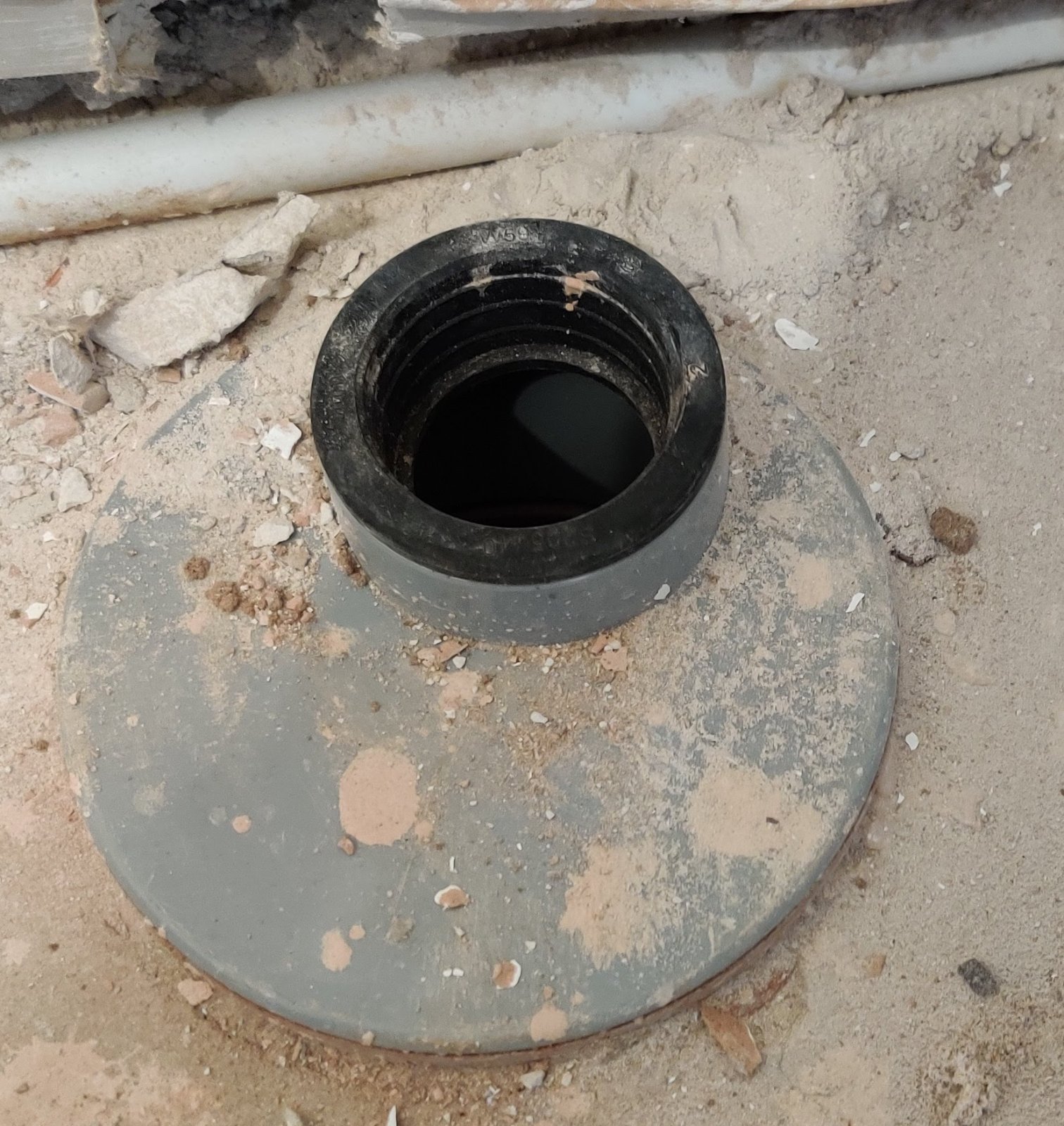

Hi all.
I'm hoping someone can advise me on how to plumb a washing machine into this floor waste that's fitted with a 40mm reducer.
I've only ever plumbed into a sink p-trap before and I'm struggling to figure out how to plumb it into this floor waste connection.
Thanks in advance for any help.
Fit a standpipe and trap,and from that pipework into the black boss ( reducer) in the floor.
Yes ,that standpipe/ trap from Screwfix is what you need . You would use a short length of 40mm waste pipe horizontally from the trap to an elbow ,and from the elbow another piece of pipe , vertically down into the boss.
