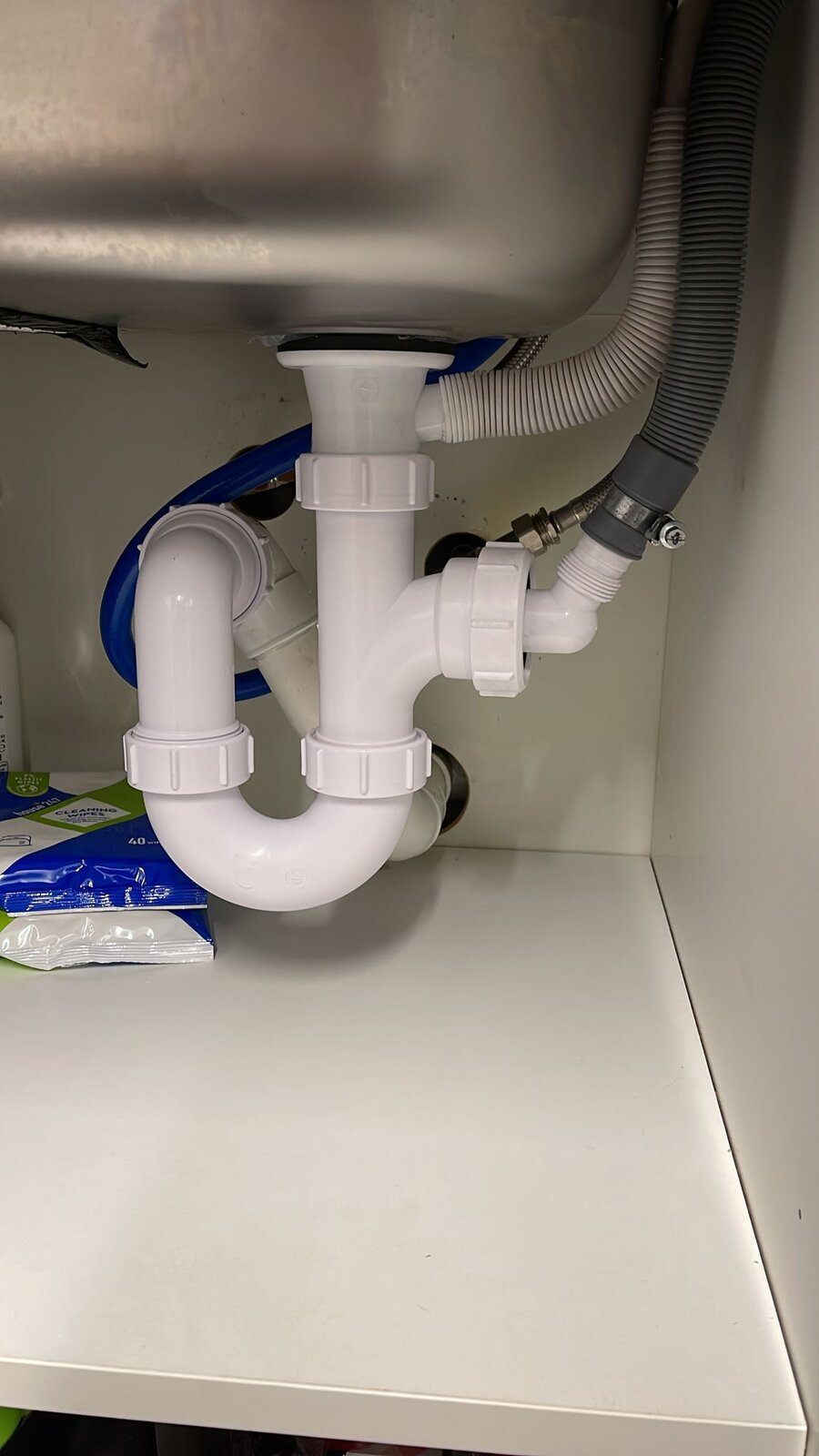

Hi, When the washing machine is draining the water seems to fill up into the sink then slowly goes back down. I have all already taken the trap apart and cleaned it out but still is happening. Can anyone assist in what’s the possible causes and solution for this type of issue please?
I’ve attached a picture of the trap.

Have you filled the kitchen sink to brimming, then pulled the plug and watched how long that takes to drain?
If same delay then you have a blockage downstream of the trap.
I'm just a DIY'er, so am probably talking absolute rubbish :)
But the exit of the trap looks to be above the height of the washing machine spigot - meaning it would be permanently 'underwater'.
If the sink were to pass the blockage test above, could the initial outflow of the machine start to back up the short distance into the sink, before flowing out through the trap?
OP, have you always had this issue, or has it only recently started?
It appears that you machine is plumbed in correct.
