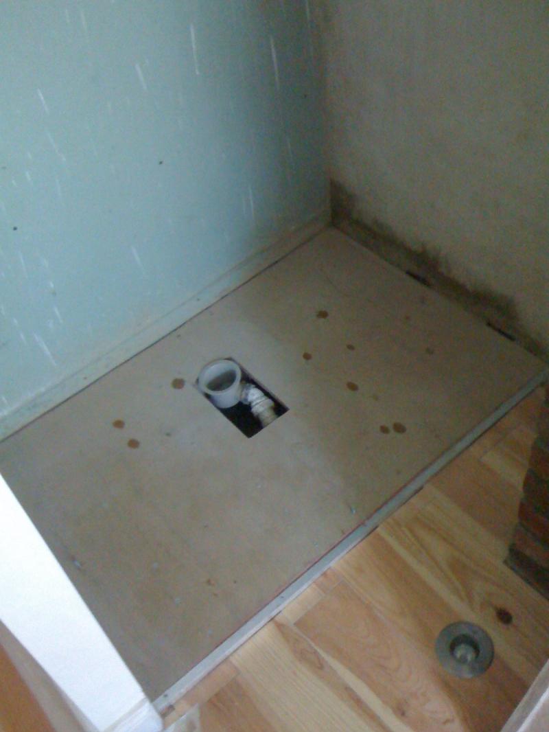

I've installed my bathroom waste, as per the diagram shown. It has a drop of about 8cm over 4m. The bath was in the same position prior to me altering the layout and it drained away ok. I have used 40mm solvent weld.
When draining the bath the water is draining, but it is coming through the shower waste and I'm getting a lot of gurgling going on in the sinks. Inititally it flowed ok, since then I did some tiling and stupidly used the bath to wash up in, and there has been a lot of tile adhesive left in the pipes. I have taken them apart this weekend and flushed and scraped most of the adhesive out of the inside of the pipes but I'm still getting the same problem.
I also wonder wether the 't' junction where the sink waste meets the bath waste is causing a problem with the water not flowing smoothly?
I also wonder wether to install a sanishower, if so where should I position it?
My only other option is to take the waste from the shower directly down through the living room (and box in) down the side of the fireplace and into the cellar where I already have a saniflow installed for the utility room. Any advice gratefully received.

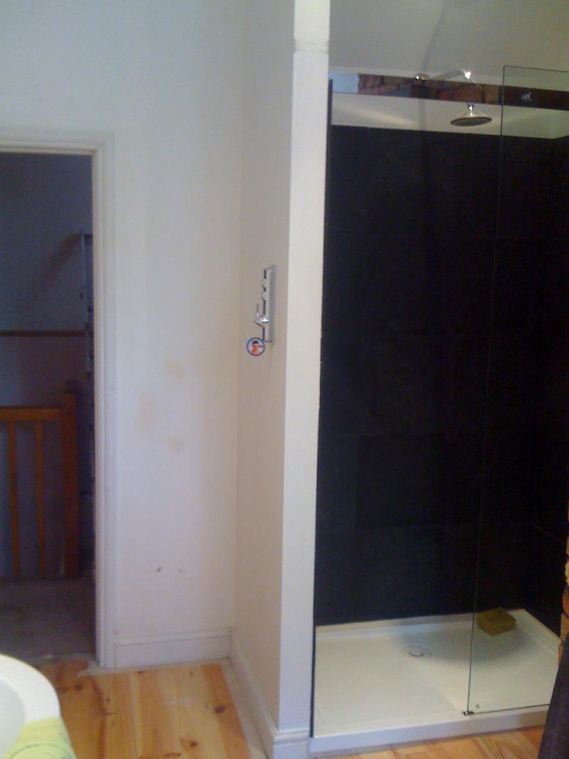

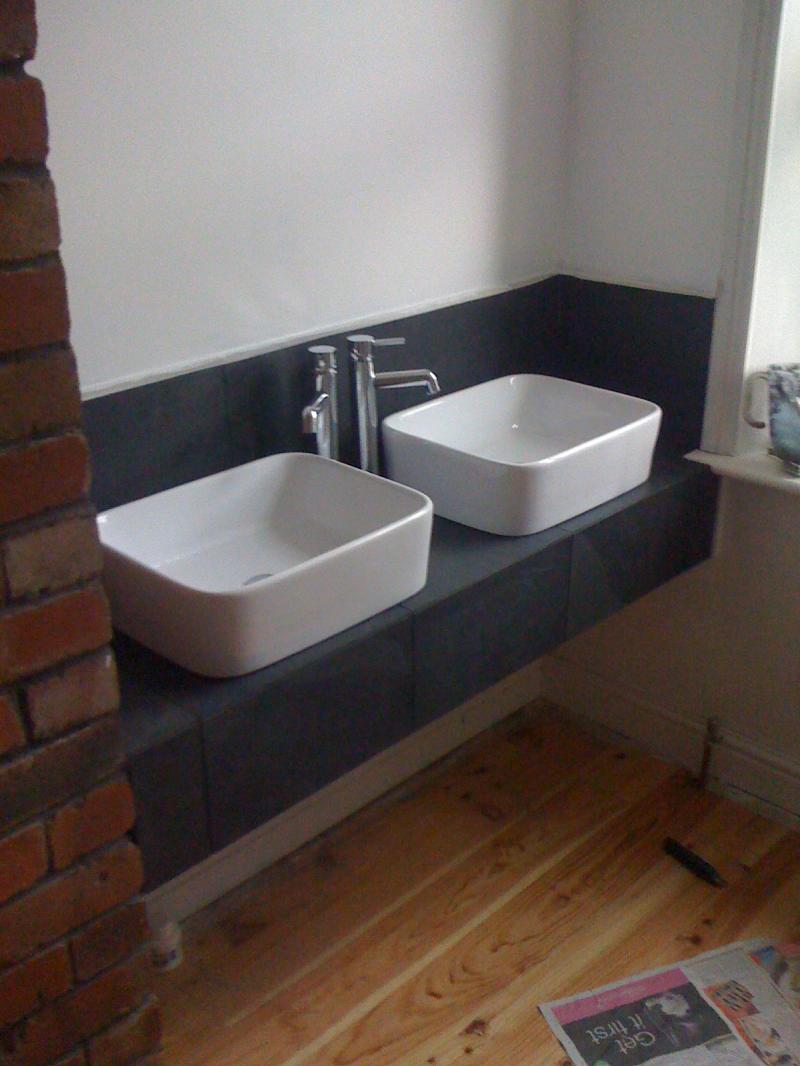

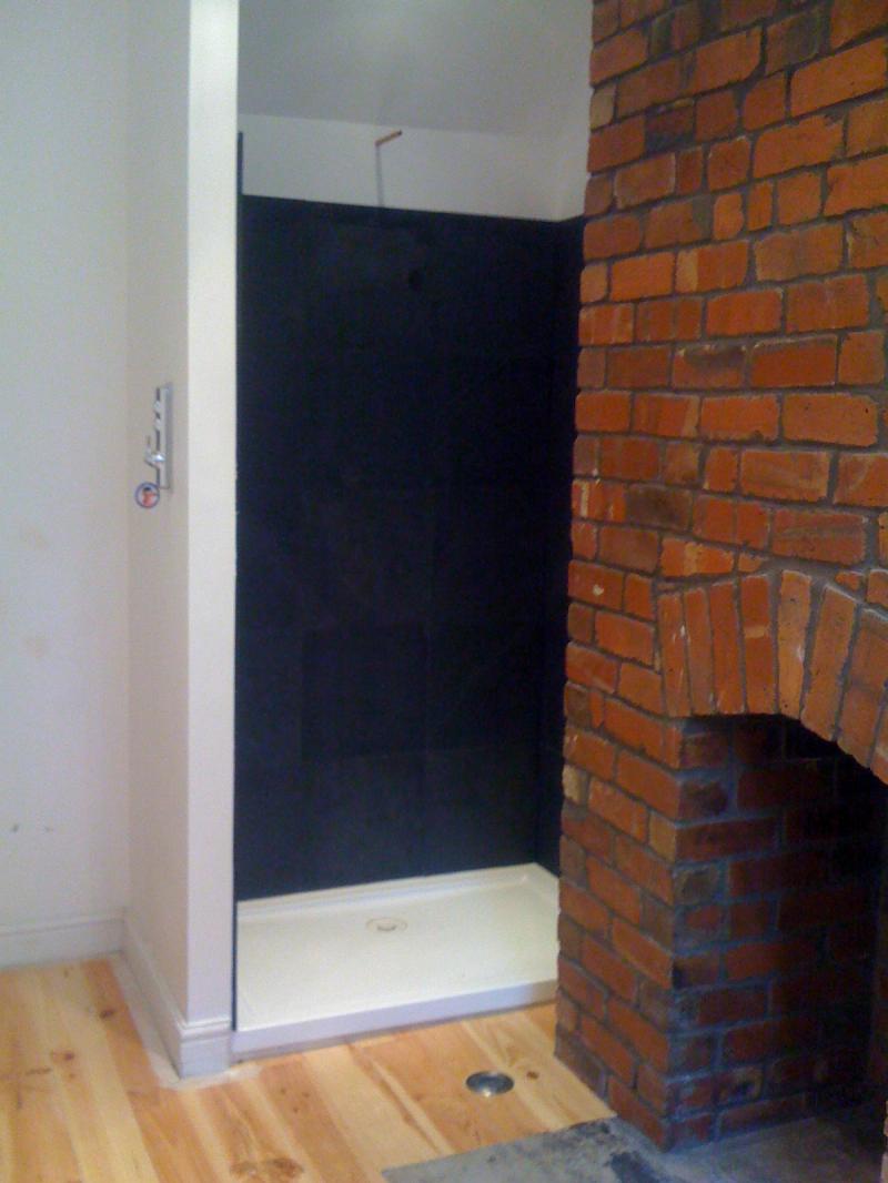

I've already got an anti vac trap on the bath but will get some for the sinks. I've attached a few pics of the project so far! Shower door was supplied wrong handed so that needs changing and refitting! Joy!!!
I didn't knock out the chimney breast as I'm keeping it as a feature! - some pics attached.

I've given the whole pipe run a good flushing with the hose pipe, and put a lot of bleach down there. So far the water is now flowing a lot easier and I'm hardly getting any coming back into the shower tray. When I put the cold hose down the shower trap though (as my shower door is not on yet I cannot run the shower) the shower tray fills up to almost the brim (it is only shallow) whilst it drains away. I have to take into account the fact that I'm still getting gurgling of the sinks as Ive not yet put the aav traps on (i assume this may help with siphoning), and the fact that the flow of cold water through the hose will be greater than hot water from the boiler.
If I am getting problems with it draining then which of the following options would you recommend:
1) Restricting flow of water to digital shower unit via a half turn of the valve
2) Increasing bore of waste to 50mm - involves a lot of work and taking more wood from joists which I don't want to do as I'm scared it will weaken them
3) Would a sanishower help?
1. Can't advise you on shower - could be dangerous advice. Shower is not the problem, it's the drainage.
2. Which way are your joists running? If drainage water is flooding the shower tray than you might consider calling in a plumber to consider a re-routing of the drainage. Given the difficulties that you've got yourself in so far you might end up with a collapsed ceiling and an onrush of gallons of hot, dirty, chemically contaminated water.
3. Do not put any more bleach or chemicals down the drainage, it will come back and bite you or someone else, typically a plumber.
4. If you do go for the 50mm then use solvent weld - never have compression in floors or walls.
5. Stay away from any Sani devices - you will only be storing up further trouble.
The original diagram has disappeared, trying to recall exactly what you had done. I have to echo what mnb has said, especially about the chemicals. If you start dismantling anything, use extreme caution. Anglian Water had a poster up at one of their sites, with a simple message. "Wear goggles. Your eyes cannot be replaced." :!:
You've notched the joists for the 40mm pipe, I'd be wary of taking any more out as you've said. Something isnt right, i'd expect a 40mm pipe to drain a shower without any drama, provided you're not trying to discharge a bathload at the same time.....
This issue seems to have manifested itself since you 'washed up' in the bath! As the pipes are somewhat clogged with tile adhesive, I doubt any chemical will remove it. I'd bite the bullet, and replace the pipes, otherwise you'll be leaving yourself wide open to further problems by giving plenty of points for hair and congealed soap to catch and further clog the pipes.... Whilst doing this, if it is possible to run a dedicated waste in tandem with the existing for either the bath or shower then I would do.
