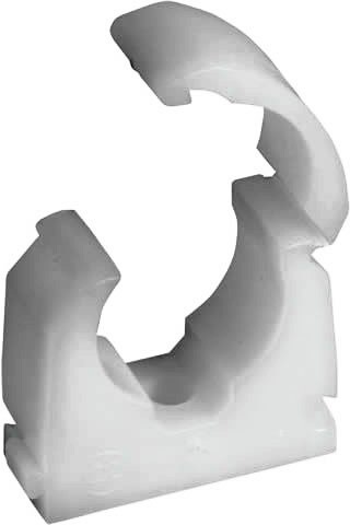

I live in a ground floor maisonette and the water is shared with upstairs the pipe runs in through my flat and then a pipe goes upstairs. It's very weird as my bathroom was originally connected to a supply that ran into a tank in upstairs loft but when getting work done we connected the bathroom to the mains. It's not an ideal set up and would prefer separate supplies and that's costly. I can leave the situation but not the banging!!! Everything a tap or the washing machine either mine or upstairs goes on it bangs and drives me nuts. When upstairs use there's is worse. We are in a high pressurue not sure if that makes a difference. Anyway how do I stop the banging??? And is it causing damage, will the pipes leak of I don't fix it. I don't think my neighbours are too bothered as it doesn't affect them. Any help and thoughts welcome! Thanks

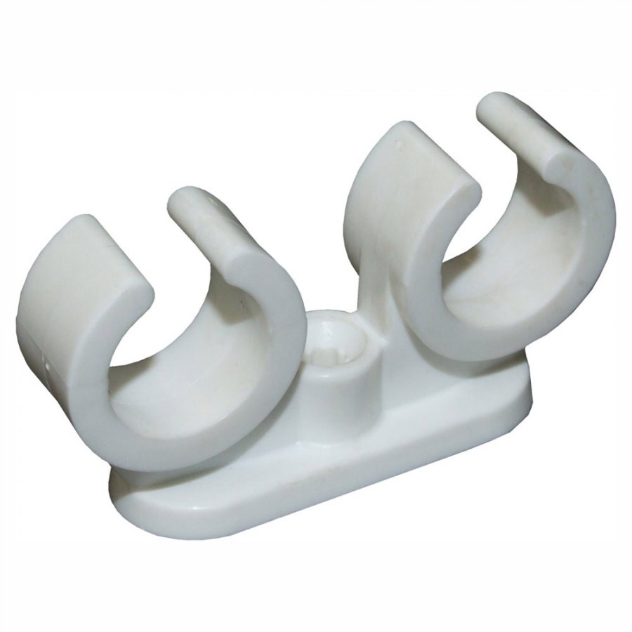

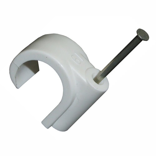

Water pipe where a significant length has not been secured during installation, will shake when water gushes through. First things first, have it 'nailed' or screwed' into the wall/floor.
These are just a few clip types you can get from your diy store.

Slight problem is under the floor and new floor just put in...
If turning down the pressure won't work, then try these? Easy to fit, but not a big job for your plumber either.
They'll be most likely 8x4' plyboards. :/
Last thing you want to do is to dismantle half the floor.
