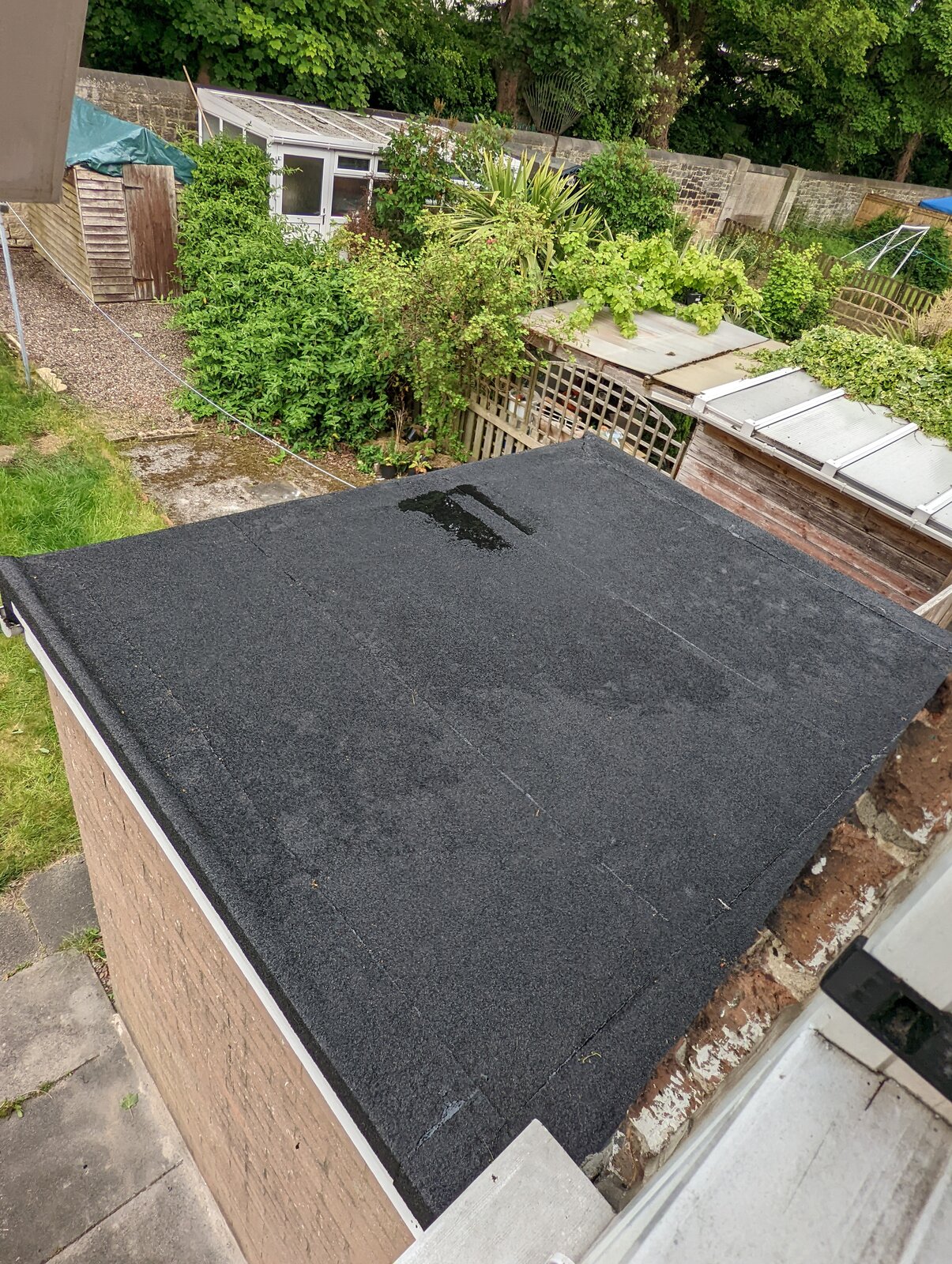

A newish roofing company (Dec 2019) in Newcastle has refelted an extension flat roof for me yesterday and says guaranteed for 10 years. There is water collecting in same place as before. Would like advice on if this is normal? And what paperwork I should ask for the guarantee?
Pic removed
Old roof had bubbling / blistering and water collecting in exactly the same area. I've had the house 10 months and surveyor had advised replacement. I got in touch with this company as they were doing other houses on my street. I asked for it to be converted to pitched and for review of additional insulation. They advised given current costs of timber just to replace the felt.
They've done:
-replaced some flat timbers? But not sure they checked the supports or insulation. I think they laid new over old??
- 3 layer replacement of felt. Their description: "should last 10+ years! We use commercial felt it's 3 layer system ( 1 liquid binder, 1 waterproofing, 1 cap sheet which gives you the finish)"
-offering 10 year guarantee though not sure what this is worth with a new company. The company is bd roofing in Newcastle incorporated Dec 2019.
Roofers were lovely but feeling some pressure from the company director to let this go because he has bills to pay. He said it is is normal for water to sit and collect before it drains into gutters.
Appreciate any advice. Thanks!

The roof in the pic is wrong. It needs stripping and replacing.
1. the felt has been laid in the wrong direction.
2. the edge drip piece has become a barrier to water draining from the roof into the gutter.
3. were you quoted for a warm roof or a cold roof?
4. the min fall from the abutment to the gutter should be 1:40 - I would make it steeper.
5. Who opened up the roof at the abutment? The beginnings of OSB wet rot can be seen.
6. the real reason for leaving out a pitched roof could be that they dont know how to do pitched roof work?
7. pitched roof is most always better than flat roof
8. Why not post a pic taken at the gutter end showing up-roof to the abutment?
No, its not fine - Good roofing practice, and the Regs, suggest that felt is laid horizontal cross the roof, working up to the abutment - this way water runs unobstructed across the seams not into them as can be the case if felt is laid vertical up the roof.

less than 10mm of water ponding near a seam? Of course it is normal. Unless of course you would like to see every drop of water fall off the roof along with a 45 degree fall. (y)

@datarebal ill try and get another picture today
@noseall thanks, where is information on what is normal for flat roofs available? I did lots of googling pre posting and found lots of scary things on ponding and nothing as reassuring as your message. Are we saying that above 10mm is bad? So if after light rain you have 10mm but more moderate rain you have 20mm that would be bad?
