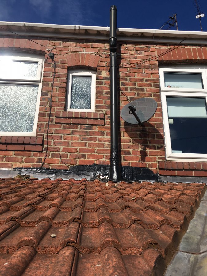

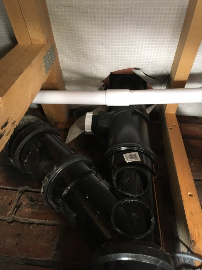

In pic 1.There's a white plastic pipe showing at the tile/soil pipe junction - presumably thats the WC overflow?
The upper part of the soil pipe appears to have been forced back towards the wall.
A couple of the boss connectors have presumably previously leaked - & have been codged back with solvent glue. Solvent has also been lathered about the installation.
Lower left a stub is entering a fitting at an angle.
There's a capped(?) stub in a connection at top left. Perhaps the original destination of the WC overflow pipe?
I cant see it clearly but the plastic soil branch connection to the Cast Iron(?) soil pipe bend seems to be an odd connection?
Above the tile - Bitumen has been used to presumably recover from leaking at the incorrectly installed flashing and pipe boot & disfigured felt opening.
From what I can make out, I'd say your trouble is more likely to be the flashing - with the WC overflow perhaps somehow contributing.
The tile and neatly cut valley excepted - the whole plastic S&VP job appears to be a rough DIY effort.
FWIW: it would be worth checking why the main roof discharge or the gutter is causing the smudging on the gutter.
