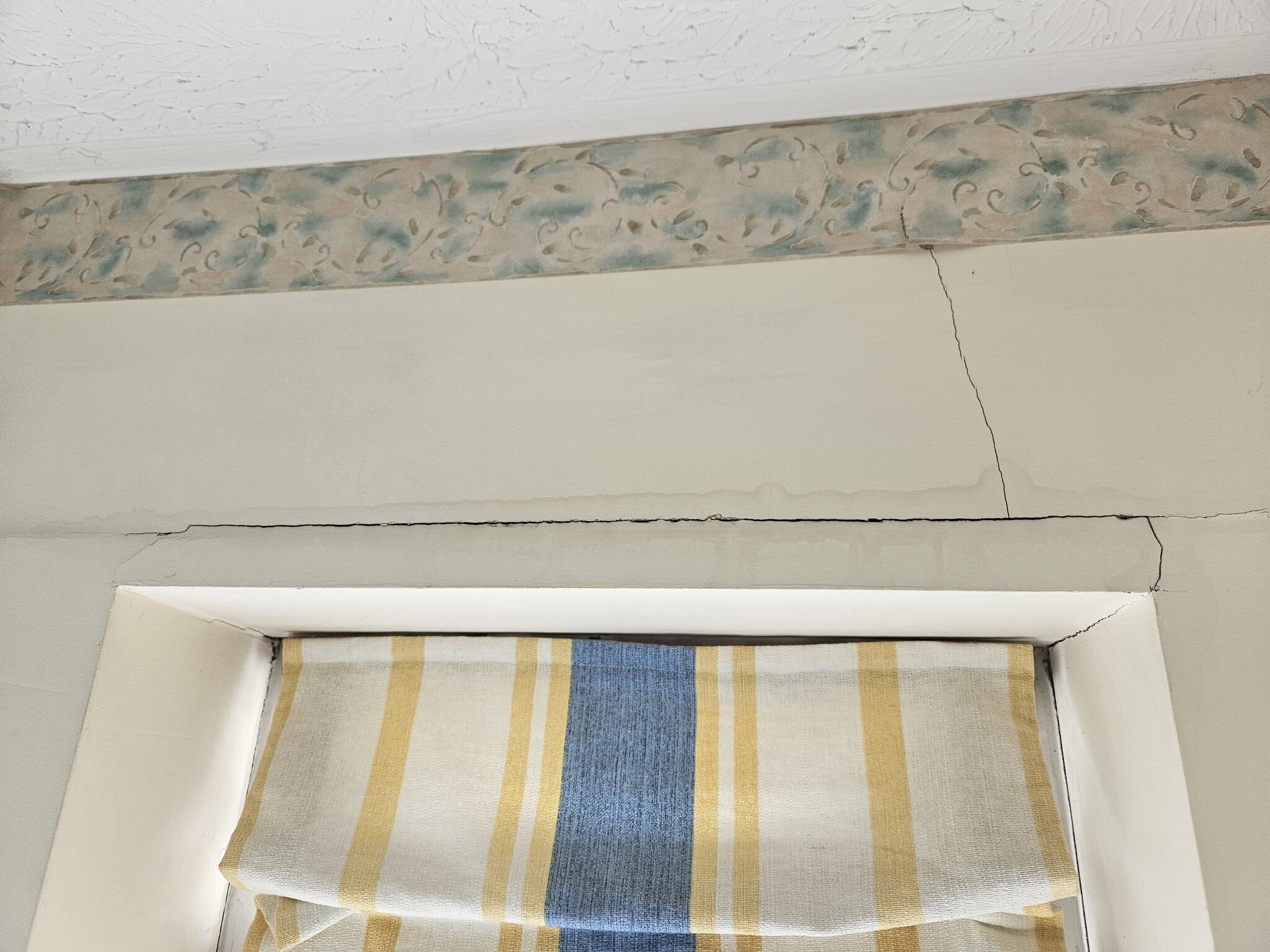

2002 modern townhouse, have noticed this in the 1st floor bathroom. Any ideas what could be causing it?
How do you know it is water ingress rather than condensatioin, which it looks like. Is the outside of the wall ok. Can you see any broken/missing roof slates/tiles above the area
If the outside is ok don't worry about it just fill and decorate and improve the heat and ventilation in the bathroom
Looks like the lintel is higher than the opening and the packing below the lintel has dropped from getting wet
Either water has travelled across below the lintel (sealant issue) or no, or poorly fitted cavity tray. above the lintel
