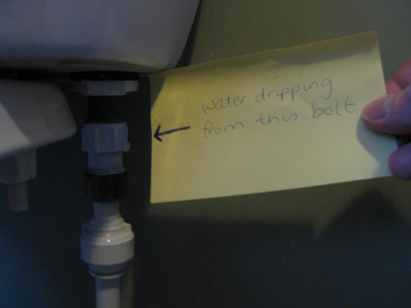

I've tried fitting a new fill valve today (fluidmaster) and everything went ok and I was nearly jumping for joy at this first ever attempt at DIY.
However, when I turned the water back on, the pipe started dripping! At first the drips came from the nut that flushes against the cistern (part of the fill valve nut) and I tighten that up.... then the water started dripping from another bolt connection lower in the pipe. I have also tried tightening that, but to no avail. It still drips. I have resorted to giving up and have turned off the water completely. I plan to fill the cistern each time I need to flush the loo.... for the time being.
Any tips anybody please?

So, do I have to change the washer that is currently INSIDE the white bolt (where arrow is on the post-it note)? That means I will have to dismantle the fill valve assembly once again right?......

I went to the hardware store today, with photos and was recommended to simply use the pfte sealant tape. I have now taped up the bolt like a mummy, but it is still dripping. It's no longer dripping from the white bolt (shown by post-it arrow in photo above), it's now dripping from where the valve shank protrudes out of the cistern. HELP!
have you checked its not leaking from the bolts on the close coupled kit? sometimes it can leak from there and trickle along the underside of the cistern and appear to be coming from the inlet assembly. the only other thing i can suggest is to dismanle the cistern again, the washer between the fill valve and cistern is not sealing properly, you need to clean all contacting surfaces to ensure they are free from debris, put a bit of ptfe on the threads and try assembling again.
Why are there 2 'bolts' (capnuts) between the valve tail and the pushfit connection?
What is the white threaded piece in the middle if the installation?
The dark thread of the tail of the valve, is it brass or black plastic, i.e. Fluidmaster's PRO range?
