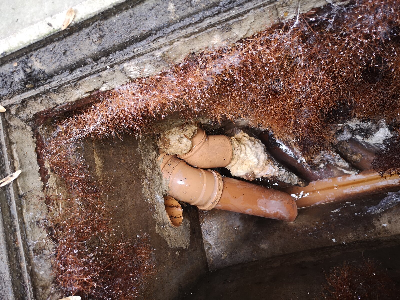

Sounds like a blockage, and one that’s siphoning some of the water out of the trap.
I'm not actually sure if we have a manhole.
Here's one I did earlier...
