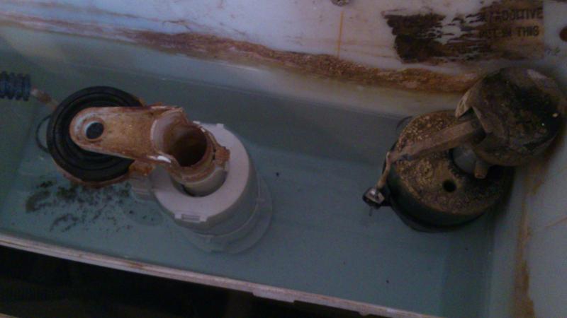

Water has been slowly leaking into this toilet bowl, but it seems to stop if I push down and fidget with the white cylinder after every flush. If I don't then the slow leak starts again.
Presumably something is not tight down there, but there's nothing that I can unscrew and I can't see how I can get it out. I don't seem to have a stop tap in my flat (checked kitchen sink, bathroom etc, there's one on the road but I'm not sure which tap it is as they are not labelled) so it'd be good to be able to fix this problem without having to stop water.
Thanks in advance!
Firstly let me tell you that I'm not a plumber.
However, I'd like to suggest that it need not be necessary to turn of the water supply; you can tie up the float valve to prevent water filling the cistern.
As for the leak, I'm afraid I know nothing about this particular system. On the other hand, I recently managed to remove the flush valve which, like yours, had a minor leak. I simply gave the rubber seal a wipe, replaced it, and the leak had been sorted.
I'm sure there'll be a real plumber along soon to offer some more professional advice.
Usually the flushing device is not seated properly or theres a bit of grit on the washer
That's exactly what I found with mine. Easily fixed at no cost.
I cleaned the washer and it helped a bit. But what happens now is there is still a slight leak via the top of the valve (rather than via the washer) but it goes away if I push down the valve a bit....
Is that because you think the syphon (I assume that's the flush valve) is broken and leaking? Is this normal?
Could it be anything else?
Thanks again

The original volume of leak is back again after I cleaned the washer, which seemed to minimise the leak without stopping it. I think the leak was coming from both the washer and somewhere above the washer nearer to the water level. If it's leaking from above the washer, is it likely that the mechanism is just broken (rather than loose) and I have to buy a new one? The leak does stop if I adjust/push down the valve (syphon?) after every flush.
Thanks again!
