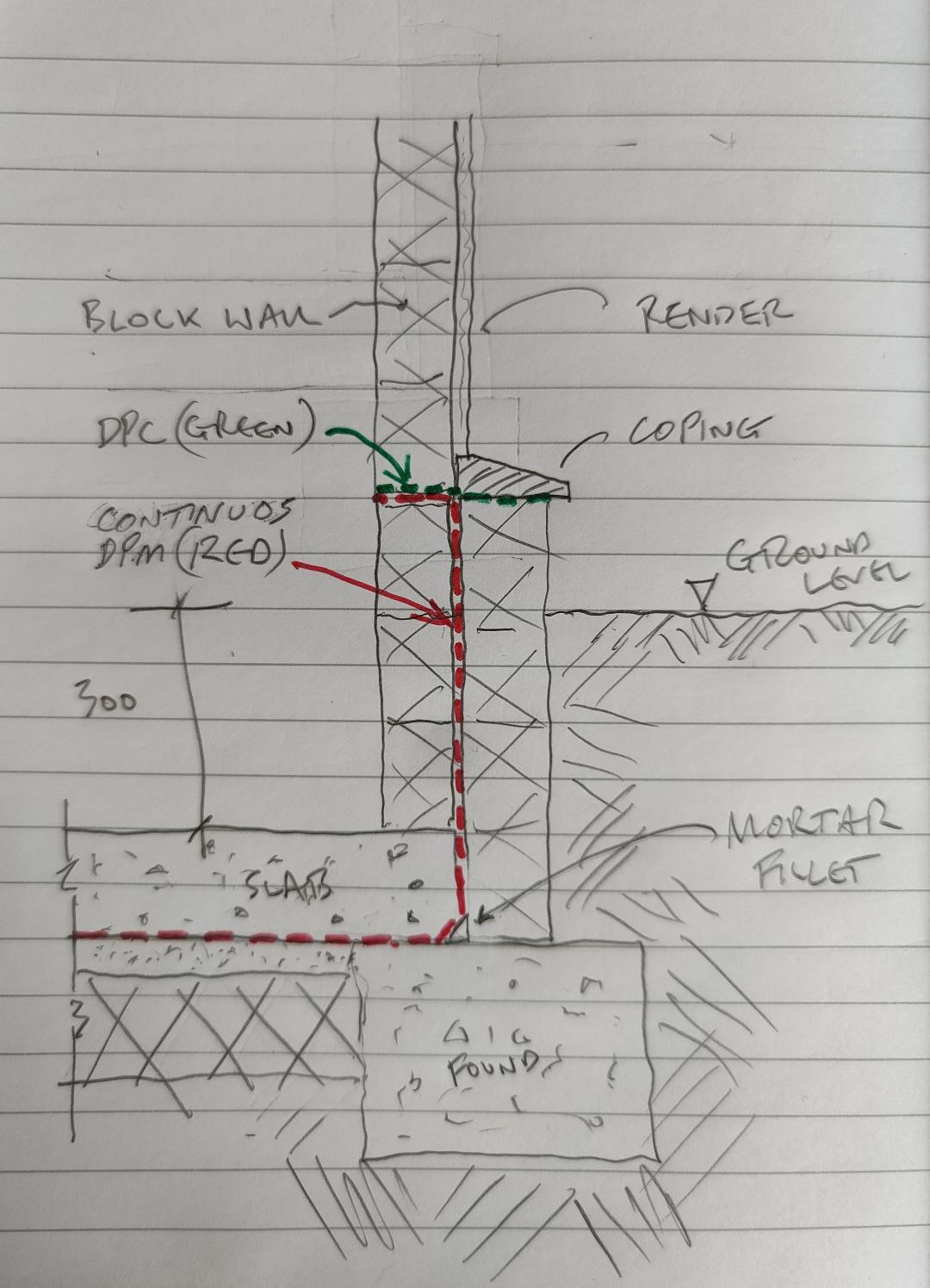

Yes that's exactly what I was thinking and actually knocked up a sketch showing that but there's still a slightly vulnerable bit (from rain ingress through the wall) bit where the render stops.
What I did do one one similar job which was effectively the same type of building (external store but adjoined to the rear of an extension, higher ground level) was to take the dpm back up the inside of the wall a bit, then protected it with a rigid board. A bit ad-hoc but BC were happy.
wow thanks for taking the time to put so much effort into your reply. Your diagram was my exact initial concept, however we want the patio doors to open flush with the wall on the outside, so the second skin will have to be on the inside.

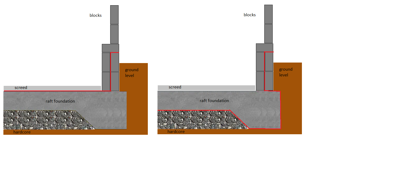

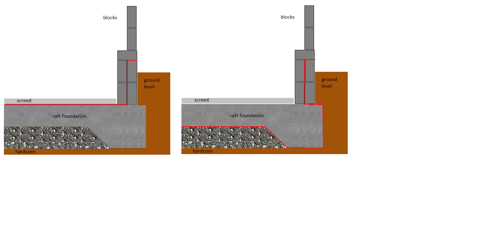

The building will be on a raft/slab/mat foundation.
Do you think either of the options in the attached image will work? DPM in red. I haven't included DPC for clarity.
The one on the left, between the foundation and the floor screed seems easier to do it if will work.

Obviously you have a step in the wall internally but if you're happy with that then either are fine, the left is certainly easier. The previously mentioned thoughts regarding the possible weak spot and the lack of a cavity remain.
Ive seen the step in many drawings but didnt realise it was for a purpose. Forgive my ignorance, but please could you tell me the purpose of the step?
