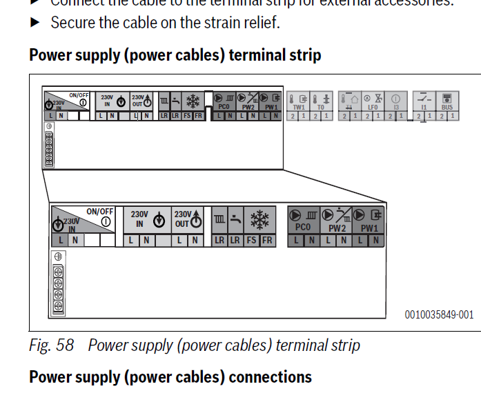

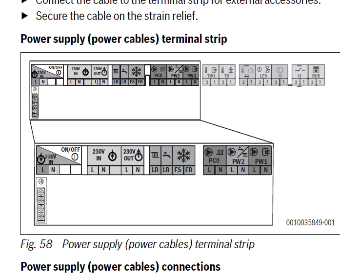

Hi, Hoping for some guidance on Worcester Wave to Worcester Bosch 8000 life.
I have removed the exising room thermostat as I want internet connected so bought a Wave.
Looking at the wiring any pre fitted links have been removed and when the existing EPH? wireless thermostat is removed there are no external wires to the boiler at all on the 230V side.
I have wired the Wave to the EMS bus but the Wave does not control the heating. The Wave also reatarts randomly. Apart from that it is showing green ticks to the boiler the wifi and the net.
Searching the net I found a screenshot online that showed a link between (230V out L) to (Lr CH). When I followed this and put a link in the central heating is just permanently on and the Wave has no control.
My question is where do the link or links go?
