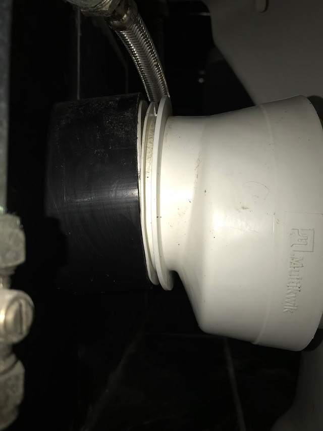

Hi,
My toilet has a leak from the (offset) waste connector but I've been told it's upside down. If that's right, I assume that the soil pipe will need to be moved down vertically so that it's either inline with the WC connector or below it - is that correct?
Thanks :)

Plinth under the pan?

OK - a plinth is very possible. The bathroom will need re-doing fairly soon anyway so I'm not worried about the plinth looking "less than ideal" as long as the loo works properly.

Don’t be too quick to judge the plumber... we are often left with the impossible - despite forewarning customers and requesting other trades to allow for what we need to make things work!
That's quite a steep angle on the soil pipe, so depending on the distance to the stack, you might be able to make it a bit shallower.
