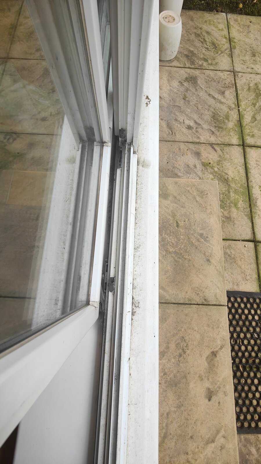

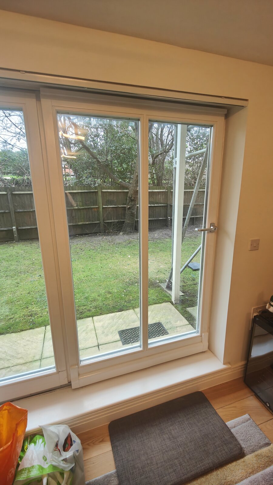

Hi
I live in a block of flats where they are building extra floors. I am ground and the extra 2 floors are going above the 3rd this has gone through planning, structural engineer etc.
I've raised an issue with my door as some of the doors on the higher floors have issue with compression due to the new weight.
The developers engineer came and looked and said he believes it was wear and tear rather than due to the building work.

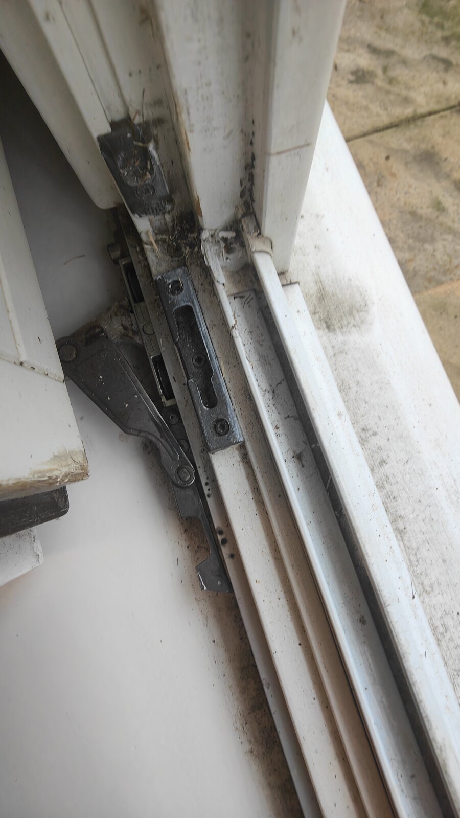

My door is stuck in place but when it's pulled out it will move along the runners (tilt and slide) without an issue but would have to be pushed into the frame. I've requested quotes for someone to take a look but they have said it's difficult to get parts for this type of door.
The frame doesn't looked warped but wondered is there a way I can tell and prove if it is related to the building work (I.e Would a level show parts of the frame is no longer level and could be due to movement of the building/compression etc).
If it's wear and tear and I need to fix it I will look at getting it replaced, but want to rule out it's not related to the work going on in the building.
Thanks in advance

Can't say you can prove it's the building work or not. In theory the lintel should be stopping any extra compression but that all depends on the type of lintel. You could put a level on it and look for any ' bowing ' or unevenness. If its unlevel then that will cause issues.
You say it gets stuck upon closing/opening...whereabouts is it binding?
Tilt and Slides are horrible things in my opinion and very few get fitted these days, and as you've already heard , getting parts for them can be a nightmare ( depends on hinge/lock manufacturer and age of door )

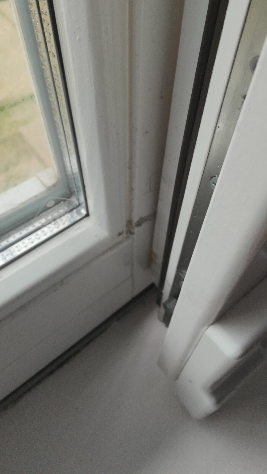

It's difficult to see where it's sticking, what's interesting is that it appears to be scraping on the side of the frame before it moves across to align to the frame. I have to push at the bottom left to move it across.
The material of the door is wood.
If I do replace this door does it need to be a fire door as I am ground floor. The lock is inside so it's not for entry but for exit. It exit out to the outside.

The door is wood rather than uPVC.
Being that you are having to push the bottom left to get it to locate probably it may just require adjustment . A good way to find out of the opening is ' square ' would be to measure the diagonals of the opening, they should be the same. Also measure width and heights at several points , trying to determine if its a frame issue or not
Could the wood be damp and slightly swollen?
Was it like this last year?
Oh. :rolleyes:
It's the opposite to timber, expands in cooler humid weather like autumn/winter. Can occur even after never doing so for years previously as the protective coating wears, or just due to a specific combination of time/temperature/humidity.
